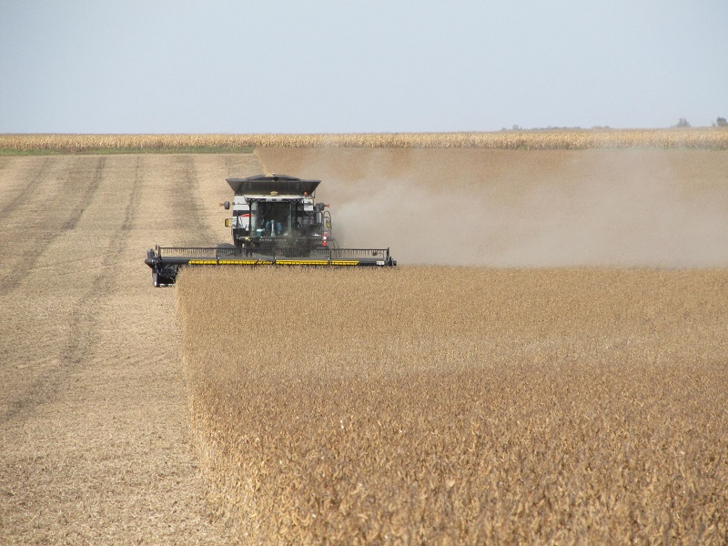

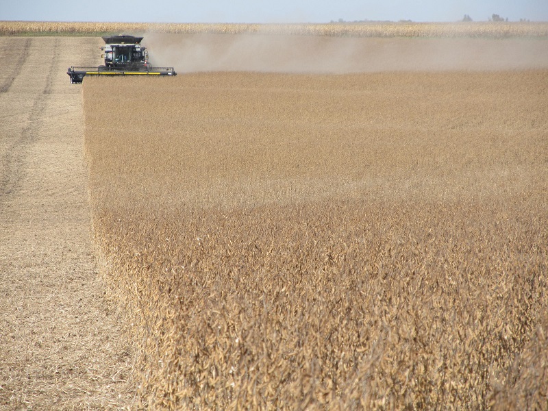

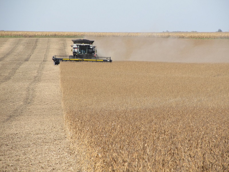

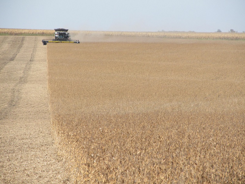

We had to disable the Smart Cool on the S78. Had the smallest of fire due to it. The fan still reverses, but now it is full forward or full reverse. To save power, the Smart Cool would adjust the fan pitch only as needed. This would allow dust and chaff to build up on the manifold and it doesn't take much to make a mess of your day.
With the left and right shields up and the unloading auger out, open the cover door on the auger to grease the U joint. Once the zert is in view, I painted a line straight down on the drive sprocket around on the right side. You can turn the entire unloading auger with your hand. It makes servicing easy. I don't think you could do that with any other brand.
The Oliver dealer in the town said they used to make fun on 2 cylinder tractors as they drove past. 2 sounded rough and the 6 cylinder in the 77's and 88's sounded so smooth. Get around the 7 cylinder engines in the S78, S88, S97, and the S98. 6 and 8 cylinder engines don't sound so smooth any more. The power of them is unexplainable. They create a smooth, steady, and angry roar.
The East West rotor in the Gleaner combine is the best kept secret farming. The green and red guys, even Agco doesn't fully know just how great a combine they have in a Gleaner cross rotor.
I do wish they would put a twist grip motorcycle throttle on the hydro handle. That would be cool. Add three more cylinder bars and bring back a rock door.
Edited by Unit3 - 14 Nov 2017 at 9:31am

Originally posted by Unit3 Unit3 wrote:
Thanks Unit3! I appreciate those. I really like the last one, and I will use it in my presentation.
