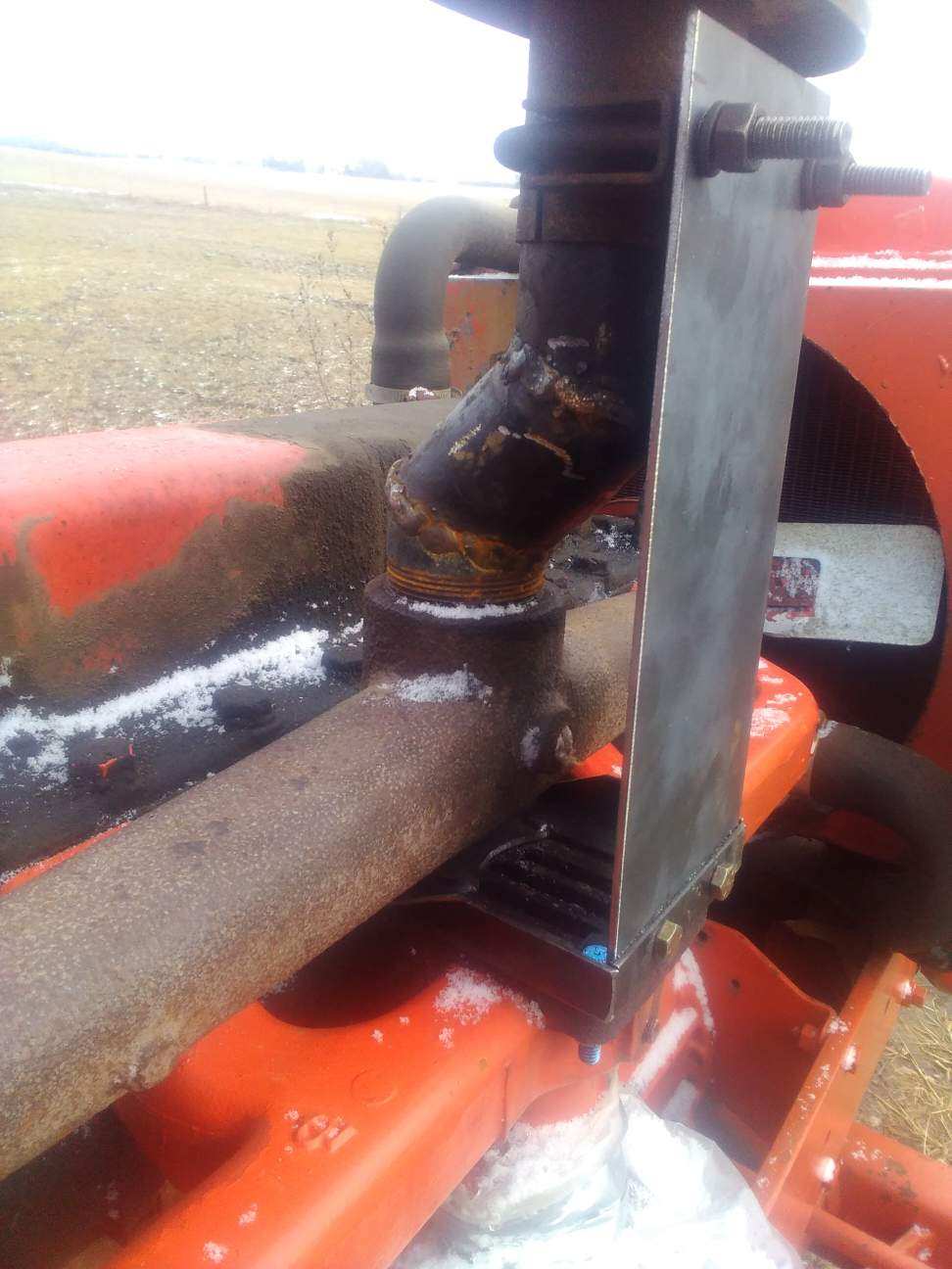

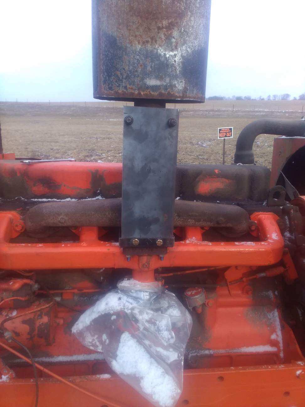

We have had a marvelous start to 2026 !!!  Who would have thought a diesel exhaust manifold from a 180-185-190 or Gleaner "F" would bolt right on a G-2500 or G-2800 cylinder head ?? Well, it certainly does and with about 2 minutes worth of grinding on each end mounting holes.  With every discovery like this, there is usually a downside. The one thing I will have to fabricate is the up-pipe from the diesel manifold to the muffler. The diesel pipe is 2 inches closer to the valve cover so the muffler either needs a new hole in the hood or an up-pipe with a jog in it. A very minor detail compared to fabbing up a whole complete exhaust manifold !!! There are tons of these diesel manifolds in salvage yards to be had.  I may have to fab up some sort of heat shield to warm up the intake manifold in the center. Probably not needed in summer temps but winter temps I can see why it might be needed. It will be bolt on and could be removed if desired.

FOR FARM USE- suggest a 1" channel laid on top of the intake - weld up the ends - and put a fitting in the exhaust probe hole and direct it down to the box via fitting. Probably gonna need some heat in the intake for efficiency and eliminate lean condition or allow a leaner mixture for general use.  (not that a gas XT would burn a lot of fuel anyway :-) )
I had mocked up a turbo manifold on a XT and mentioned it on here when I think it was Doc that said, and what are you going to do with it at 8 gallon per hour and gas was $4 at the time... I put back stock and sold the XT gas , I wasn't thinking - just playing.
Points: 22760
Post Options Post Options   Thanks (0) Thanks(0)   Quote DrAllis Quote  Post ReplyReply Direct Link To This Post Posted: 02 Jan 2026 at 6:18pm

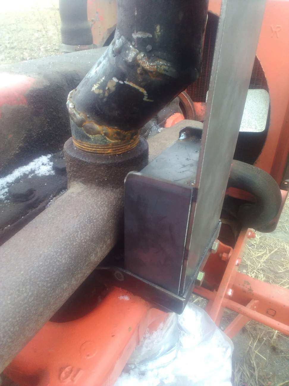

My plan is to build a simple steel box around that area that needs heat, secure it to the outside two existing intake manifold bolts and then going up as high as the pyrometer probe hole and then up to the muffler u-bolt clamp. This will help support the weight of the muffler and keep it from turning. But for now, the main goal of a solid not-cackling exhaust manifold has been achieved !!   Interesting how the 180 intake manifold throat looks like it has a NASCAR restrictor plate (4022853) slug pressed inside  it. The restrictor slug measures only 1.125" I.D. and the throttle plate bore on the Zenith carb measures 1.250".  This small throat isn't on the One-Ninety or XT gas tractors. So, besides slowing down rated speed to 2,000 RPM and a smaller carb, the restricted throat choked the HP down to 65 at the PTO.

DrAllis, that exhaust manifold looks excellent! Wonderful job! Maybe don’t lock-down/completely tighten your planned fab’d intake heat box to exhaust manifold &/or /muffler clamp? Let intake do most of supporting muffler? Do Attach it loosely to exhaust manifold but allow for it’s necessary freedom of movement for its heat cycles?
Points: 22760
Post Options Post Options   Thanks (0) Thanks(0)   Quote DrAllis Quote  Post ReplyReply Direct Link To This Post Posted: 03 Jan 2026 at 7:32am
When I get around to the intake manifold heating area, I will take some pics and post them. I'm still laughing about how the non-turbo diesel exhaust manifold bolts right on and fits !!

I built a hollow steel box around the warming pad area of the intake manifold to build heat from the exhaust components in that area. Included is a vertical support plate for the mufflers U-bolt clamp to connect to and help stabilize the muffler. If the heat build up isn't adequate (excessive frost at the intake manifold), I can direct a small amount of exhaust down from the 1/4 pipe thread pyrometer hole in the exhaust manifold. Once the hood is in place a good deal of this is covered up. I may just leave this tractor as a gasser now and focus on building a narrow front end for tractor rides.
