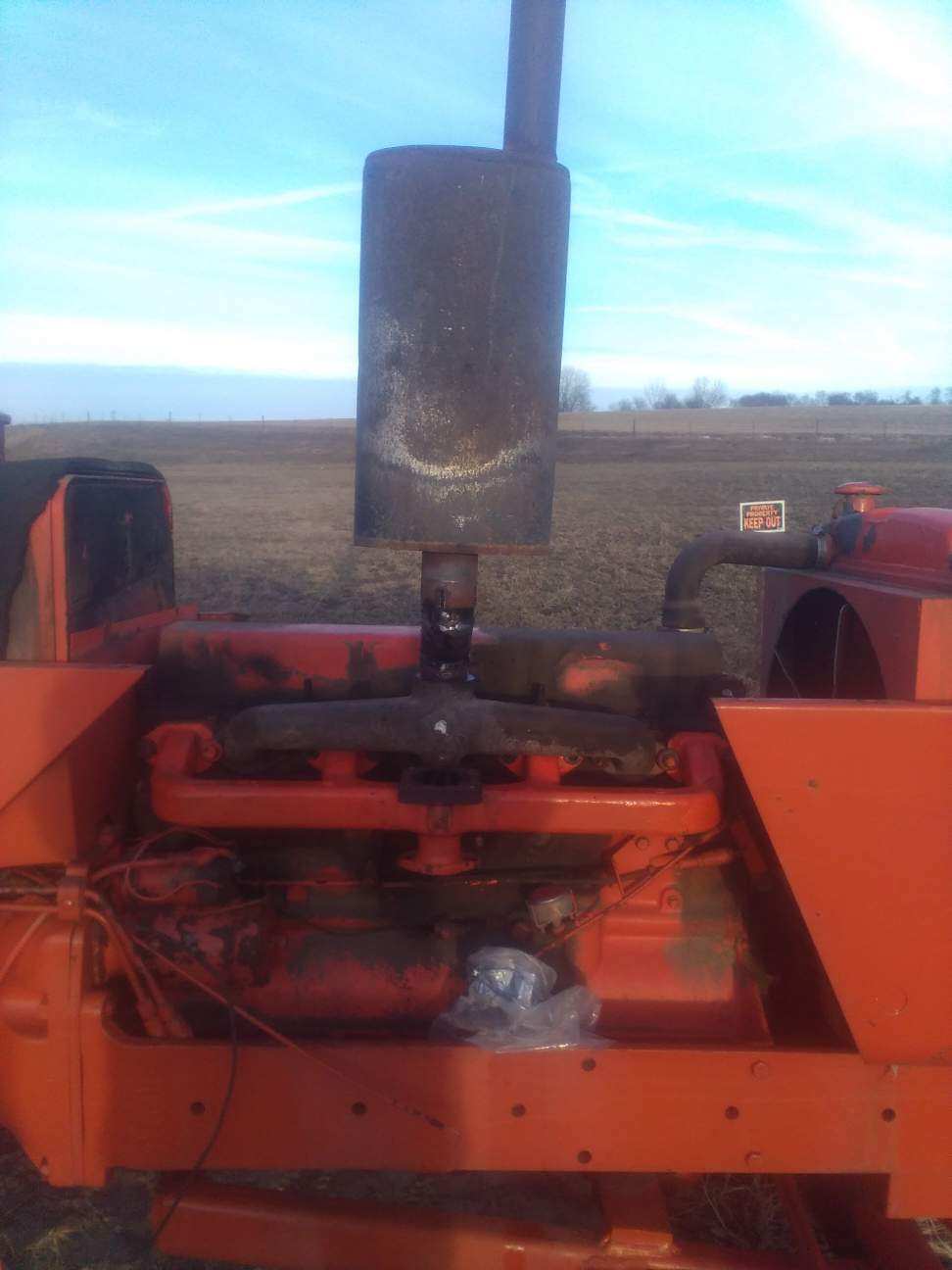

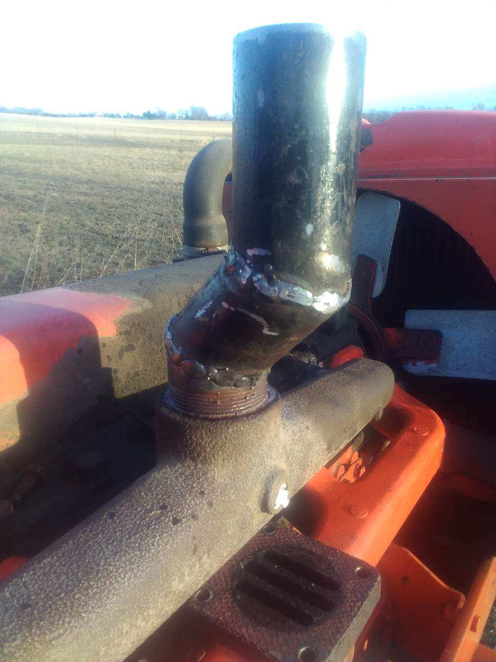

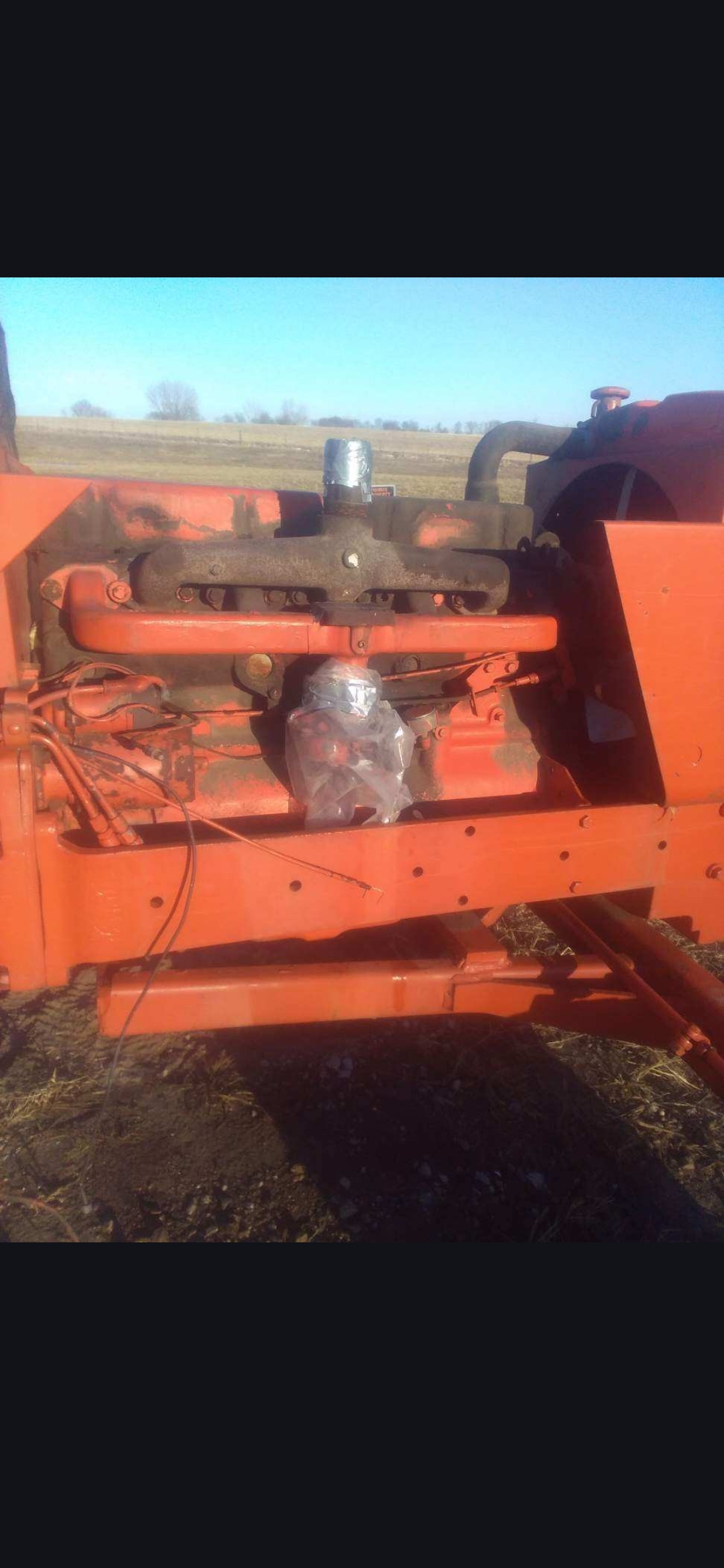

We have had a marvelous start to 2026 !!!  Who would have thought a diesel exhaust manifold from a 180-185-190 or Gleaner "F" would bolt right on a G-2500 or G-2800 cylinder head ?? Well, it certainly does and with about 2 minutes worth of grinding on each end mounting holes.  With every discovery like this, there is usually a downside. The one thing I will have to fabricate is the up-pipe from the diesel manifold to the muffler. The diesel pipe is 2 inches closer to the valve cover so the muffler either needs a new hole in the hood or an up-pipe with a jog in it. A very minor detail compared to fabbing up a whole complete exhaust manifold !!! There are tons of these diesel manifolds in salvage yards to be had.  I may have to fab up some sort of heat shield to warm up the intake manifold in the center. Probably not needed in summer temps but winter temps I can see why it might be needed. It will be bolt on and could be removed if desired.

My plan is to build a simple steel box around that area that needs heat, secure it to the outside two existing intake manifold bolts and then going up as high as the pyrometer probe hole and then up to the muffler u-bolt clamp. This will help support the weight of the muffler and keep it from turning. But for now, the main goal of a solid not-cackling exhaust manifold has been achieved !!   Interesting how the 180 intake manifold throat looks like it has a NASCAR restrictor plate (4022853) slug pressed inside  it. The restrictor slug measures only 1.125" I.D. and the throttle plate bore on the Zenith carb measures 1.250".  This small throat isn't on the One-Ninety or XT gas tractors. So, besides slowing down rated speed to 2,000 RPM and a smaller carb, the restricted throat choked the HP down to 65 at the PTO.

DrAllis, that exhaust manifold looks excellent! Wonderful job! Maybe don’t lock-down/completely tighten your planned fab’d intake heat box to exhaust manifold &/or /muffler clamp? Let intake do most of supporting muffler? Do Attach it loosely to exhaust manifold but allow for it’s necessary freedom of movement for its heat cycles?

When I get around to the intake manifold heating area, I will take some pics and post them. I'm still laughing about how the non-turbo diesel exhaust manifold bolts right on and fits !!
