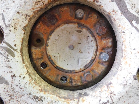

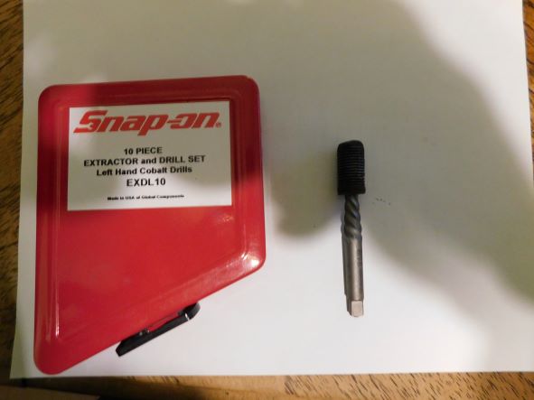

Got done feeding cows and happened to notice that 3 of the heads have popped off the wheel bolts. Checked the other side and one is off there. 6 marks on the bolt head so I guess they are grade 8. I have had this tractor for 30+ years and never had it do that before. I was lucky and got all 4 out with Snap-On left hand cobalt bits and easy outs

normally when the heads pop off, the bolts have been over torqued... what did it take to remove the remaining bolts ?

This is what I used. It's probably been 30 years since those bolts were out.

how TIGHT were the bolts that did not snap ?

from the rust patteran thre of those have been broke for a long time

Steve, I took a coulple of the good bolts out and they looked ok. I used ½ inch breaker bar and they came loose easy and did not seem overly torqued. Put 4 new ones in and put hay out today no more broke off
Dave, It must be shadow in photo as all but 1 was clean break and no rust. The one in the photo on upper left had a little rust

Steve, the wheel holes are not wallowed out which would indicate they were loose so I’m in agreement that they may have been over torqued when installed. They are over 50 years old
