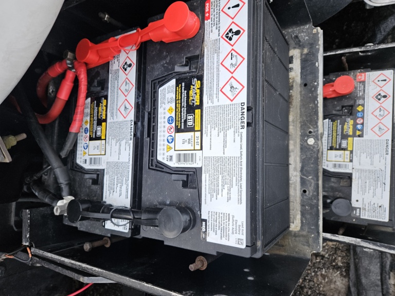

I kind of think it is a grounding issue myself.  The cold changing the grounds makes the most sense.  This truck started without issue 2 weeks ago.  The ground cable goes to the frame, and then from the frame to the starter.  Another ground cable goes from the frame to the engine.  I am going to take them loose and polish and then see what happens.
All of the batteries are matched to be the same, heavy duty bought from O'Reillys 31-5T, 900 CCA.  2 are brand new, one is 6 months old and the other is about 9 months old.  Top post with threads and all are very clean.  Nothing is really dirty and I have one new 2/0 molded battery cable.  All appear to hold charge after setting at around 12.7 volts so I don't think it is a battery issue.  I also put the 200 Amp Boost on the set of batteries when trying to start and measured 14 .4 volts at the starter positive and negative posts.

This is a GMC General with a replaced engine, 1987 Cummins 855 Big Cam IV.  I believe. This is near the end of their manufacture so I think that makes it a newer N14.  This engine appears to be a new crate engine as it was not taken out of another truck after researching it's serial number.   This is the first time I have tried to start it in the winter even though I have owned for 2 years now.  Last year I didn't move it in the winter
I did set the meter to ohms and when I checked from the starter stud to one of the battery posts it showed .33 on resistance.  When I checked from one battery to the next it was 0.  I am guessing this is the problem?
Hopefully I did these tests correctly.  My first voltage test on Negative when using my multimeter connected to the starter motor ground stud and one of the battery terminal negative posts went from 0 to 2.78-3.1 volts.  The Positive test from starter motor positive to a battery positive did about the same thing.  Went from 0 to 2.6-3.1 volts.  The reason i say there is a range is because as I held the wire the range first started at 2.78 and then as it turned the motor, it went higher and stayed there until I released the wire.  The test from positive starter  to negative battery went from 12.56 volts to about 8.5 and then to 7 volts.
I put my battery charger on 40A boost and the Volts were up to 13.7 but then they went down to 10.3.  Same voltage drop.
I thought it was normal to have a 3 volt drop when you try to start?  That's what I see from my all of tests except for one.
Would it make sense to place the battery charger clamps directly on the starter motor positive and negative studs as a temporary test?
I don't have a helper so I screwed a wire on the S terminal on top of the starter solenoid and then touched it to a positive terminal to mimic the key turning.
I did run an old tractor battery wire that I had laying around to the ground stud on the battery starter to the battery ground.  It did not help.  I don't have a set of large 2/0 spare wires to bypass the existing ground and positive cables.  I should have those tomorrow.
There is a test that is showing me a problem though I believe.  When I place the multimeter probe on the negative starter post and the positive starter post and then try to start, the Voltage goes from 12.7 Volts to 1.8-2.1 volts.  That is a 10 volt drop.  That would seem to be too large of a drop?  Not like the 3 volts that I see when testing from the starter to the battery terminal.  Since the batteries aren't dropping that far, it makes me think there is still a bad cable or ground in this mix.
I still don't see having bad batteries.  Bad cables, bad ground and a massive load still remain.  Tomorrow hopefully I can get some bypass cables and hook them from the battery to the starter and eliminate existing cables as the problem.
Appreciate any feedback!

You are making progress now! Smile
Yes, that indicates a problem as it really should be Zero. It is, however, difficult to get really accurate ohm readings on large cables with ordinary meters, which is why I constantly recommend the voltage drop test as it tests under dynamic conditions.
That is way too much voltage drop. The cables themselves or any and all of the individual contact places in the circuit are causing excessive resistance resulting in less energy available at the starter.
This test is inconclusive as it doesn't isolate the problem; you have half of the cables and all of the battery pack in the circuit. It doesn't look good though.
I thought it was normal to have a 3 volt drop when you try to start?...
It is, except you are adding an external influence with the booster. Once again, inconclusive.
Yes.
That will give you the most benefit of the booster because it will bypass the high resistance you have proven is in your cable.
....  I don't have a set of large 2/0 spare wires to bypass the existing ground and positive cables.  I should have those tomorrow.
Good. You are on the right track.
There is a test that is showing me a problem though I believe.  When I place the multimeter probe on the negative starter post and the positive starter post and then try to start, the Voltage goes from 12.7 Volts to 1.8-2.1 volts.  That is a 10 volt drop.  That would seem to be too large of a drop? ...
Yup.
The internal resistance of a starter motor is quite low at zero RPM. Put your ohmmeter on it and see. Without getting into electric motor theory, let's just say that some magic happens as the starter speeds up during cranking and the current draw goes down. Starters are typically rated for maximum current draw at locked rotor.
Since your cables have demonstrated an excessive voltage drop, indicating an inability to deliver current, the measured voltage directly across the the starter will plummet because the battery/cable combination cannot keep up with the demand.

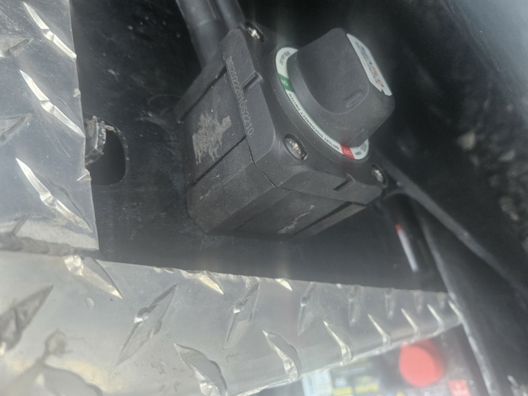

Happy to report I have my semi engine turning over now!  I like to document the full steps to fix for others to enjoy.
I ended up replacing every battery cable, negative and positive.  I also bought these nifty molded battery cables for connecting two batteries and got rid of the short cables.  I also installed a cutout switch for future winter storage.  I had to wait 2 weeks to acquire all of my parts before I could finish this so that's why I couldn't report back.  I also wanted to point out that I had plugged in my block heater for 2 hours before I turned over the engine.  Engine was about 75 degrees when I did the turnover test.  I did not start it because I have some more smaller ground wires to repair, they don't look good and I have to get some other connectors to finish it.  I also have some tidying up to do of the new wires and anchor them.
I did route the ground cables differently.  I think it should be better.  The old setup went from the negative battery post to the frame, then from the frame to the starter and from the frame to the engine.  I changed it and went from the negative battery directly to the starter, then from the starter to the frame, then from the frame to the engine ground.  I thought this insured a better ground connection directly to the starter.  I also have the ground wires touching each other.  The old setup had a wire going to the frame on one bolt hole and another completely different bolt hole for another ground wire meaning the two ground wires were not actually touching each other.  Paint and/or rust could have reduced that style of connection.
The cutout switch is a heavy 300 Amp continuous and 900 AMP pulse rating.  It is really made for big boats.  I had to cut a little plastic off of it to fit the 2/0 wires inside.  There is a lot of rigged up wire jobs on this semi which is why I got the cutout switch.
I haven't analyzed the battery cables closely to see if I can figure out which one was really bad.  Of course, it could have been the connectors and not the cables.
I bought a hydraulic crimping tool and bought my own 2/0 wires so I could make the wires to the exact length.  It was cheaper than buying all of the cables to length.

Here are those overmolded connectors that cost about $25 each.  They are nice as they have a 3rd post to connect other wires.  They fit perfect when the batteries are side by side.
Here is the cutout switch that cuts out the negative cable.  You can see them enter on the right side.
