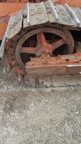

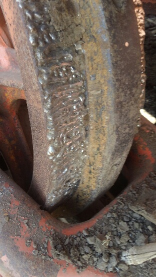

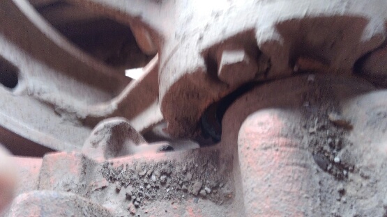

Just noticed this and will need parts or numbers and best places to look for these items. Going to post from phone if I can. 1957 allis HD11 .Also need to know where to get get pin for connecting tracks.

I'll have to repost pics from computer. These are better size of pics. I really need newer rails too.

Get the picture smaller, and let me know what you are needing. I have 7G Donor parts machine where I believe these parts interchange to HD11.

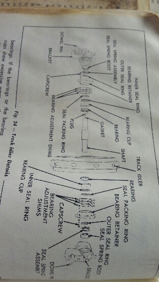

 The  HD11 -HD9 use the same idler,track,roller,sprocket and am't sure if am still have some idler parts and you better removed your idler and check if you can reinstaled bearing and seal with out machined .

I really think I am going to need the whole idler. Do you have one? I need to check with a couple of other salvage yards that are closer me. There is one in Idaho that has quite a lot of parts for these machines on line. Only know of two closer at this time and will call them the first of the week.  Where can I get master pins for the tracks.  Should I check with Minn Par?

Get it off the machine and see if it can be rebuilt - IF the bearing area is not worn -

Get it off the machine and check to see if it is rebuildable... like others have stated...
  You might luck out and find the bearing races not chew through yet into the idler housing metal.  and you can have a machine shop cut hub for new seal if it is worn there to bad...
  After inspecting and finding out the facts then proceed in which ever direction it takes you ... looking for new bearings and seals or looking for another idler.
