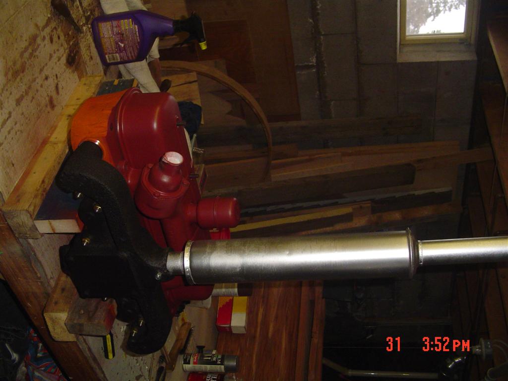

The head is painted and valves are assembled in the head.  valve cover is cleaned up and primed, muffler is painted (so it looks good for a while, LOL!)
manifold is back on head and things are ready to go back on the block.

Yah!  Pics worked today, I'll post some more...
The radiator before
