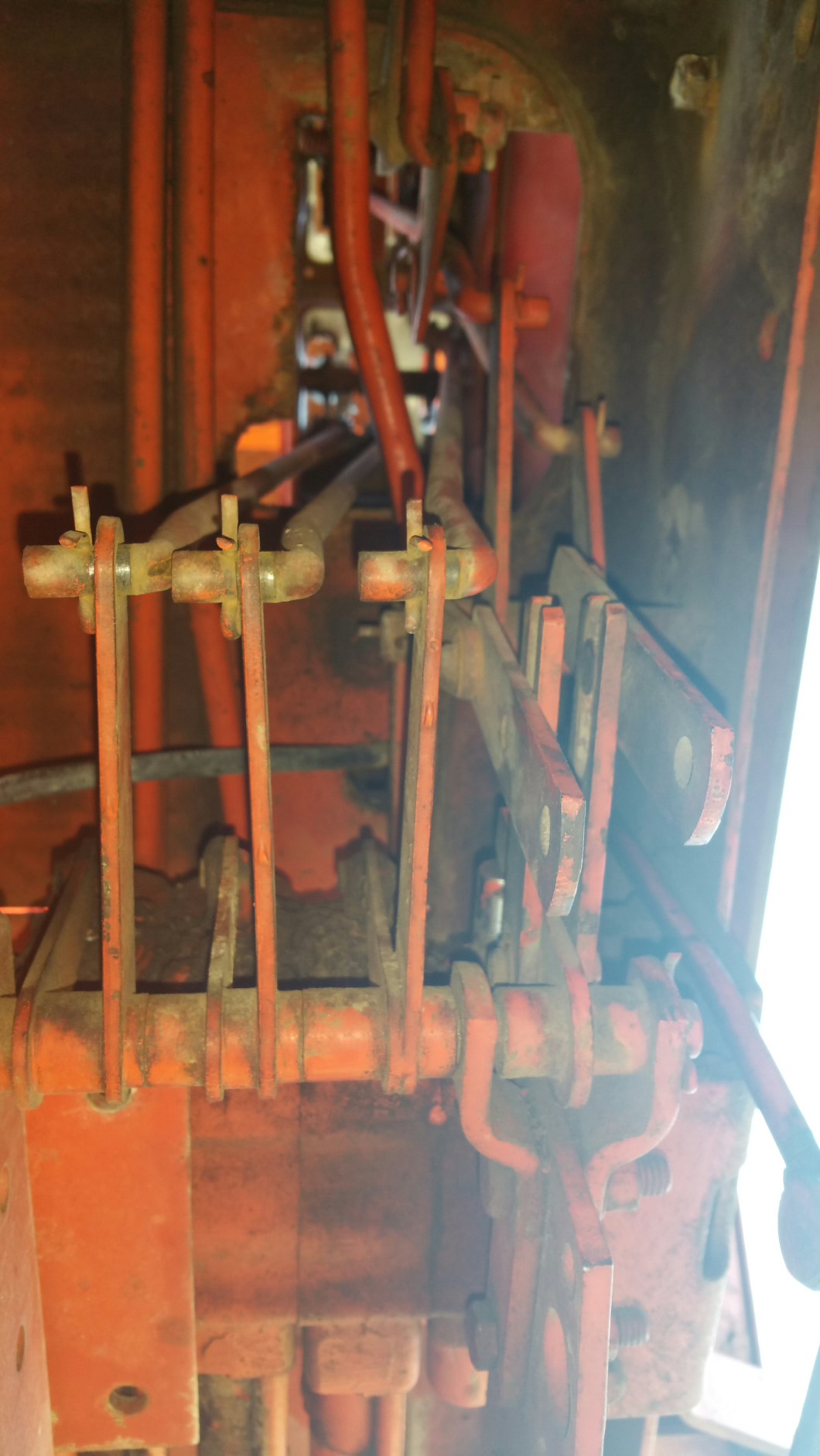

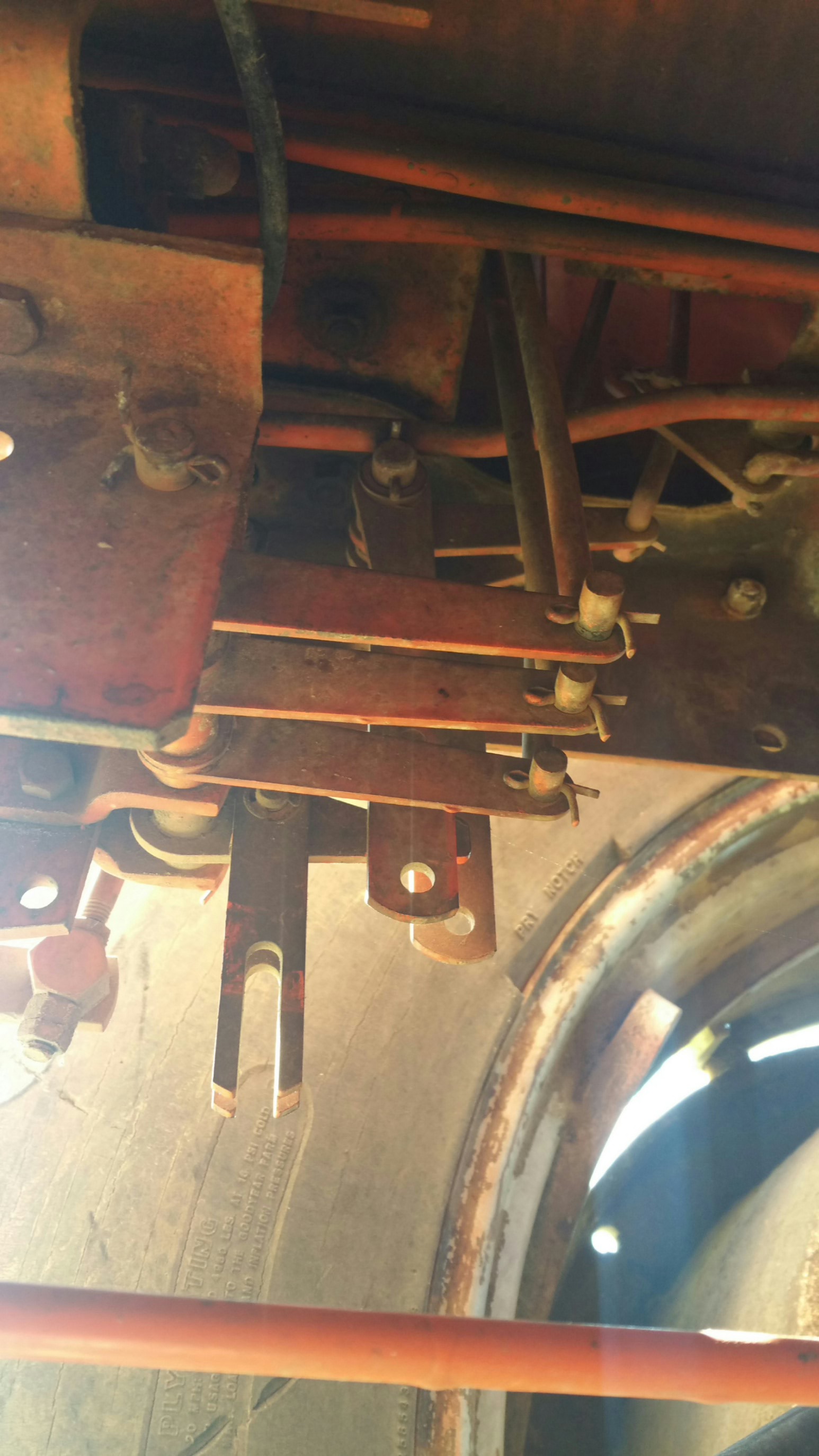

Hello everyone. Could someone please explain to me how to connect this linkage properly? I THINK it's for the traction booster. Thank you in advance.

I have 2 190XT's and they have different traction booster linkages. Would need to know serial number to know witch. Parts book will help.

Looks like you are missing some parts to complete the linkage. Unless you are using the Traction Booster or Position Control, you are fine as-is.
