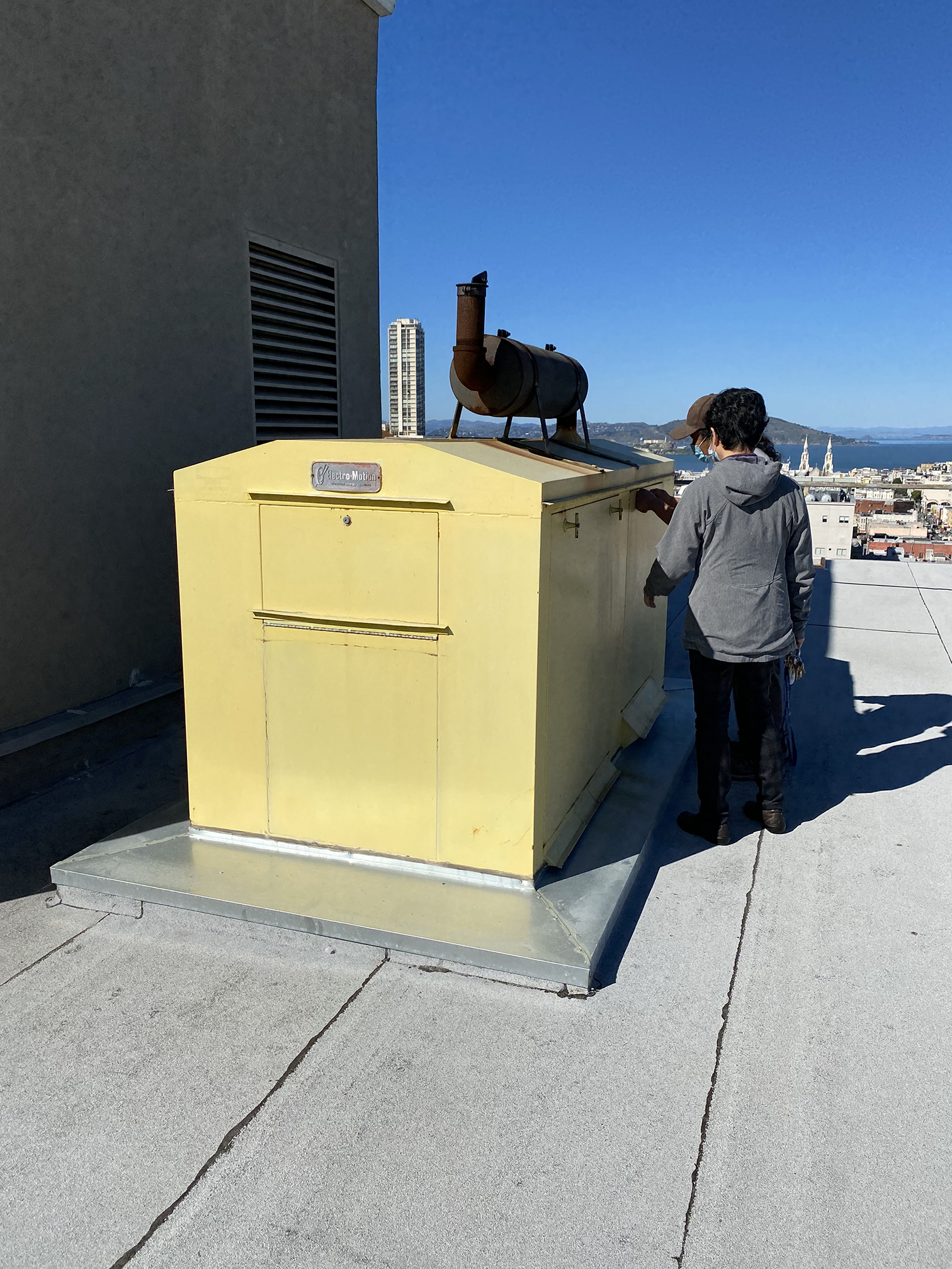

Hi, anyone know where I can possible find the specification for this Allis Chalmers generator? Generator model is 649-T, serial# 49-11862 with spec#/ Cat# 1-7451-6786.

Thanks but anyway I can verify it? I understand Allis Chalmer is just the motor but there are other components included, put together by another company, right? Will it say somewhere on the generator?

there SHOULD be a tag on the generator... Im sure it had one originally.  That size motor  "SHOULD" line up with a 60KW unit (generally).

I am particularly looking for the weight of the existing generator. We are replacing the existing generator but also might need to replace the concrete curb which the generator is being sit on. Structural engineer wants to know the curb weight so they can compare with the new one if the existing concrete curb can accommodate the new generator.

Lacking the machine's documentation, the best answer will be to look on the data tag inside the unit... as that's where the commissioned and proof-tested output will be identified.  IF you're very lucky, you'll open up one of the panels to find a copy of the documentation set inside a sealed metal compartment...
And I see you've clarified your question, narrowed it to weight.
Again, it's provisioning, you wouldn't find anything other than a 'range', because it depends on how it was fitted up.  All we could do, is 'wild guess'.  It'll be more than 3000, but probably less than 7000.

You could contact Electro Motion in Fremont Ca.thats their badge on the gen set. According to their website they do swaps for your crazy state policies on CC.
