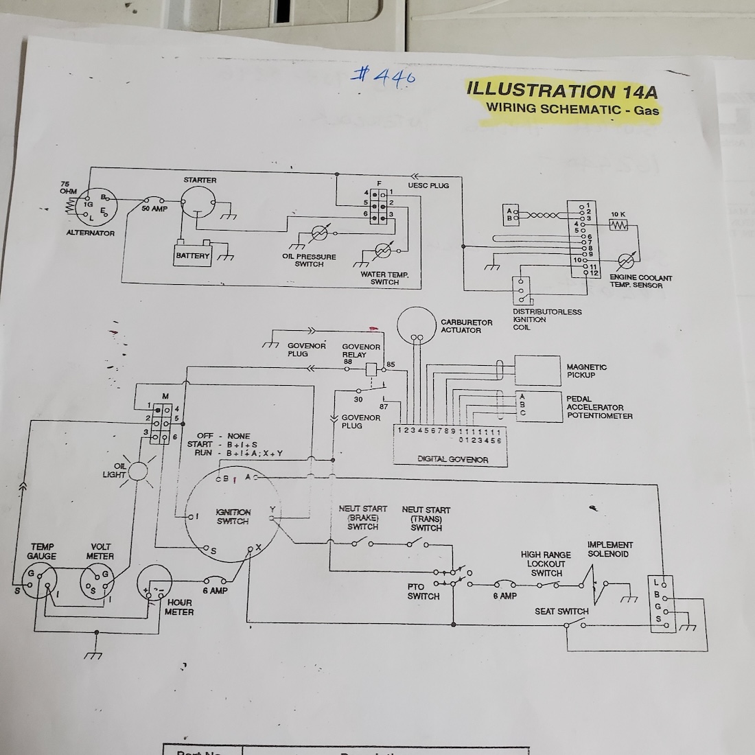

Post Options Post Options   Thanks (0) Thanks(0)   Quote JoeM(GA) Quote  Post ReplyReply Direct Link To This Post Posted: 09 Jun 2025 at 9:12am
Tracy wanted me to post this -

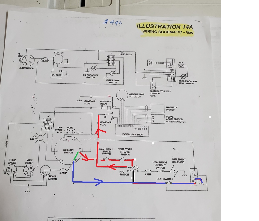

Points: 90808
Post Options Post Options   Thanks (0) Thanks(0)   Quote steve(ill) Quote  Post ReplyReply Direct Link To This Post Posted: 09 Jun 2025 at 1:04pm
this would appear to be the TWO circuits of the igniton to GROUND... thru the brake, pto or  seat switche........ i think there are actually TWO CIRCUITS... the brake and neutral should just be to START... not continue to RUN...  the seat circuit is needed to START and RUN ?.. but BOTH go thru the PTO switch..
Closing  the brake and nuetral  switches should make the circuit CLOSED and therefor make the tractor START ... but have no effect on the RUN....You said you had to JUMPER the start circuit ?  That was probably the OPEN BRAKE SWITCH...... Seems like the PTO switch ( double switch) in ONE position allows the tractor to START and PTO not engaged... In the OTHER position, it allows the PTO to engage and opens the  START circuit.... dont look like the PTO switch OR the Brake switch can kill the engine..
Edited by steve(ill) - 09 Jun 2025 at 2:07pm
Points: 90808
Post Options Post Options   Thanks (0) Thanks(0)   Quote steve(ill) Quote  Post ReplyReply Direct Link To This Post Posted: 09 Jun 2025 at 1:30pm
print only shows HARD WIRES... dont really tell you what is happening inside the Digital Goveror box with the coil, pickup, carb controls.
WHen you take off the BRAKE, or move the PTO switches, you are OPENING the START circuit ( the RED LINE) to the GOVERNOR CONTROL.( i am assuming the switches are all CLOSED to start).... that should have NO EFFECT, but that seems to be the problem....
Im starting to wonder about the KEY SWITCH  ....... and the RED LINE up to the GOVERNOR / coil / pickup ?
Edited by steve(ill) - 09 Jun 2025 at 4:27pm

Points: 10936
Post Options Post Options   Thanks (0) Thanks(0)   Quote Tracy Martin TN Quote  Post ReplyReply Direct Link To This Post Posted: 09 Jun 2025 at 5:44pm
Steve, I replaced key switch, I can install old one and see if it makes a difference. The little block in your drawing lower RH corner with red and blue lines, could this be the seat switch  delay relay ? It checked less voltage than manual said, so I ordered a new one. Be here in a couple of days. It would let 8-10 volts across, service manual says should be 12 volts or replace. The relay had a plug with 3 wires, and a separate wire for ground. Could this cause my trouble. Many thanks for taking the time to help. Tracy

Points: 90808
Post Options Post Options   Thanks (0) Thanks(0)   Quote steve(ill) Quote  Post ReplyReply Direct Link To This Post Posted: 09 Jun 2025 at 9:17pm
could be the seat delay in the corner... BIGGEST PROBLEM is the wire diagram does not show whats INSIDE the Delay, or the Governor control box... Schematic shows NOTHING connected to the coil / distributor / governor as a KILL SWITCH . ..... going to be real hard to guess what is causing it or even how to TEST it since we dont know HOW the spark is STOPPED  ( inside the BOX at the top right , inside the Governor box, inside the seat relay ??)
the GOOD NEWS is the PTO switch is tied to the Seat Switch which is tied to the DELAY BOX... and we know the seat switch can kill the engine... so if the DELAY is bad, then POSSIBLY the PTO switch engagement could kill the engine...  GOOD LUCK with the DELAY.
