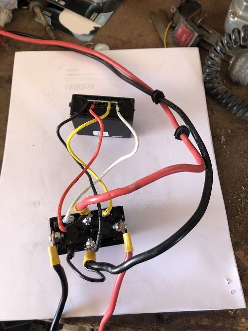

 actually,,after 3 hours of turning everything over in the garage,,,I found the control box where the dang cats had hid it out,,!!! but the remote itself an't turned up yet, but I want to delete the friggin remote and maybe install a couple of toggle switches to bypass the remote if you can tell me how,,,,,??
 Here is a pic of the control box. The big red and black wires coming out the btm are going to the winch motor. (motor only has two contact points)
 The two red and black wires coming out the top are going to battery with a circuit breaker on the red wire.

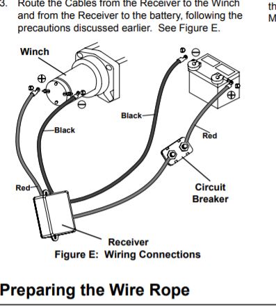

https://manuals.harborfreight.com/manuals/63000-63999/63476.pdf

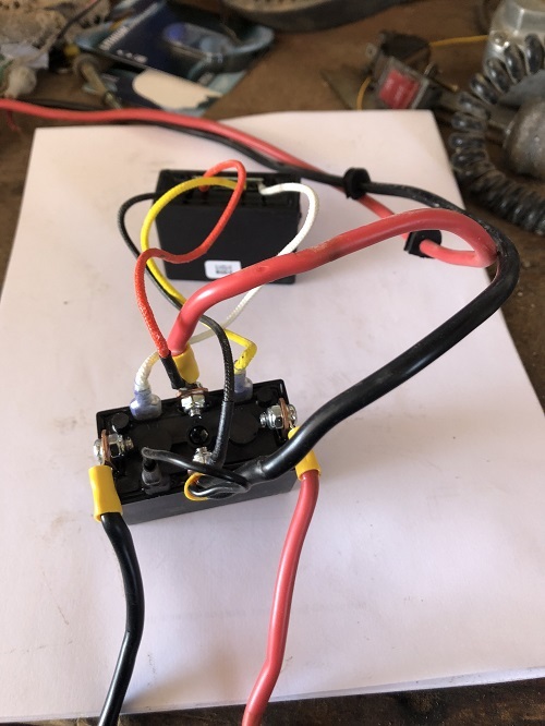

 The black box at top of pic with the black, yellow, red, and white wires is, I think, the trans-ciever for the remote,,,??
Points: 90800
Post Options Post Options   Thanks (0) Thanks(0)   Quote steve(ill) Quote  Post ReplyReply Direct Link To This Post Posted: 07 Mar 2021 at 1:25pm
YEP... that little box can be replaced with two switches or a double throw switch.. I dont know exactly which relay you have.. Does it have a NAME or NUMBER on it ??
Basically you have a RED and BLACK wire going to that box.. that is HOT and GROUND.. the other two wire should make the motor go forward or reverse..  The "BOX" is using one wire for FWD and one for REV... but i dont know if it is connecting the one wire to the RED or the BLACK ??
something like this.. See the RED and BLACK are the supply to the relay...  the SWITCH either connects the RED wire to the little T5 or the little T6 wire..... they dont need the GROUND running to the switch on this system... dont know about yours. .. it may have the ground just for the REMOTE to work.?  T5 and T6 would be the white and yellow wires.
Edited by steve(ill) - 07 Mar 2021 at 1:27pm

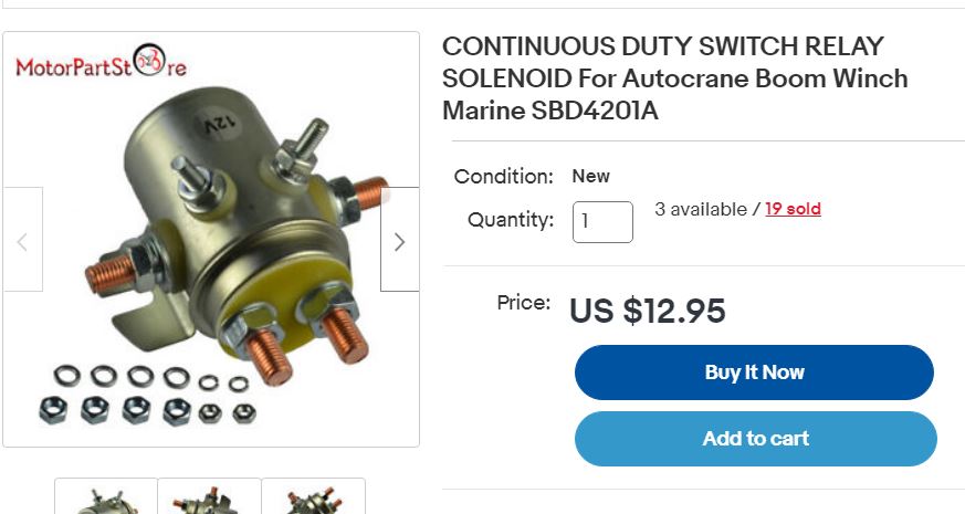

Look close at MY RELAY and YOUR RELAY... Looks real similar ............. If your BRAVE, touch the RED to the YELLOW for a second and see if the motor runs UP... Touch the RED to the WHITE and see if it runs DOWN.. !!!!
