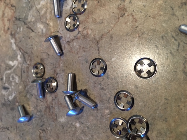

Guys, I just got these rivets from DJ's. Do I need a riveter to use these?
Thanks

No, you just need something to hold the rivet in place and then hammer the clip on.  I use a socket that is the right size to slide it in place.
