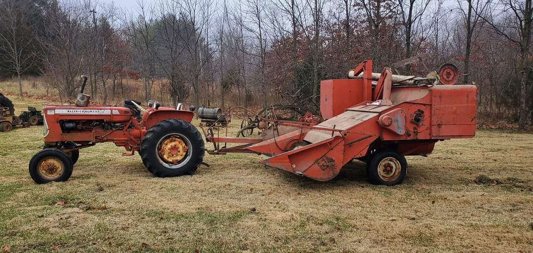

Post Options Post Options   Thanks (0) Thanks(0)   Quote Pat the Plumber CIL Quote  Post ReplyReply Direct Link To This Post Posted: 10 Dec 2022 at 3:52pm
Drove it home today . 17 miles no problems. It is wide. Went the backroads and sometimes it was mailbox to mailbox.
Location: Springfield,Il
Points: 4946
Post Options Post Options   Thanks (0) Thanks(0)   Quote Pat the Plumber CIL Quote  Post ReplyReply Direct Link To This Post Posted: 10 Dec 2022 at 3:55pm
Pic
Points: 4946
Post Options Post Options   Thanks (0) Thanks(0)   Quote Pat the Plumber CIL Quote  Post ReplyReply Direct Link To This Post Posted: 10 Dec 2022 at 3:59pm
Put new tires on it, made sure hubs had grease. D-15 SII did a great job . Pulled a little hard up some steep hills. My friend Tom followed me with the flashers on .17 miles. Took about an 1 hour and 15 minutes . Feel bad in that it has always been under cover and now it is not. A good tarp for now and a building of some sort in the near future.

Post Options Post Options   Thanks (0) Thanks(0)   Quote Steve in NJ Quote  Post ReplyReply Direct Link To This Post Posted: 11 Dec 2022 at 8:49am
Glad to hear you got your Dads Combine back Pat. Even though it has some rust through and some issues, you'll get it back up in shape fir' sure!  Great pic hitched to the D15!  Glad you had an uneventful trip home with it. Sounds like Lon can fix ya up with what you may need. That's a good start to get that ole' girl whipped back into shape!
