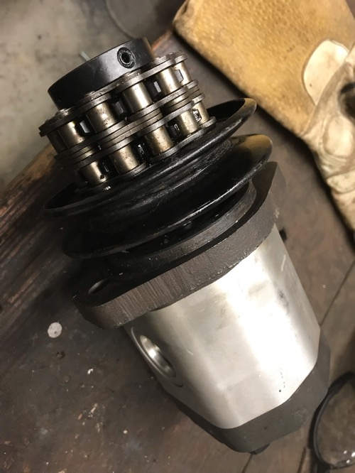

We originally used a love joy coupler when we put a front pump on a WD. It did not hold up and was difficult to replace. We went to the double chain coupler and had no further problems. That was over 20 years ago. We still use the WD.

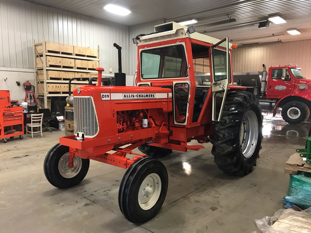

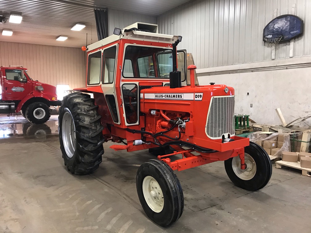

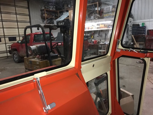

Decided not to go with the loader. Been working on trying to finish it up this last week. Ready to work on hydraulic plumbing now and air conditioning hoses now.

7060,
The D19 sure looks good with a cab! You have done a incredible job getting this to fit and look right. Nice upgrades too. Hope it works as good as it looks!

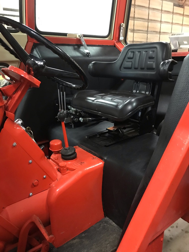

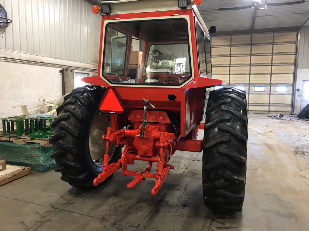

What did you do with the hydraulics beside the seat?

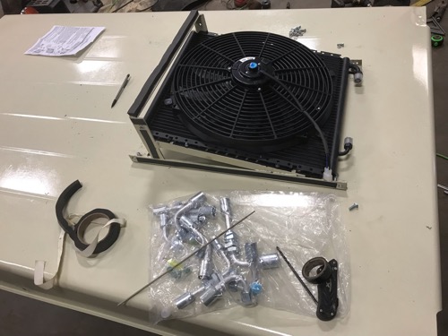

I gutted the old hydraulic pump, and valves. I added a bigger sump to give it about 2.5 gallons more capacity. I have a new 3 spool double acting valve to go on the right side of the seat. One valve for 3point and the other 2 for remotes, powered by the front mounted pump.

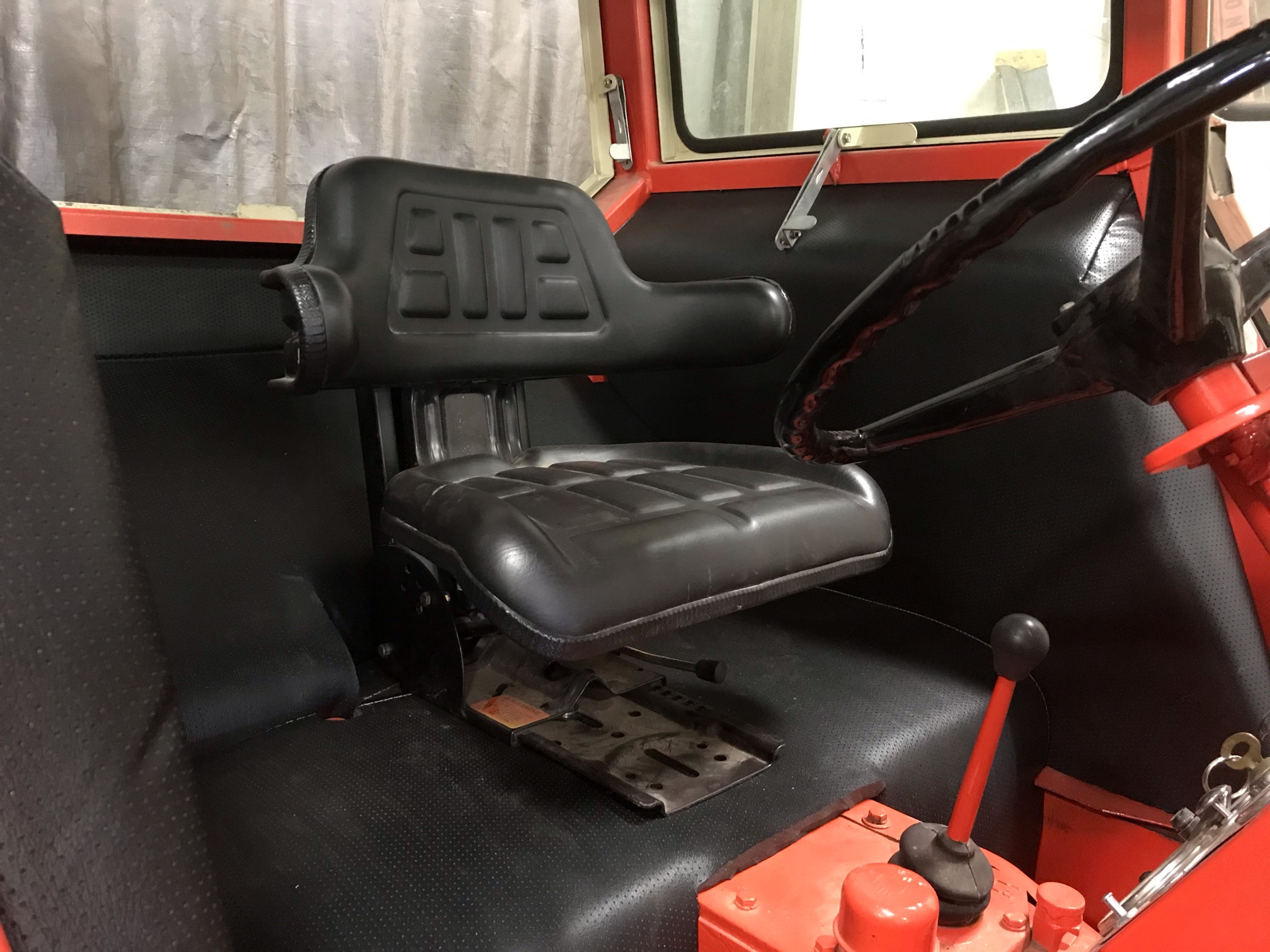

Other than my right door handle and latch on order it is finally finished and ready to move on to the next one. Hopefully I got this picture thing figured out this time. I’m looking for a set of stack weights for the front if anyone has some they would want to bring to the swap meet in Missouri.

7060,
 It just looks right with the cab on the D19! You sure did a nice job on all the details too.

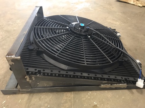

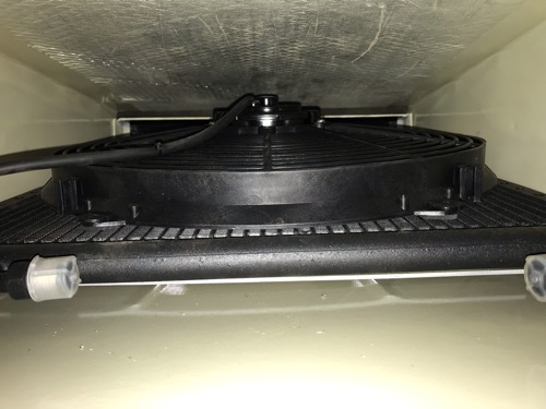

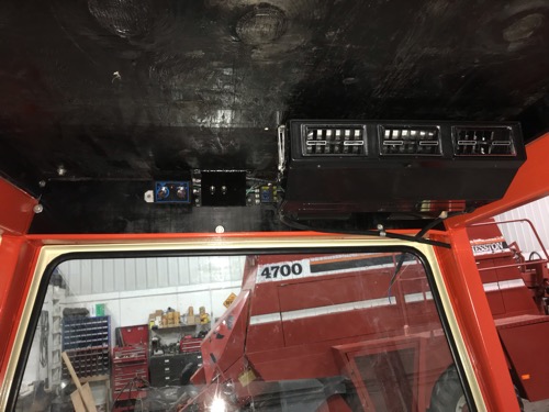

Wow it sure does look nice. I'd be interested in how your AC works

I charged it in the 70 degree shop and it blows ice cold, but time will tell once summer comes. My biggest concern was the evaporator unit doesn’t use a filter. The condenser fan I used was meant for a cooling fan on a vehicle radiator and moves a lot of air.
