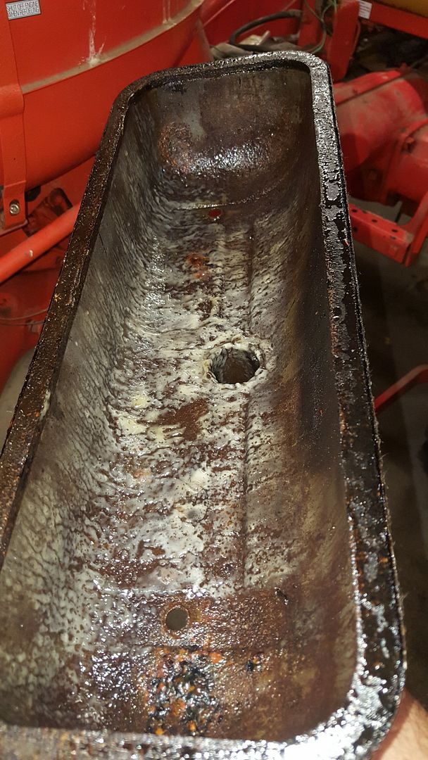

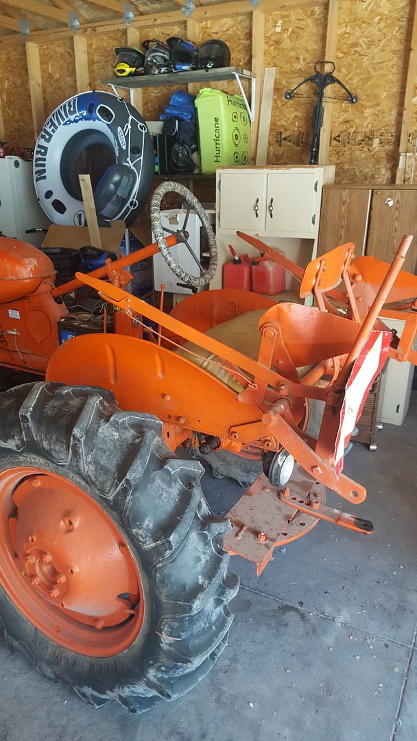

Well I received a gift of a 1945 AC model C. It has the pto shafts on the rear as well as a hydraulic lift system that looks original on it and a shafts that a pulley would go on under the seat to drive other implements. Now this is the 1st allis chalmers I have owned and my 3rd ever tractor. Prior ones being a 60s model international 300 which is gone now, and now have a Ford 881 Powermaster and this little gem. So far I just l9ve this little thing.
Upon getting it I was told he thought the head gasket was bad since it overheats after light use and he just put on a new water pump and thermostat not that long ago and it didn't solve the problem. After getting it home lastnight I took a little ride for like 30 minutes and at the end the new temp gauge read in the high green area then rose slightly into the red after shutting it down. I could hear the coolant boiling a little too.
After it cooled down I check the radiator and the coolant looks kinda nasty so I plan on flushing and replacing that as well as a oil change and change the fluids in the differential and what not
I also pulled the valve cover off and there is so.easy white slime inside the cover from what looks like moisture so Amy be the head gasket is blown pushing coolant the into the oil a little bit?
Any help or advice would be appreciated as I want to get it in great running order then fix it up cosmetically and just use it around our property for dragging trees and pulling firewood back to camp. Maybe get a blade or something for snow removal at home if it won't break the bank.
Will get a few pics of it up here shortly.

I don't suppose you have tried cleaning the radiator fins out?  When it running hot is the air coming off the fan equally hot too?
If it ever got used like any of our numerous tractors have, and it's rare that one hasn't, there's a good chance part of the overheating problem could be related to the radiator not being able to breath.
Also you first picture needs to be a 'Gettin' ready to Cruse da hood country style." Meme.   LOL
(My daughter loves tractor rides too!) Wink
Edited by Tcmtech - 12 Sep 2016 at 5:24pm

Yeah she is already asking if it can be hers when she is older. Lol
The fins are clean. I can see right through them. Didn't check the air temp off fan if both upper and lower hoses were hot but could see the coolant swirling around in there when I started it cold for a minute this morning. At work now so cant try anything till at least 1130 tonight.

That is one CLEAN C.  Looks like it has been restored.
How lucky!  A gift.
For a snow plow you may want to look for a myers blade.  We put a lot of them on C's and they worked very well.  Are the tires loaded?  That will make pushing snow or pulling anything a lot better.
The B-C, CA's were rather "cold" running tractors.  You are changing the fluids and that should help.  Be sure to flush the cooling system.  Only other thing - and I hope not -could be a plugged block.
Let us know how it goes.  Neat Tractor.
Good Luck!

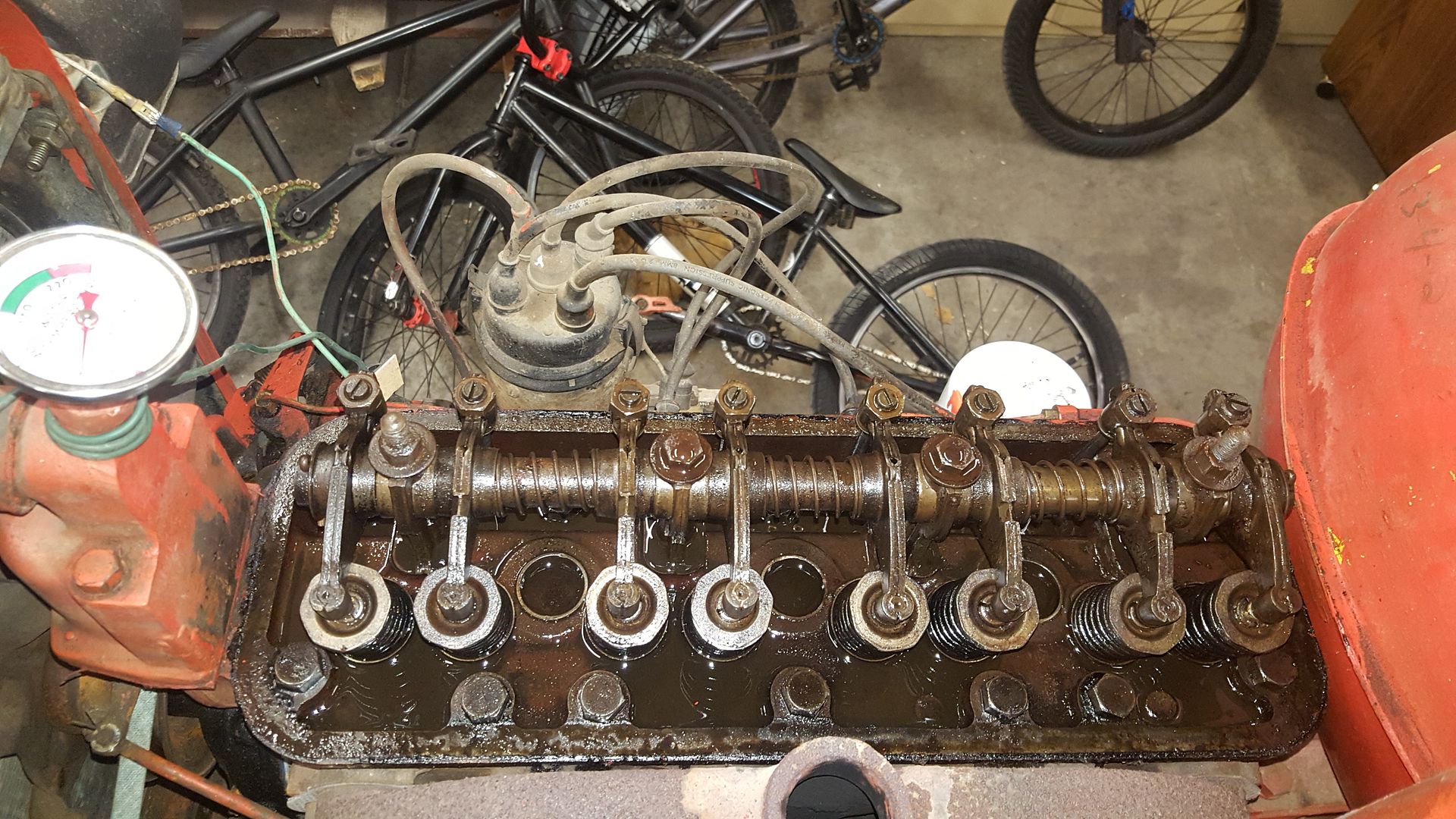

 1. After getting it home lastnight I took a little ride for like 30 minutes and at the end the new temp gauge read in the high green area then rose slightly into the red after shutting it down. I could hear the coolant boiling a little too.
2.After it cooled down I check the radiator and the coolant looks kinda nasty so I plan on flushing and replacing that as well as a oil change and change the fluids in the differential and what not
3.I also pulled the valve cover off and there is so.easy white slime inside the cover from what looks like moisture so Amy be the head gasket is blown pushing coolant the into the oil a little bit?
1. High green is OK, but these engines tend to run too cool not to the warm side. If the radiator shutters are all the way open it should probably stay closer to the low side of the green.  ANY engine will show higher temp after you shut it down, that's not a problem.
2. Flushing is probably a good idea.
3. With the valve cover off, look for core plugs in the top of the head. If they leak a little bit, it can cause the milk shake in the oil. They MAY look OK but they rust from the bottom side and will eventually leak, letting coolant drain down into the oil pan. NOT a thing to let happen because antifreeze in the oil will destroy your bottom end bearings in a short time.
 This is a cheap and easy thing to fix. Core plugs, or Frost plugs can be bought for a couple dollars and once the coolant is drained down below the head level, you can drive a screw driver thru the old ones and pop them out. Clean the casting with sandpaper and wipe a SMALL bit of sealant around the hole and tap a new plug in.

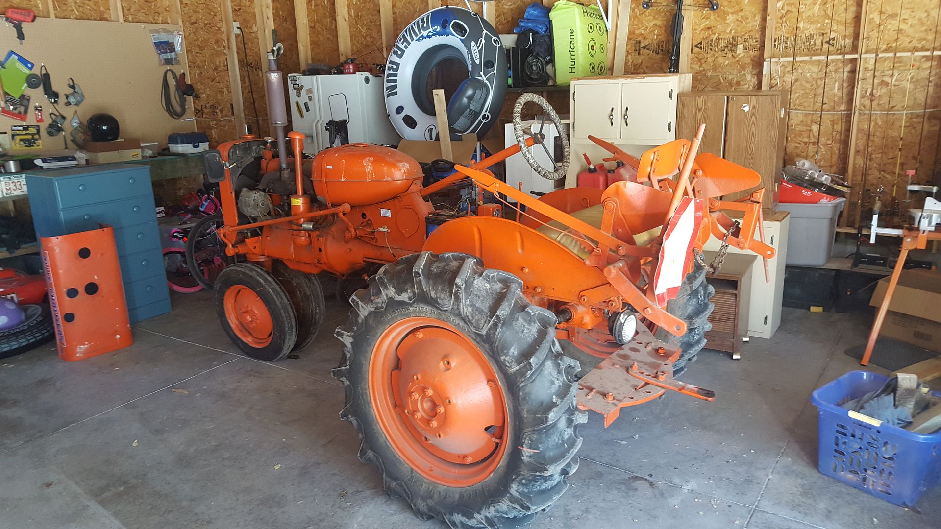

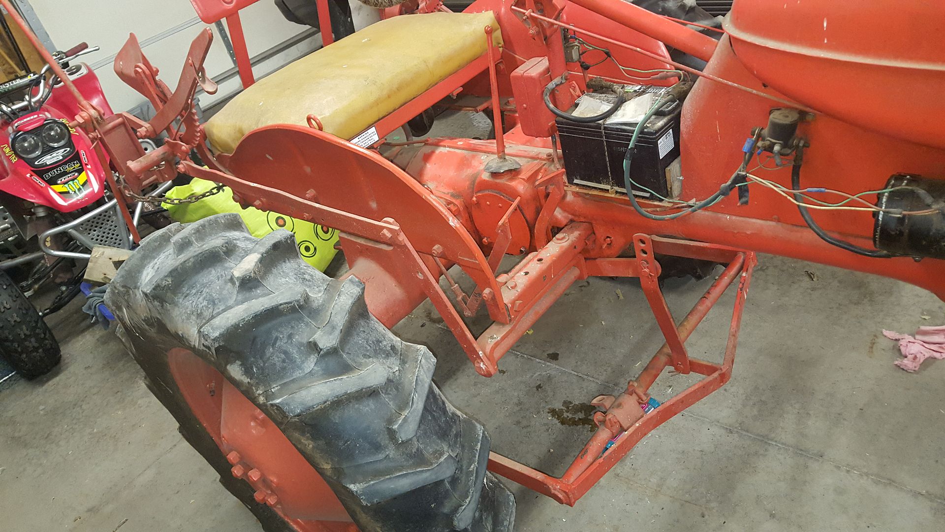

What you have here is what is known as a "Short Arm C" referring to the short steering arms. They are very early Cs. The short arms were replaced by long arms at C#18163 that would be in late 1942. Beginning number to be a 43 is C#18782

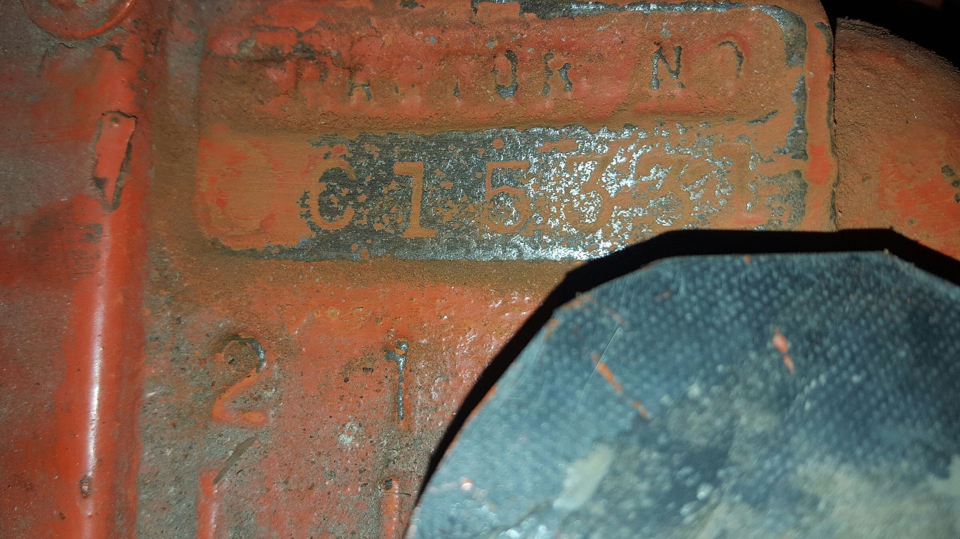

If in fact,as you say,it is a 1945 C the tractor number should fall between C30695 and C36377
I'm surprised no one has pointed this out before me.
If your numbers match the numbers for a 1945 the transmission was probably changed. Probably a Restored Tractor.

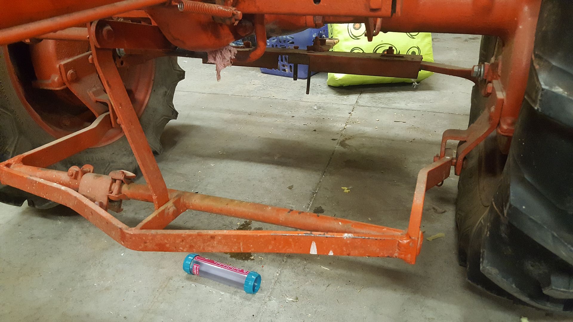

Nice C regardless of year it is. The forward facing drawbar under the tractor is used with Tractor mounted B/C plows. The plow debth control lever is missing. I have that lever if you ever need it to mount a plow.
The two lift levers in the rear are also part of the C Left right two Plow setup.

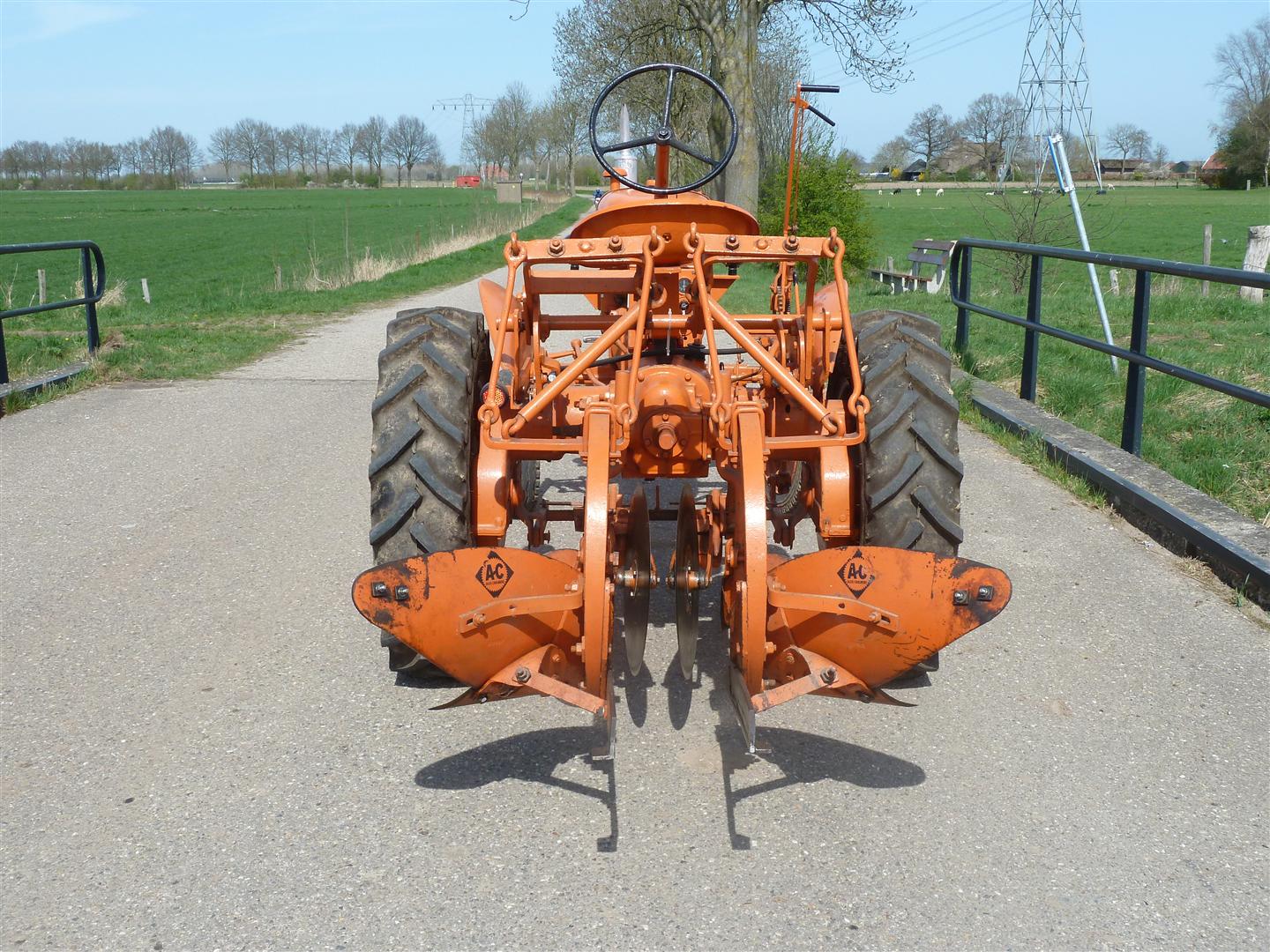

Here is a picture of a left right 2 plow set up on a B for reference.
The ones on the B are independently operated up and down by hydraulics.
   The two hand levers on the C here indicate the plows were independently raised and lowered by hand.
Look close at the B and you can see the plow debth control lever to the right of the steering wheel

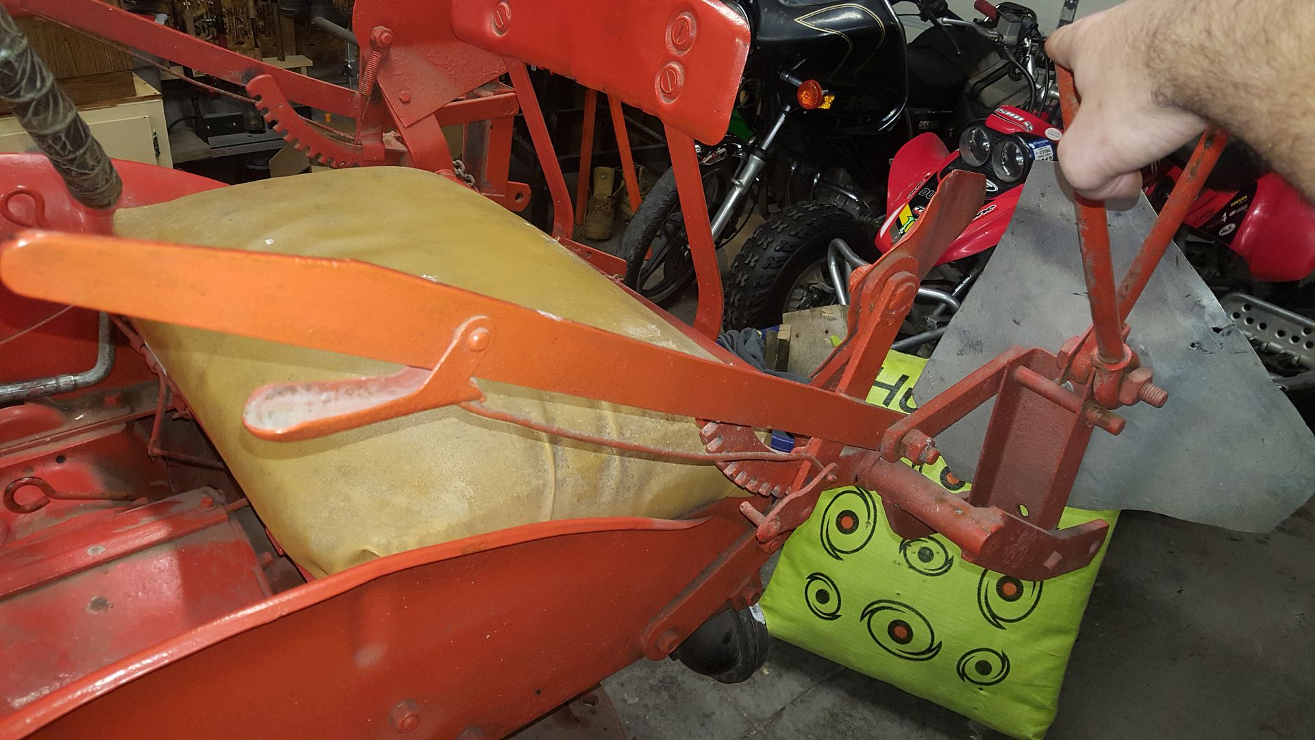

There is a lever on both the left and right sides similar to yours. The right side raises and lowers the bracket in front of the rear wheels the plow woulster attach too and the other one on the left moves an arm with 2 steel rods or bars that are mounted the end of it.
If I recall the serial number was right in the middle of the 1945 serial range. Is there anywhere else I can look for a matching number?
Also any idea what the steel rods are on the ends of the rock shafts I believe it's called. The hydraulic lift bar?

In this image you can see the 2 handles that are either side for the lift. If you look right behind the slow moving vehicle sign the rods I'm asking about are standing up against the sign. The other side has 2 of them as well....

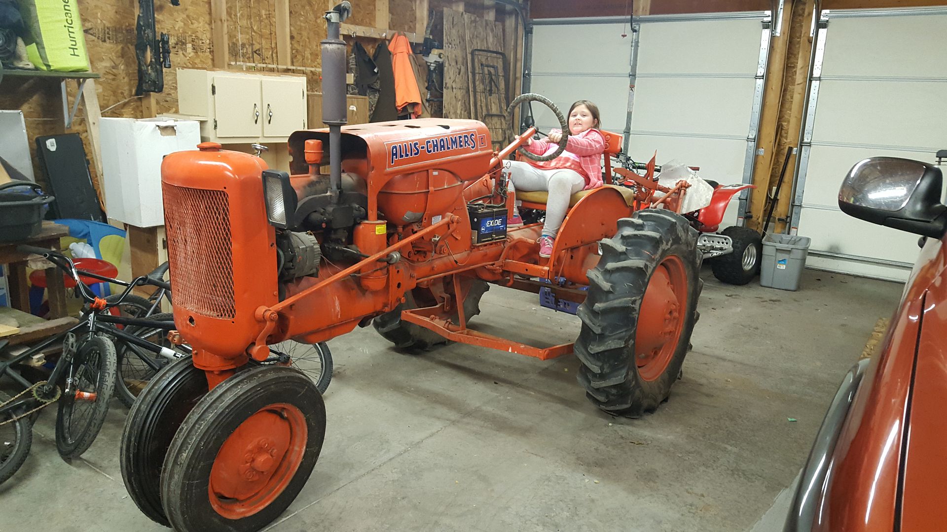

Man alive. This C has real C fenders what aren't rusted half away up.
Those goofy aftermarket headlamps got to go.
That funky excuse for a drawbar extension needs to go too. A real AC B/C swinging drawbar would look perfect back there.
Doing it right makes it worth doing on a FREE tractor

sorry me can't see a plow debth control lever on your C. My plow debth control lever bolts to the footrest on the brake side.
That rockshaft "tool Bar" with the two levers were also used with C two row cultivators.

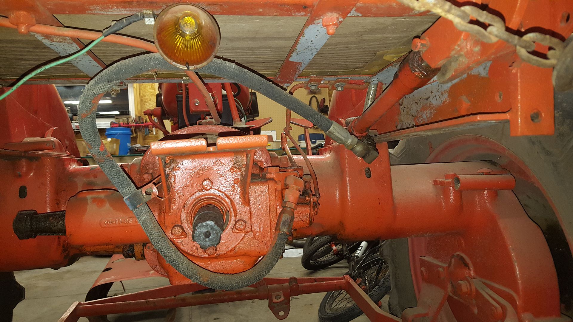

One more Question and I'm going to bed. Are there any hydraulic cylinders up under the seat I cant see and is there a two way valve in the hydraulic line system anywhere?.
We can hash this mess out later.
one more thing. Is there any kind of bracket bolted with 2 bolts to the top of the final drive housings between the tire and the fender?

There is a small high psi cylinder under the seat on the right side of the tractor. I'll be off of work in 30 min and will check it out then n put up some more pics.

Ken
Only the B uses that front plow adjuster lever. The c uses the levers on the rear rock shaft to adjust depth. A manual lift for the C is very similar to the manual lift on a B and mounts on the right side of the tractor. Bob
4 B's, 1 C's,3 CA's, 2 G's WD, D14, D15, B-1, B10, B12, 712S,
Ken in Texas View Drop Down
Location: Henderson, TX
Points: 5919
Post Options Post Options   Thanks (0) Thanks(0)   Quote Ken in Texas Quote  Post ReplyReply Direct Link To This Post Posted: 12 Sep 2016 at 11:18pm
I finally figured it out CB after digging out my B/C tractor mounted plow manual.
What he has there and won't use could make somebody with a C and a plow with no mounting hardware a very happy camper.
Having never set up a plow on a C I was just guessing.
What are the 4 rods attached to the rock shaft he is taking about? One pair is up the other hangs down.
I guess the big ? is what year is it? and What happened to the plow?

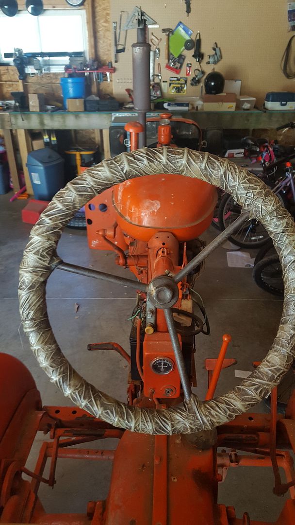

Here are some pictures of everything along with a shirt video.
1st pic is the left side and the 2nd and 3rd are of the right that raises and lowers the bracket in front of the rear wheels.
PTO and Hydraulic pump and cylinder
White slime in valve cover and top of head with rockers

Sanded the serial number to see it better
1 other view of the lower bracket where plow would attach

Also after sanding the paint off the serial number it dates to a 1942. The 2nd year the C was made. My mistake on it being a 45.
Serial number is C15331
