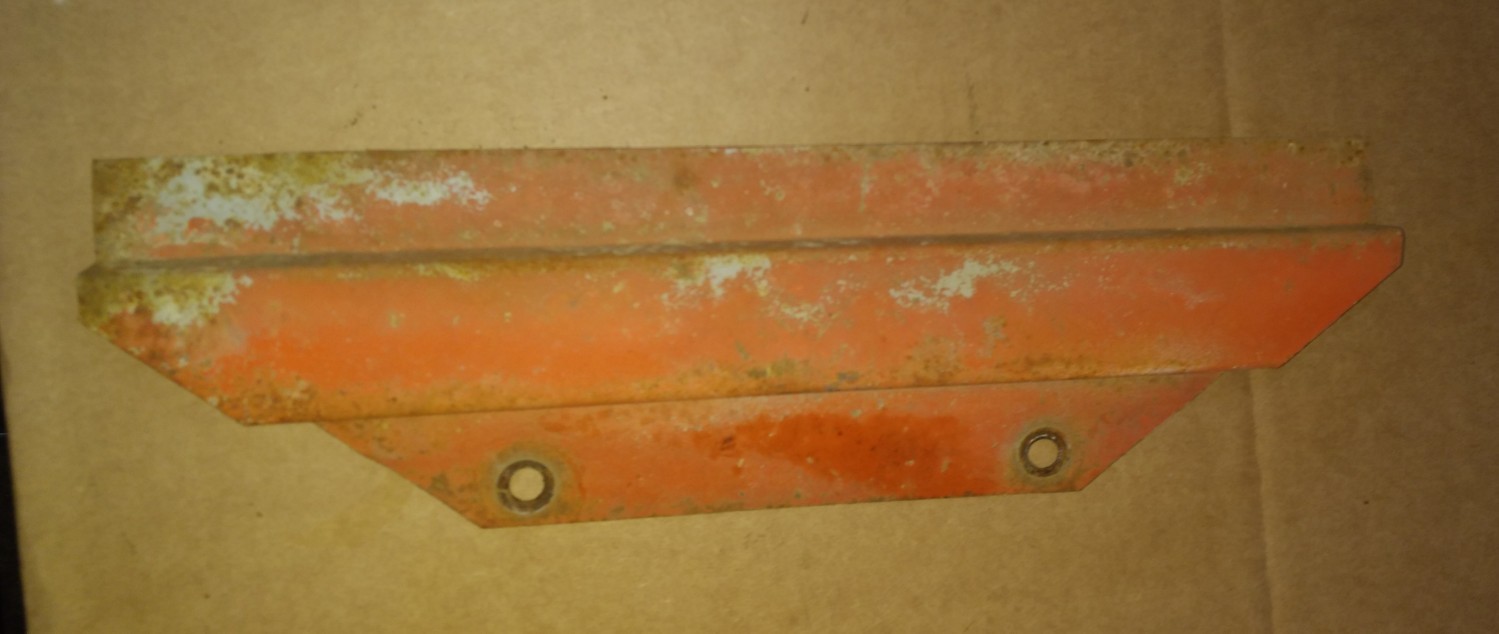

Is this what you're talking about Don? My 45 is a 1954, so the PS was added and it never had these things.
Well that's not it, that's a lower radiator shield for WC/WD tractors with a mounted corn picker.

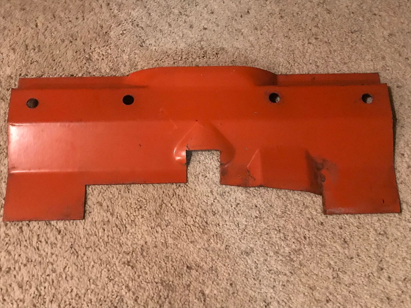

So they would be kinda like the mud shield under the D17 narrow front, but in 2 pieces?

     Those are the ones. So do they bolt on under the frame rails to keep mud away from the pulley on the end of the crankshaft and radiator?  You would be getting into some serious mud if that is the case.

The one you show above is the right one for WD/WD45, it's just the one piece, they not two pieces. They are held on with two spring loaded flat sided pins that go through the slots like in the pic above and there are two punched tabs in the L shaped side in the pic you can't see that fit's in the two holes in the front engine mount holes that are used to hold a wide front end back brace on. The WD45 shield are a piece of cake to take down, just pull down and turn the two spring-loaded flat pins a 1/4 turn then drop the front part down and the pull the shield forward a 1" or 2" and out it comes.Smile

So, it appears the seller thought they came as a set of two......I think the purchaser got a real deal.........two for the price of one.

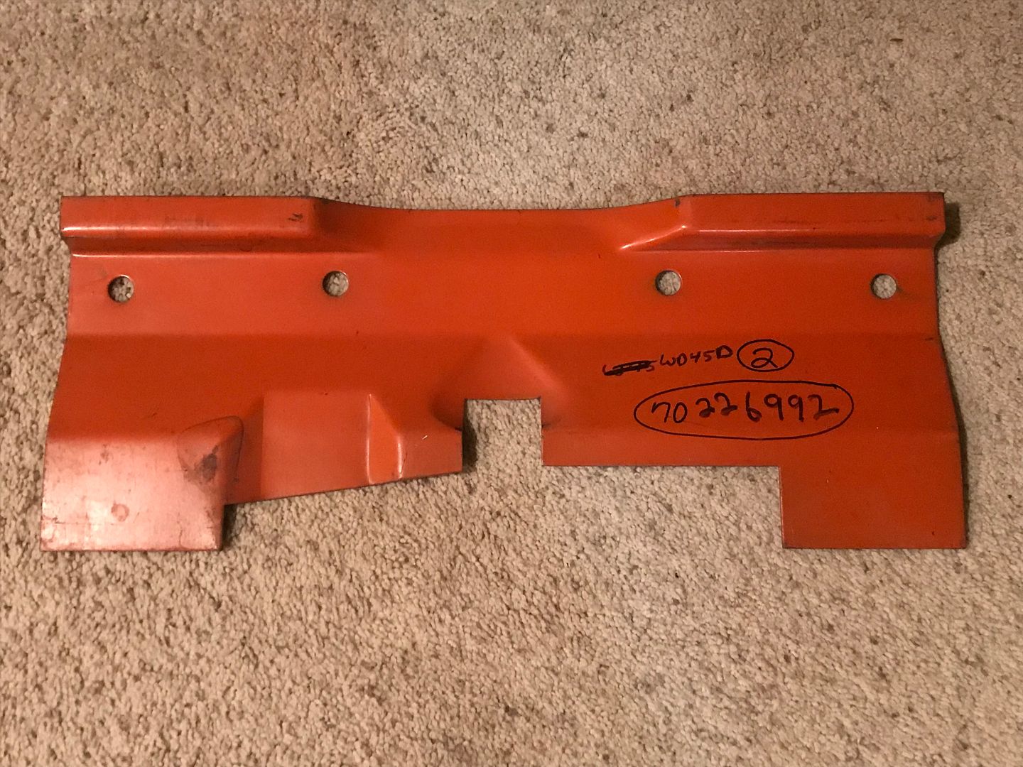

This is the shield for the 45 Diesel that Don has mentioned...

Thanks Chad I don't have pics of the shields. It's funny the ease of removing the shield off a WD45 gas tractor compared to removing one off the same tractor with the Diesel engine is.

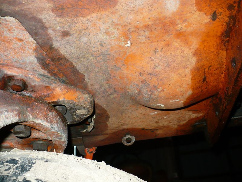

I'd still like to see pics of it on the tractor as I've never seen one either.  I'm still scratching my head trying to figure it all out!

Here you go Ted, That's pics of two dif.  WD45 gas tractors top two pics are of the same tractor. It was hard to take the shots under there.

If you ever ran a "naked" narrow front in the goo-ball mud,you'd understand the need for the mud shield. You can destroy a fan belt sooner than you think.

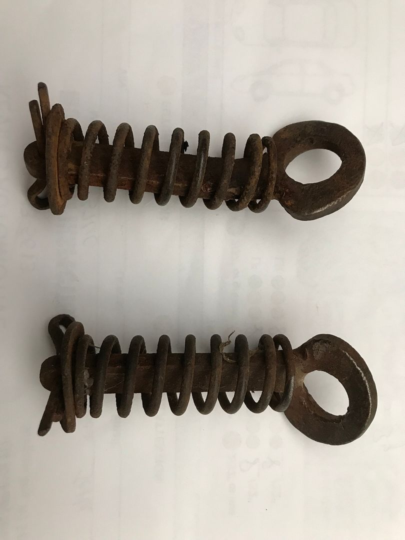

Just a better pic of the clips that hold the shield on the gas models....
