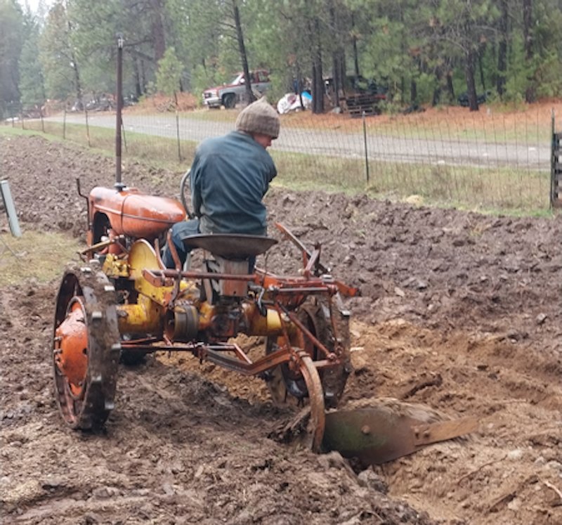

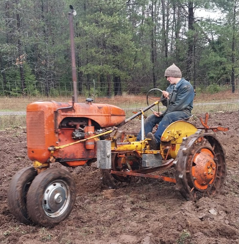

Post Options Post Options   Thanks (0) Thanks(0)   Quote Les Kerf Quote  Post ReplyReply Direct Link To This Post Posted: 19 hours 9 minutes ago at 9:02pm
Grandson has been busy installing sheet metal, gas tank, and rockshaft. Thanks ORBill! Smile
Levi decided to hook up the plow and give it a whirl.
Probably won't win any plowing contests but it's a start.
