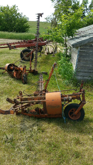

A guy told me these mowers were made for the CA? Is that true? Any idea on model? Did they work well?

Made more so for the B/C.  It's a NO. 3 Sickle Mower.  A NO. 7 Snap coupler sickle mower more so for the CA, then obviously the 80R, pitmanless mower for the later years for the CA.

With the correct brackets, the #3 bolts right up to a CA. I had one about 10 years ago. I don't know about the B.

The #3 mower shown above does fit on the B.  I remember mounting them  In fact, if memory serves me correctly, the bracket mounted on the #3 mower in the left hand picture above looks to have the mower brackets for the B.  If the tractor mounting brackets are available they could fit.  There would also be a special bracket for the lift arrangement for the B so that the smaller B - C hyd. ram could be used.  Also, there was a longer hose so the hyd fluid could be "piped" to the ram.
However, I would carefully consider the size of the cutter bar on the shown mowers.  It looks to be about a 7 foot blade.  The side draft may be more than the B could handle.  On the B-C side mounted mowers we did not mount a 7 foot bar because the B was not heavy enough to combat the side draft in heavy cutting.  A six foot mower was the largest we used on a B-C mower with no problem.
I am away from home now or I could refer directly to a #3 mower operators manual I have.
I know the #3 mower was made to be fitted to the WC, B, C, CA, WD, and WD-45.  I am not certain if brackets were made for the D series tractor.

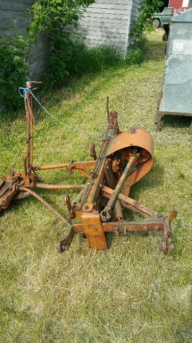

#3 mower I don't see any mounting brackets in the picture. The CA brackets look like a Triangle that bolts to the Lift arms when straight up and down with the Pin hitch drawbar on. I mowed many acres with one on a C when I was a kid. 7' bar worked fine on a C. I currently have one with two sets of WD mounts.  I bought mine for $125 it came with the WC and  WD mounts, Parking Stand and Manual. I only mow about 600 ft of roadside once a year with it, but it works good and is fairly easy to install and remove.

the one on the left is missing the mounting bracket that bolts to the drawbar.  I have used mine in the Wd45 and D17.  Just for Comparison--$125.00 would buy mine. South central Iowa.
