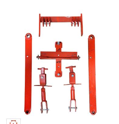

I need some help on parts to mount a plow on my B. This what I need that I know of. I need the clevis type holder that the front of the plow attaches to the front draw bar. Not sure if I have all the right parts for the round bar that attaches to the seat frame. I have two different size shafts, can anyone help me please am puzzled thanks Dave

Steve(Ill) that plowlooks like it is mounted too far back. The plow drawbar should be attached to the front the the gear case. It looks like it is attached at the same point as the pluuing drawbar. Bob

Bob, I have to agree.  The plow drawbar mounts to the front attachment mounting setup rather than the drawbar mounting setup.
Sharp eyes.
However, I hope DaveWis sees the rear hookup for guidance

Thanks for the posts. Does anyone have anymore pictures of the mounting on the B. Also I still need the pieces to put this on my B. Can someone help me out. Thanks Dave

Dave, I am no expert on the B plow, but I bought one and mounted on my B. I removed the plow and installed a 5 ft wide blade in its place. The lift mechanism in the back is the same. There is also a handle by  your left hand to raise the front up and down. I removed than and installed a fixed link. Here are some photos. Maybe others can add info that you need, or you can point out parts that are missing.

The 2.5 inch pipe running at a 45 degree angle in the photo above is not factory.. That is a brace to the corner of my blade.. Below are photos taken from the front wheels looking backward under the tractor.
In the above photo you can see the center pin that holds the beam to the cross bracket. Note the bracked hinges at the final drive cases. The bracket can be raised or lowered a few inches with the hand lever.
Foot step is center right of page.. to the far right is a fixed vertical bar to hold the cross bar in one position. The hand lift lever would replace this.

The front cross arm can be raised up and down with the hand lift. I think this slides over the 2 x 2 foot rest and bolts on. Extension arm goes down to attach to the cross arm.

That helped a lot Thanks. What I need is the hitch clevis type piece that holds the plow to the front draw bar. Also I need the piece on the back on the side where the little cylinder fits that holds the pipe up. Hope someone has those two pieces .Thanks Dave
