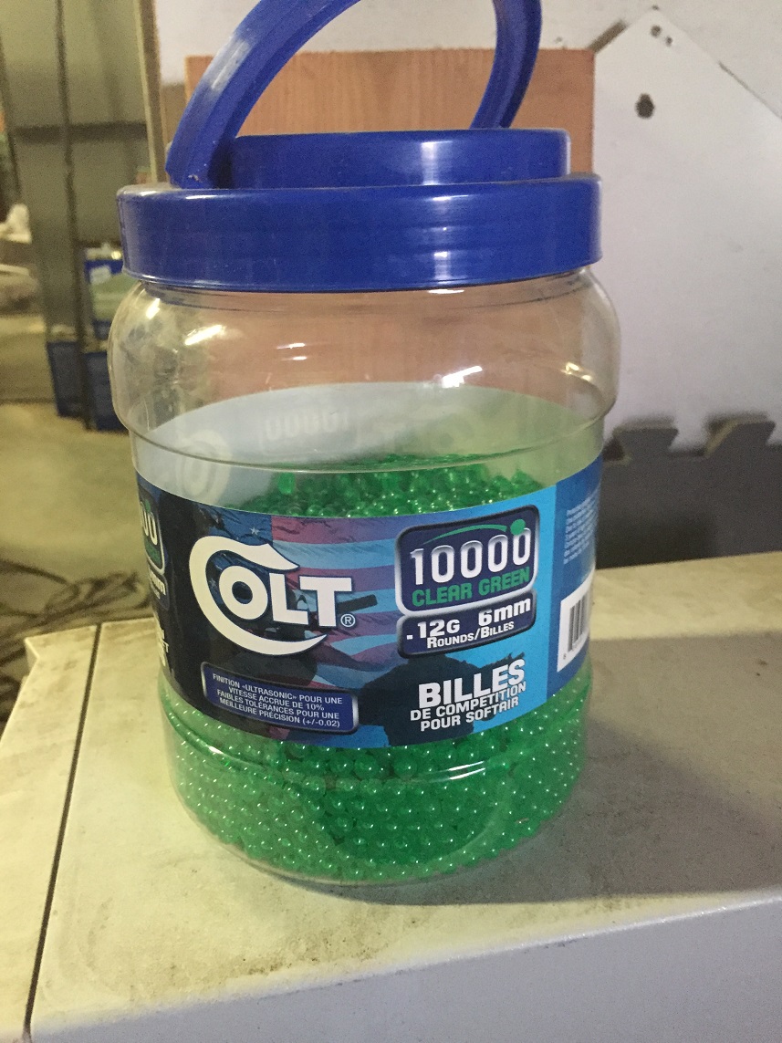

I've used airsoft pellets from Walmart in my tires for several years, cars, truck camper and trailer, works for me.  I noticed a little vibration at 70mph in the dually for a bit but has gone away.  Amount of beads depends on the size of tire.

JW, I think I have 205/75-R16.  How many of those beads do I need to put in?

The packages have the size of tire on it. Different packages for different size tires. Just drop whole package in tire before mounting. Last time I had tires mounted, I think it was $4 per tire.

Here's what I use, I use a good hand full on those, (3-4oz),  truck and trailer I add almost another hand full, (6-8oz).
