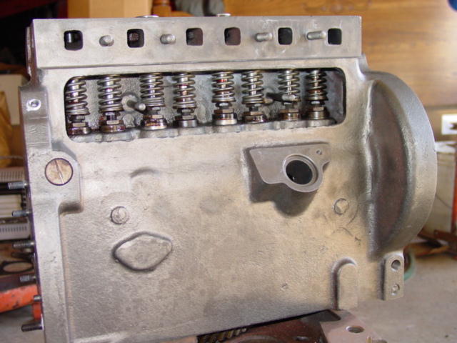

I have restored a 1949 Model G.  I am not getting any oil pressure or oil circulation. The oil pump is running backwards. How can this be?

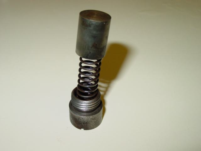

What makes you think it is running backwards?
Take the plug with the slot in it and see what is behind it. If you have not had it out it could plugged behind the plunger.

Sorry, it is not running backwards. I was looking at it the wrong way.

I have the engine pulled apart now to look at the pump. Everything looks good. Will reassemble and try to prime the pump as you suggested.
