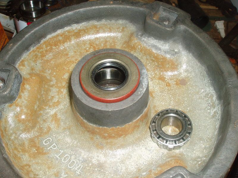

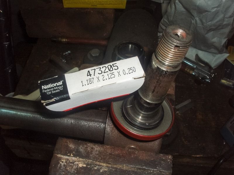

Post Options Post Options   Thanks (0) Thanks(0)   Quote JoeM(GA) Quote  Post ReplyReply Direct Link To This Post Posted: 07 Jan 2017 at 7:06pm
Hey Scott, it will work, as will a National #473205. Since no one is making the original style seal at this time (made in reverse with the felt seal riding against the hub) this seal works pretty good. I have them one one of mine now. Since they have to be installed in the hub instead of fitting the spindle shaft, it make installing a bit of a pain, but it's not like you're gonna do it every week!

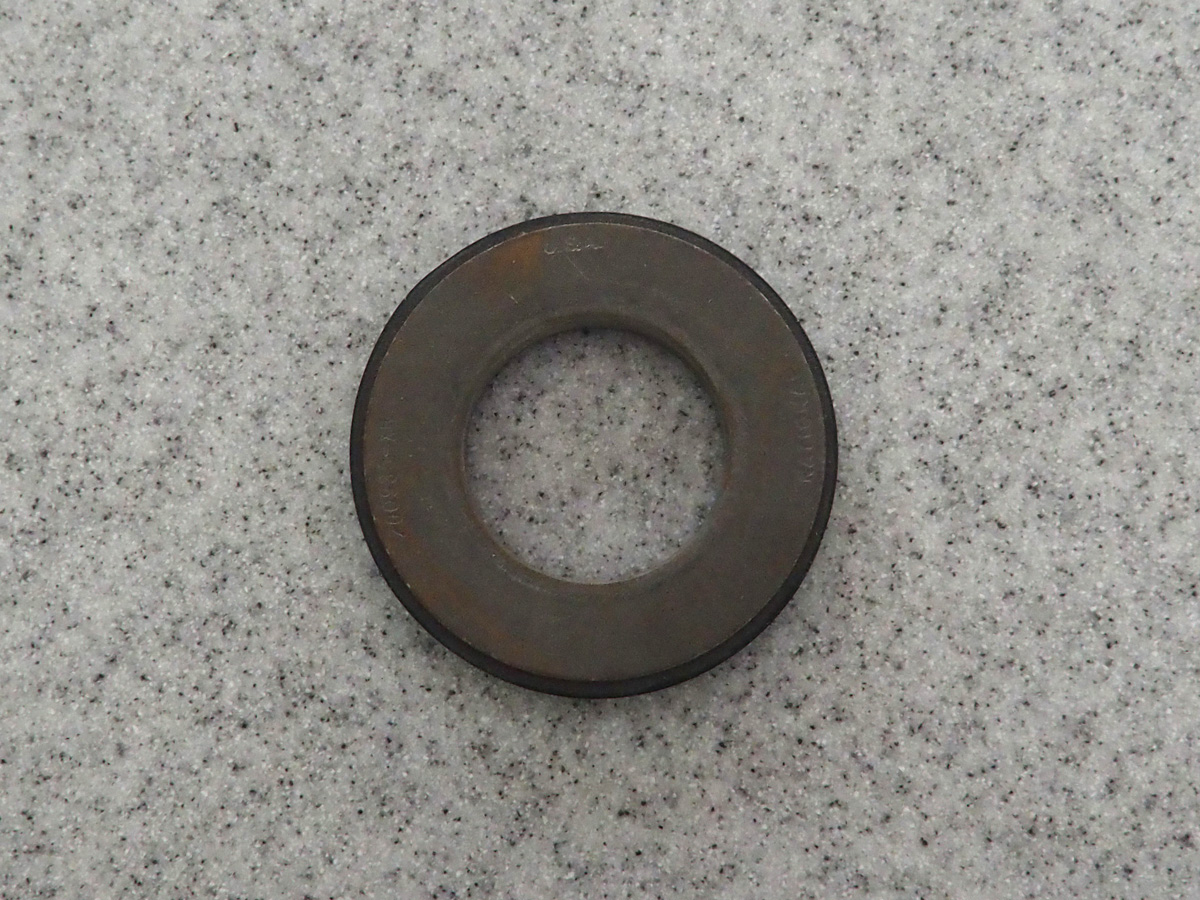

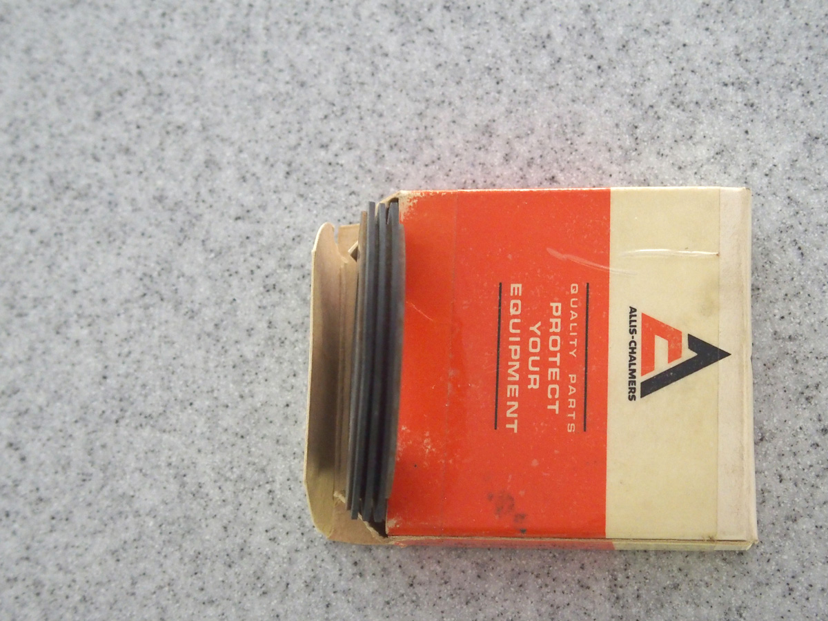

Joe (and everybody),
I have a couple of NOS Front Hub Seals (Part # 800445) that I got on eBay years ago. These are not the same construction as the original seals that came with the tractor. They are a National 200935-XB which I can find no mention of on the Interweb.

Post Options Post Options   Thanks (0) Thanks(0)   Quote JoeM(GA) Quote  Post ReplyReply Direct Link To This Post Posted: 11 Jan 2017 at 3:01pm
I've seen those, and the ones with felt instead of the rubber
