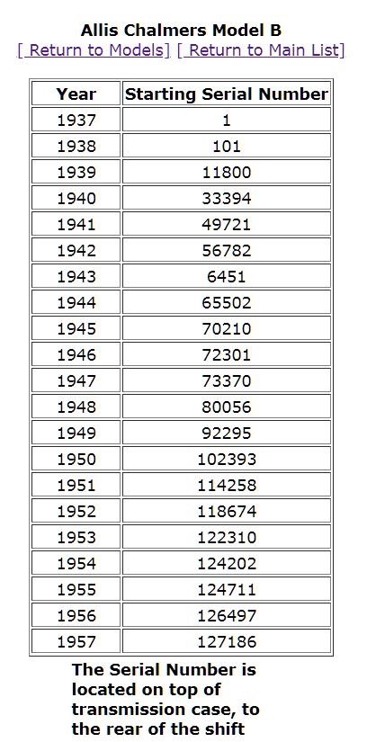

DR. Allis, Thanks for the quick reply. I might have misled you. The tractor no. on my tractor is E25557. The serial number chart shows E255581 as a 1935. Says the last number after the 5s is the total made that year. Hood has surface rust so there are no visible numbers or words.

Post Options Post Options   Thanks (0) Thanks(0)   Quote steve(ill) Quote  Post ReplyReply Direct Link To This Post Posted: 19 Oct 2022 at 1:06pm
what serial number chart are you using ?  There were no "B" tractors in 1935 ...
Allis made some kits and later complete tractors in England ( 1940s) and the serial numbers started with an "E" instead of a "B" ........... but none in 1935.

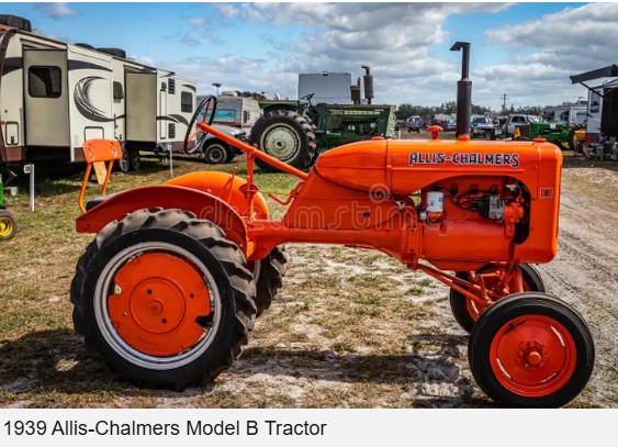

this is what an Allis B looks like....are you sure your tractor is ALLIS ?  and what Number Chart are you referring to ?
The Serial Number for the B would be Stamped into the Transmission Case next to the shift lever...

Allis 1930s tractor models..

Sorry for confusion. The number stamped on transmission is B25557

Post Options Post Options   Thanks (0) Thanks(0)   Quote steve(ill) Quote  Post ReplyReply Direct Link To This Post Posted: 21 Oct 2022 at 1:13pm
GREAT !!............ the engine serial numbers on the LATER units were on the flange that bolts to the bell housing on the LEFT SIDE of the motor.... the serial numbers for the EARLY models were stamped on the TOP and probably not visable with the gas tank and mount in the way.  Early model motors would be BE ( 116 inch) and later would be CE ( 125 inch).
