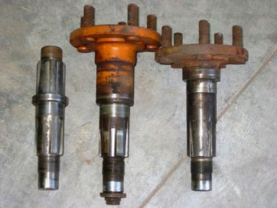

The axles are different, the studs are the same. The two axles on the left are B axles, the axle on the right is a C axle. You should be able to press the studs out of a parts C and use them on your B.
