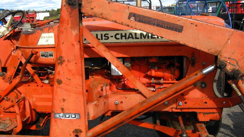

Hello, I recently picked up a model 400 loader that was on a D17 that I would like to install on my D17. After doing some research I found that this loader is the universal fit model 400 and not the model 417 that was designed to fit the D17. The only mounting issue is there is no angle iron brackets going from the mid mount area of the loader frame to the rear axle. They just have the lower cross bar clamped to the mid section of the tractor. I don't think that's strong enough to hold up. I want to build rear brackets like a model 417 loader used. I've seen pictures of them. I can cut out the angle iron and make them. The only thing I need help with is what size the angle iron is supposed to be. It looks like 3" x 3" x 1/2". Would someone be kind enough to measure theirs and reply with the dimensions? Thanks in advance.

No difference between 400, 415, 417 loaders - the loaders themselves are all the same, just the mountings are different depending on the tractor it is going on.
The 400 loader I had on my D15 had braces going to the back axle as well as on the frame rails.
