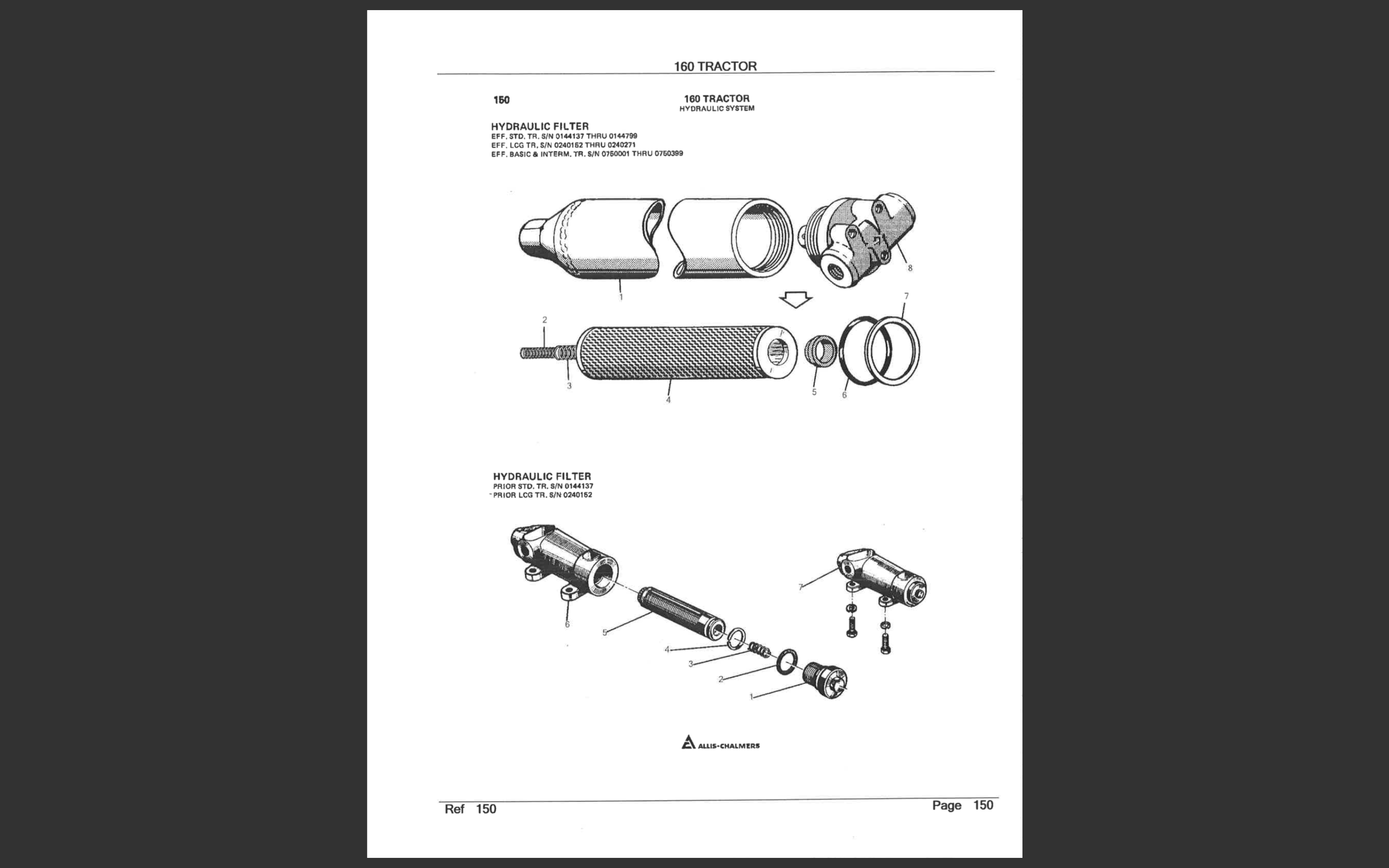

After talking with all of the vendors listed, Minnpar was the only one that could successfully map the correct part numbers and find the high pressure hydraulic filter.  The correct part number for the filter element is 72074088 and a new O-ring to go with it is part number 70929242.  Only cost $45 but minimum order of $50.  They were very helpful.  Put this out there in case someone else needs to find it.

NOTE: The part number listed earlier in this chain: 72074423 is for the low pressure, suction side hydraulic screen filter.

I would have never found what I was looking for without your help - much appreciated.  According to the 3 different vendors I contacted that part number referenced the strainer on the low pressure side but they all said it actually referenced 2 things so that may explain the discrepancy.  See attached pictures for the info and part I found.  Mine was the 1st version shown.  NOTE: Pictures are large so you will have to scroll to see them as the grey shown below is just the left side of the picture.
