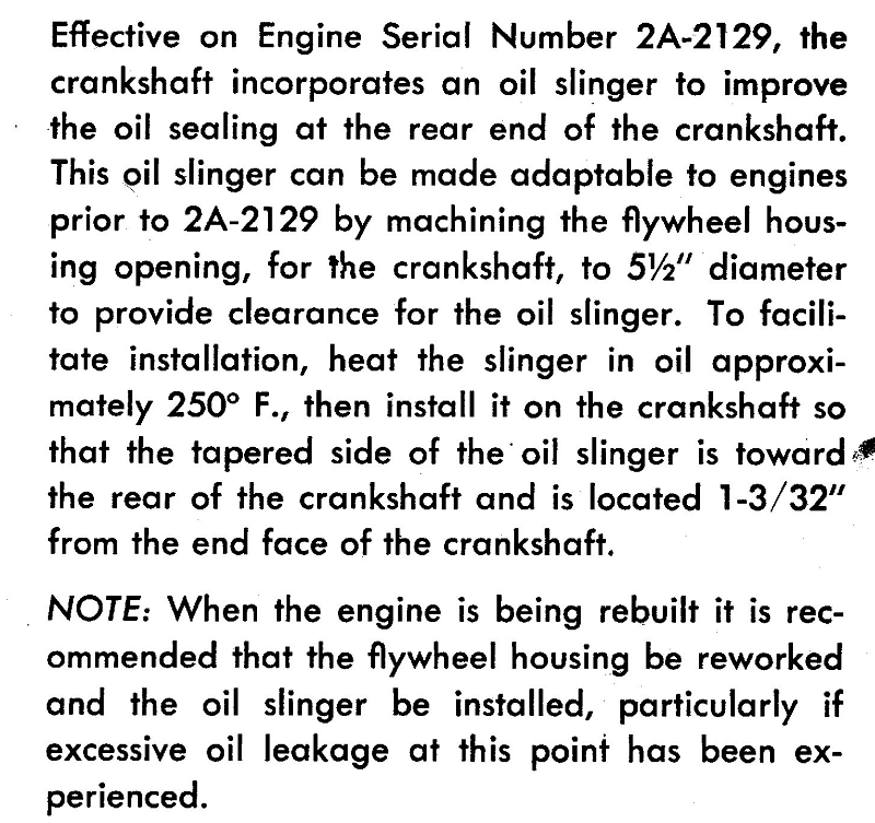

This may have a lot to do with it.

Post Options Post Options   Thanks (0) Thanks(0)   Quote WaltDevore Quote  Post ReplyReply Direct Link To This Post Posted: 18 Jul 2021 at 12:12am
They don't tell you that in putting that bushing on that the flywheel housing needs to be machined oversize, I believe.  If I can trim it down, get the flywheel on, oil that bushing well before hand against the flywheel housing, hopefully the torque of the starter will grind a little clearance between the bushing and the flywheel cover.
Looking at this picture, there seems to be no space for the bushing through the housing.

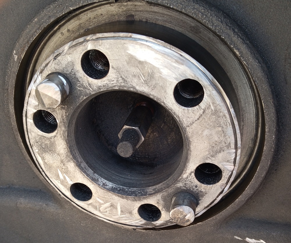

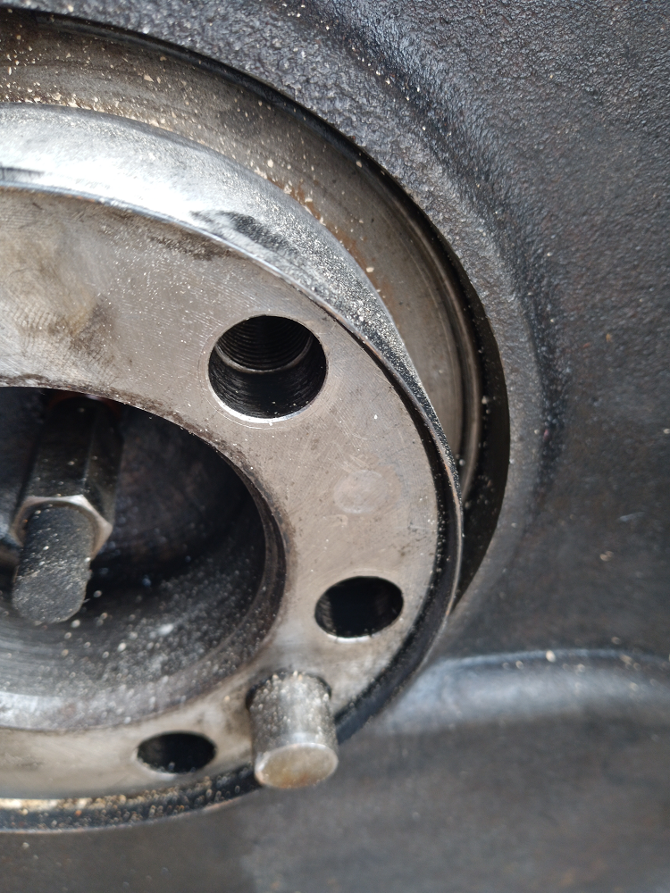

Post Options Post Options   Thanks (0) Thanks(0)   Quote WaltDevore Quote  Post ReplyReply Direct Link To This Post Posted: 18 Jul 2021 at 9:11pm
My art work after grinding and cutting it down. Cannot for life of me get oil seal installed.  Stymied again.

not the best appearing but should work, and saves a mountain of time and more work.  i would takes some emery cloth and dress the leading edge so as to not damage the seal on install, but since you posted about trouble installing the seal I have commented too late.  of course you may have already done this.Big smile
Points: 90746
Post Options Post Options   Thanks (0) Thanks(0)   Quote steve(ill) Quote  Post ReplyReply Direct Link To This Post Posted: 19 Jul 2021 at 5:32pm
the sleeve has a sharp 90 degree edge.. It should be rolled or tapered at an angle so the seal can start, then slide up onto the new  OD.

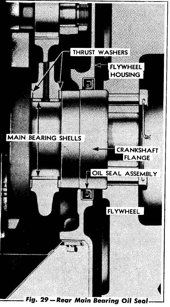

Points: 90746
Post Options Post Options   Thanks (0) Thanks(0)   Quote steve(ill) Quote  Post ReplyReply Direct Link To This Post Posted: 20 Jul 2021 at 9:08am
your picture from the service manual shows that the flywheel might  PILOT onto the first 1/8 inch of  shaft where the new sleeve is setting ?   Better check that.
