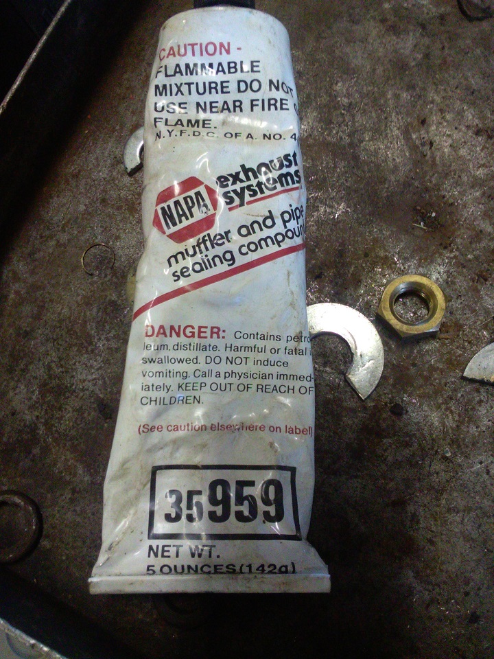

This exhaust sealer is what I used on my wd45 and both d17's.It serves two purposes,holds the gaskets in place when installing the manifold and compensates for any minor pitting.I used a felpro gasket kit from NAPA(part number FPG MS86053) on all three tractors.Retorque after two cool down cycles.I used the brass nuts with high temp nickel anti-sieze. (20 ft lb is the spec from 45 service manual) The 45 was done roughly 9 years ago and still no leaks.

It's a new after market one i already ordered it and it's here thanks for the heads up on napa sealer..

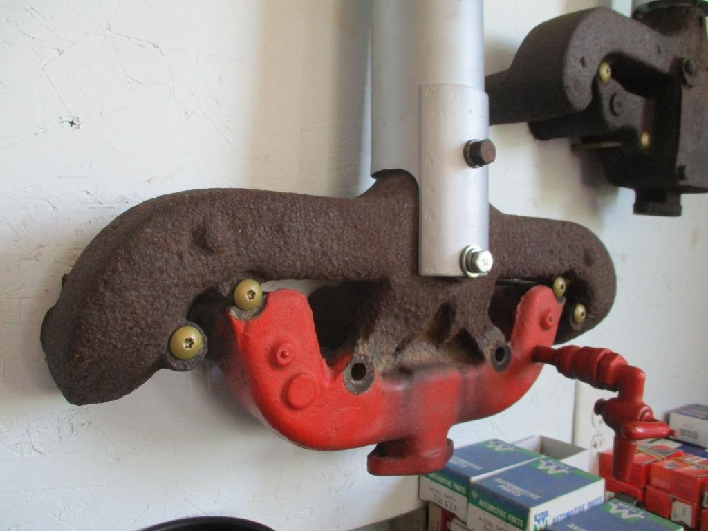

This is the good muffler mounted on an original manifold. If your muffler doesn't have the integral mounting flange, it should have the separate flange that bolts on the manifold and the clamp holds the muffler to it.
www.awtractor.com

Then mine is defenetly the Stanley Alex 09 you wouldn't happen to have the actual part number of the muffler in pic please
The A-C part # is 229531 for that muffler
