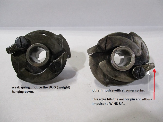

Well, had some success this morning... Basically EVERYONE is right.  I have heard for years that a mag impulse will not work on 12v because is spins too fast.. Others have had good luck with the mag on 12 v ... WHY ?
I took the mag off and tried to "SPIN" the impulse with my hand. It should only turn 180 degrees and then the DOG catches on the impulse and you have to wind up the BIG SPRING..  What i found is i could try to SPIN the impulse and about 1/3 of the time it did not catch, or went  a full revolution and then would catch.
Took the impulse off the mag and looked at the weights (dogs) that fly out under centrifigual force. They were not firmly seated against the center stop. I could SHAKE the impulse in my hand and watch the weights bounce around !  ???   Most of you know, but for those that do not, the impulse and DOGS work like a rotor on a distributor.  As you spin it, the weights fly out for timing advance. Springs hold the weights in a no speed or LOW speed.  My springs were obviously SHOT / WEAK.
I had an old FM mag of an International that i could not use because the impulse was TIMED different than on an Allis. I took the impulse off that mag and noted the weights were SMALLER and the springs were TIGHTER..  WHY ?  ....
I took the two small springs off the International mag impulse and put them onto my Allis mag impulse... I shook it and they did not move. I mounted the impulse in the drill press and spun it about 300 rpm and i could see the Weights move OUT , pulling on the springs..  Put the mag back on the tractor and it FIRED UP on ONE revolution like it has been doing for the last 10 years..
SUMMARY ......  OLD springs can get weak and not hold the impulse retarded so the mag will fire at TDC..... NEW springs can fix that.... What i dont know is if there are DIFFERENT springs for some FM mags ?   Did any International ever use a 12v system with a FM Mag ?  If so, they might have had stronger springs.... Physically the springs dont look much different, just a little stronger..

What i do know is my 70 year old springs were SHOT... If i ever need a set, i think im going to break down and call Rachel for a new unit..
