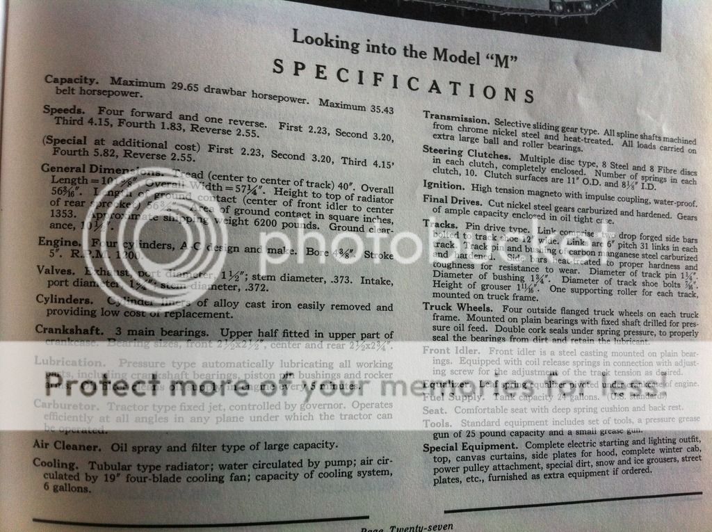

Post Options Post Options   Thanks (0) Thanks(0)   Quote Leesok Quote  Post ReplyReply Direct Link To This Post Posted: 01 Dec 2015 at 6:17pm

Leesok: - Perfect - appreciate the excellent information.  That explains everything that I was researching.
Thanks very much!

Any one spot the mistake on the spec sheet?

The speeds are screwed up.

The spec sheet is from this book.
It list and gives specs for their tractors, crawlers, plows and implements available in 1935. Specs would be for 35 and prior models. It also has the Rumely 6 and AC Rumely thrashers and combines.
