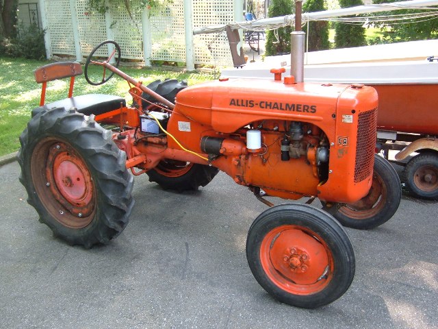

My winter project has been building a low B with a Woods 306 Belly mower.
I got it out today and did some test mowing.

I like it. Can we see more pictures?

And where did you get that hydraulic cylinder?

Looks very cool Bill! How did it mow for ya? Steve IL has a low rider B model also which is pretty cool lookin'. Neat job he did on that to. More pics Bill please!

I got it on CL in the Springfield Mo. area.
I bought the cylinder from www.surpluscenter.com big selection.

Neat, would like some info on the starter mod.

Looks like you fabbed up quite a few brackets.  Nice job.
You take the starter apart and remove the button that is under the pull switch, add a stud in it's place and wire up the solenoid with a key switch or a push button.

Steve, It mowed well, but with the 6' mower it is all the engine can do, it's a BE engine, don't know if it has 125 bore kit.
I'd like to put a 149ci engine in it, maybe from a D14.
Chuck, you can do the starter like Tucker said. I think I used a D10 starter I had and put on a solinoid and starter button.
Texas, yes I did a lot of fabrication as there are no brackets etc from Woods for a low B.
Bill B

Thanks, looking for ideas for my low B

Yeah, forgot to mention. Nice bracket fabbin' Bill. Them's some mighty nice lookin' brackets! Nice engineering job! Have fun with that puppy!

Kool! Tractor has a nice look to it for sure. I like nice fab work and your work looks A-1. Years ago I saw a pic of a similar job done with a model C and the fellow even added a live drive for the mower by going up inthe flywheel housing with a cog belt.
