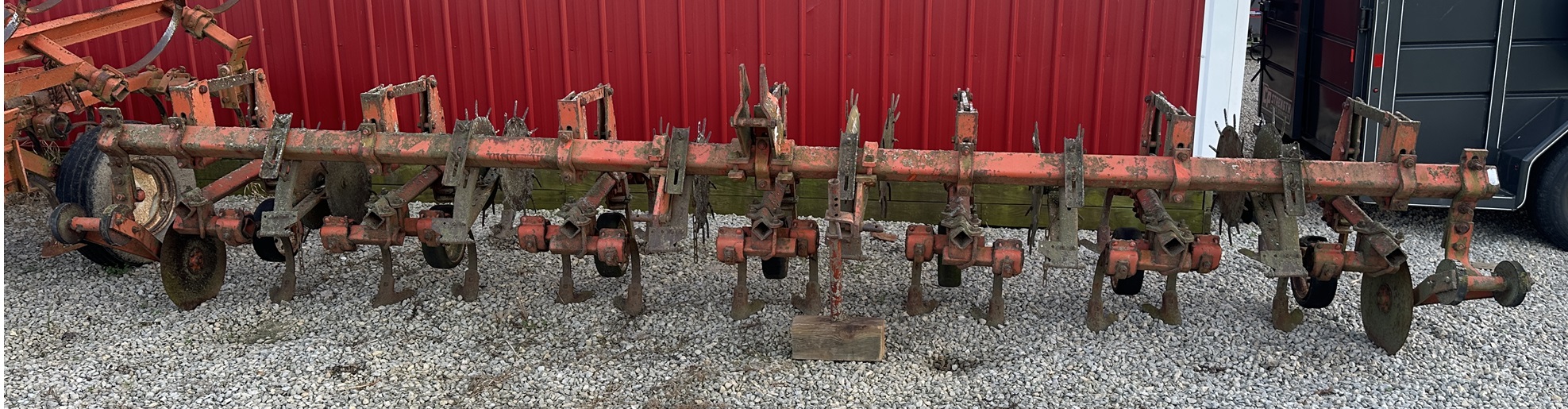

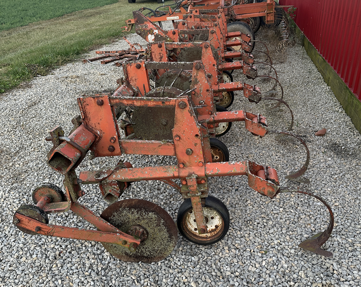

Going to look at and probably buy an Allis Row cultivator today. I played around with AI and it thinks its likely a 6000 or 8000 cultivator, but I don't know much about them or any cultivating in general. Grandpa went no-till in the early 2000s, and I'm not sure the last time any cultivating was done in the family. They (great grandpa) used to use my Farmall H with a mounted cultivator way back. Dad and I are back to turning dirt, and in in effort to get some cost savings on chemicals and such I plan to give this a try. We chisel plow in the fall, and run an AC 1200 FC in the spring with a harrowgator behind it. Then plant with a 6 row 7000 JD. Hoping to cultivate Corn and soybeans. Ill get pics of this thing when i get it home, From the pics I can see it has rolling shields on it. Im looking for advice on how to set it, how to run it, stories from days gone by, anything. Likely to run it on it on our Massey 2607H (MFWD) or the 6080(2wd). Our 8010 is also on 30 inch centers

Ill have to get a picture of it once I get it unloaded and washed off, but it is a Model 90 according to the sticker on the frame. Cant seem to find much about it, even on the Agco Parts book. Mine has the rubber mounted shanks like our 1200 FC has on it. I did read about the Buffalo Cultivators I think yesterday, as a cultivator set up for heavier residue. Im hoping this cultivator will work good for most of our used assuming we chisel in the fall and bury most of the residue. I havent seen one of those for sale locally, cultivating is not a common practice around here anymore.

Finally remembered to take a picture of this thing to post on here. I think Ive narrowed it down to a model 93. Appears to be in good condition except for I need to find a replacement "tire" for one of the gauge wheels. I need to take a measurement of the wheel, hopefully its a 4in x 12in wheel. I can find several sources of tires for those. There's no Agco parts book listing for the 93 so that makes things a little harder to figure out. In fact I have not had much luck finding any information on this thing., I have bought an original op manual off ebay, need to read through it yet.
Edited by Rhoadesy_65 - 03 Oct 2025 at 2:02pm
