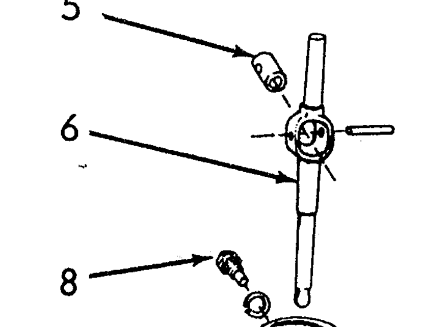

I’m needing the intermediate shifting shaft. If anyone has one for sale I would greatly appreciate it. Number 5 on the callout for parts diagram of the shift tower. Thank you in advance

I’m sorry all, it’s number 6 on the callout.
P/N: 098089
Or
P/N: 086705
It’s the whole lower shaft

Dont have the parts list handy - is that the part that fits into shift tower and has shift lever clamp to it ?
 The part that actually moves the shift rails in trany - ball type end and , pivot point center and round shaft through shift boot

Yes, its the lower shaft that actually sit inside the transmission and has a big oval hole through it which is where the bushing goes. I will see if i can add a picture

My PDF version of the HD5/6 transmission parts book shows that as being called the "LEVER, shift" and is P/N 7086705.
I put about 40 hours into rebuilding that part on my Son-in-laws HD5G, mostly by brazing and hand filing; I documented it on a thread several years ago. It would be quite a challenge to fabricate one from scratch.
The intermediate shaft is something else entirely.

I rebuilt that part by machining a new #5 part , then machining #8 bolt to fit into #5 , next replaced roll pin that goes through #5 to a larger pin and cut 2 slots in it to fit end of #8 which holds pin from moving = the actual shifter casting #6 was drilled to accept larger pin . the tension on the pin is controlled by installing washers on #8 to set depth it indexes into the pin .
 It removed all slop from shift lever and is positive shift now with no odd movement . I also welded up the ball end of the shaft and reground it to the flat sides increasing size to fit better into shift rails. Made a big difference in positive shift .
