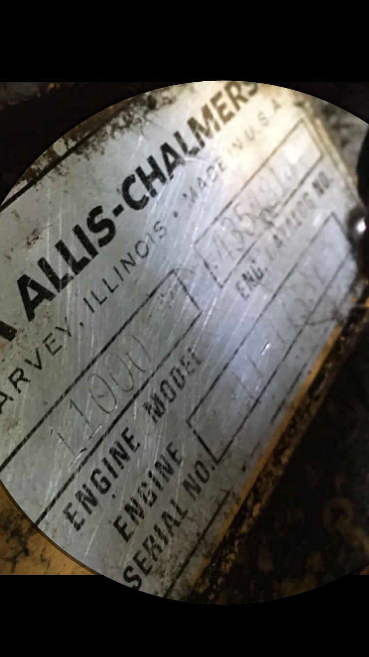

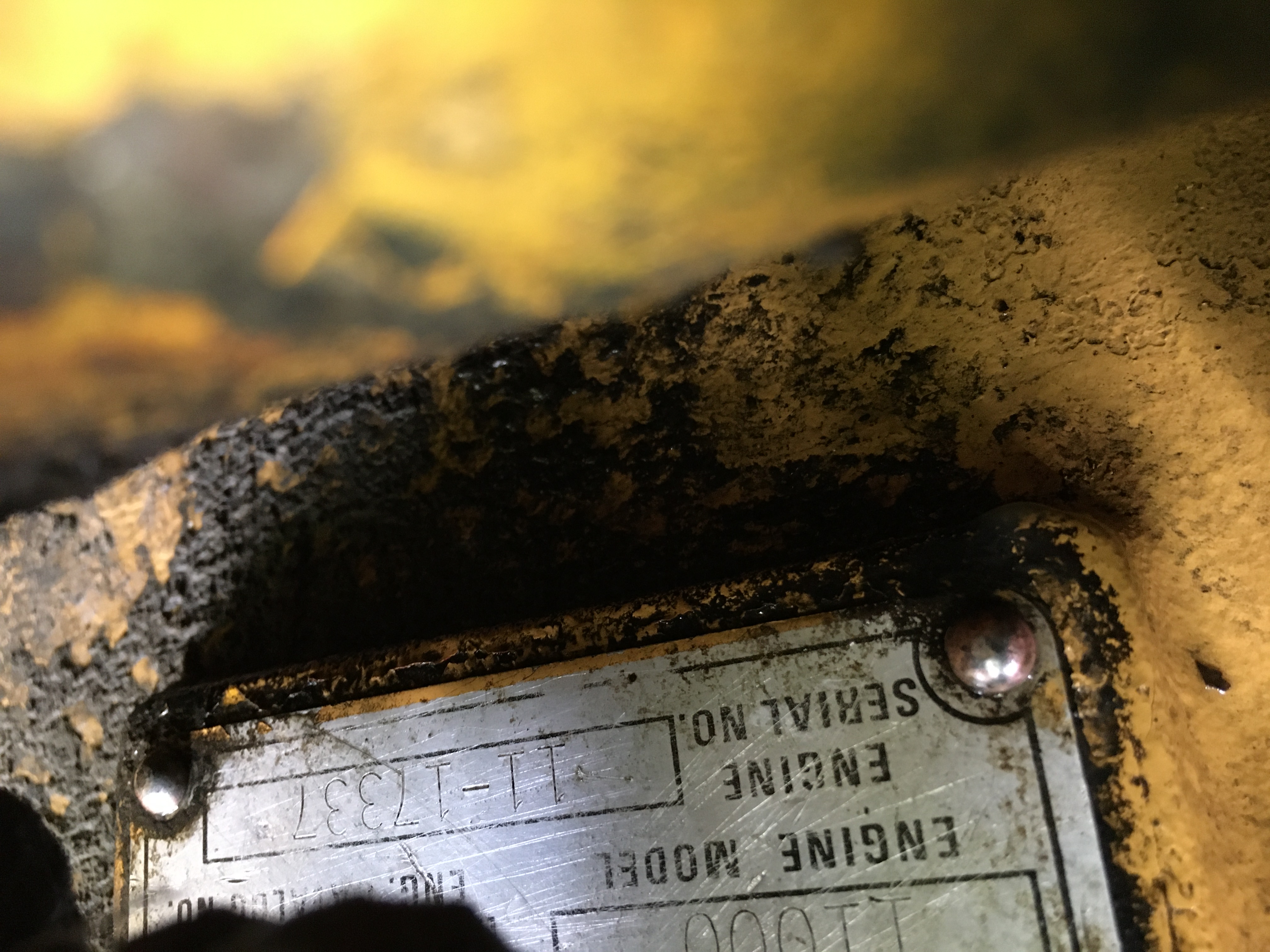

I’m helping a friend get his dozer running. It has set for 3 yrs. He said it was a beast before the trans went out. The trans was rebuilt and put back in and wasn’t touched since. The engine was rebuilt prior to the friend buying it. It’s in awesome shape. I’m trying to figure out the year and other info I can get. I have some free pdf files of different HD parts manuals, I would love to get ahold of the service manual for that model. I know the engine is a 11000, I would like to know what the other numbers mean. I have pics of the engine serial plate. The dash plate is gone but I have a pic of the serial number stamped on the rear. The engine plate numbers are, engine model 11000, engine serial 11-17337. Now for the dozer serial, it doesn’t look like anything anyone else has posted. It’s stamped HD11 305. My main concern for right now is what fluid to put in the transmission. I’ve read two different things, one said use 10wt and one said 80-90w would work. Which would be best? I want to do it right the first time. I already assume 80-90w goes in the bevel gear area.

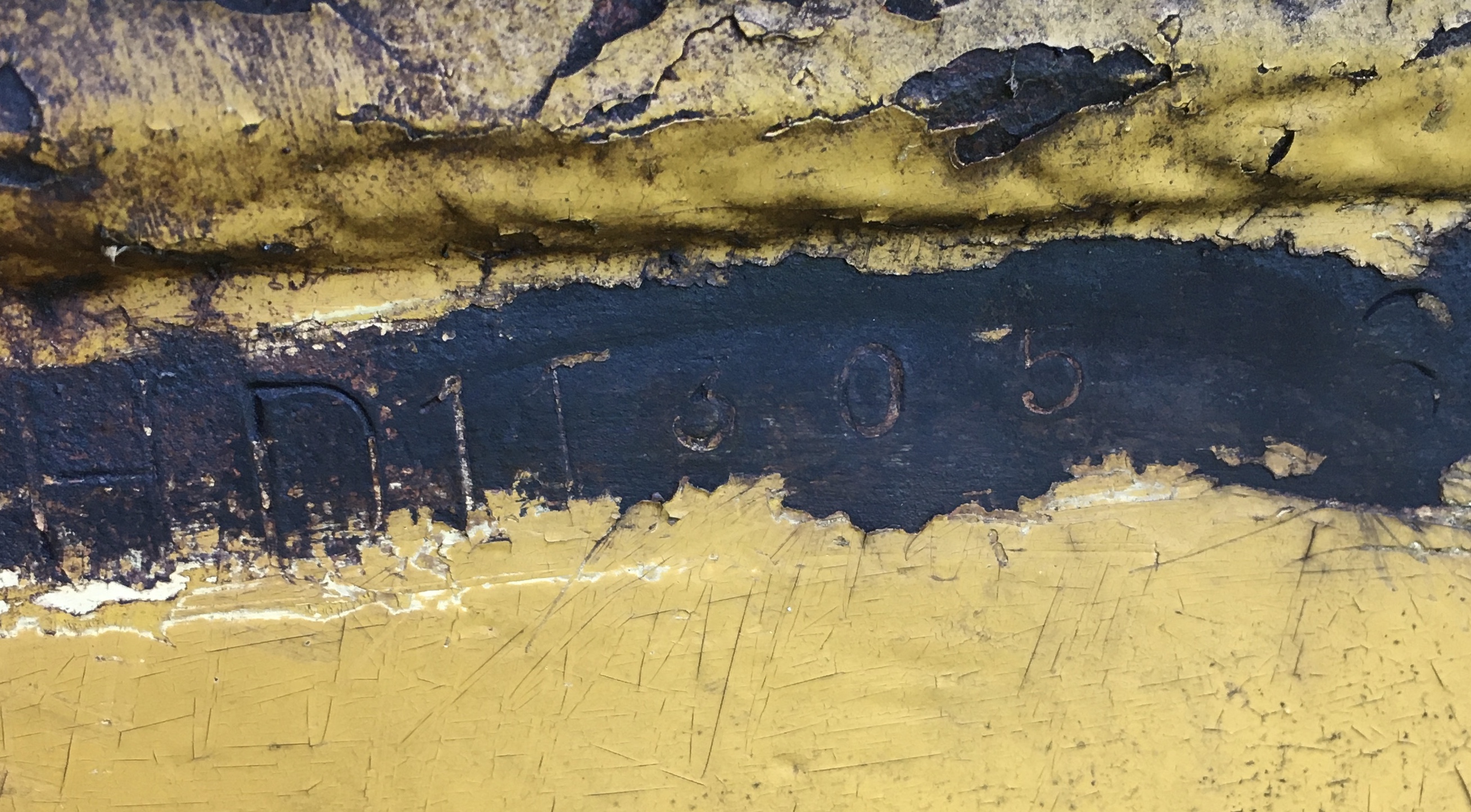

Notice the six on the far right of the dozer serial number. It’s bigger and a different style of stamp. Looks like someone took a grinder to it to read the numbers or something. I don’t think it’s deep enough to take off numbers though.

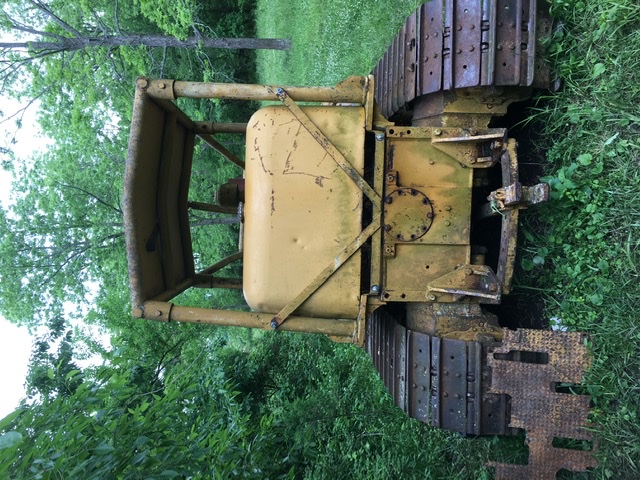

I’ll get more pics of the dozer and post them later. Thank you all in advance for your help.

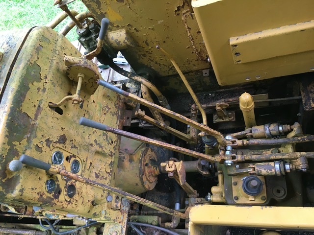

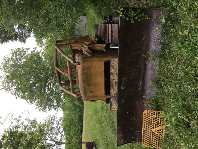

Put up some more pics of this HD11. You havn,t told us if its geardrive or powershift.
Also show some pics of the steering levers.
The engine serial number is similar to my HD11EP which is a 1970 model ; mines 11-17761. So engine is certainly 1970 era.
Chassis number doesn,t really make sense to me, so something strange going on there. I suspect it may have had a transplant with a later engine.

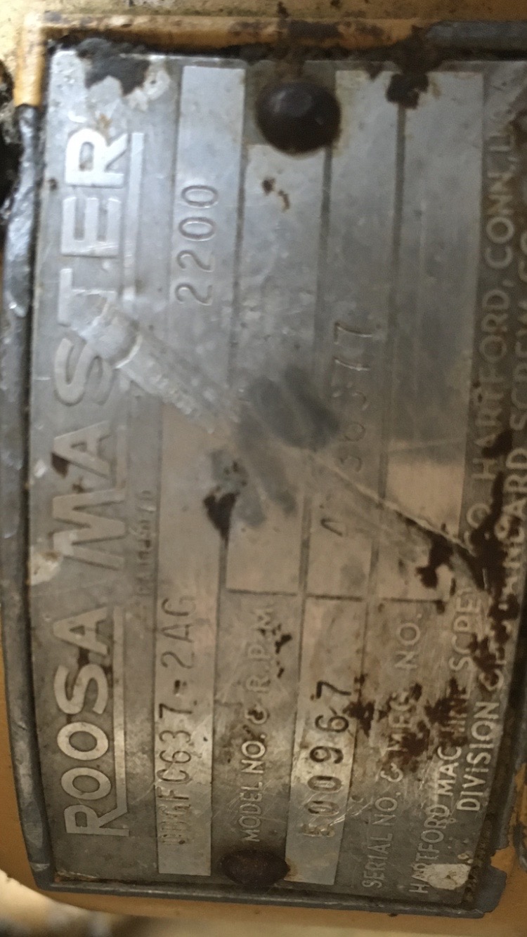

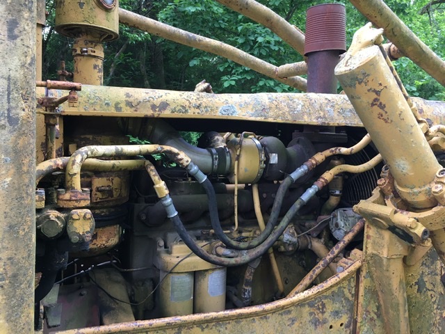

Thanks everyone great info. That’s exactly what I was thinking, an older machine with a newer engine. Also someone added a turbo. Worked on it last night, got it to fire up on starting fluid. We opened an injector to bleed air and nothing was coming from the injector pump. I know we are getting fuel to the pump. I know it’s a Roosa Master pump. I have a pdf of a parts manual for S/N 101 thru 12200. Does anyone have a service manual? Pics on the way.

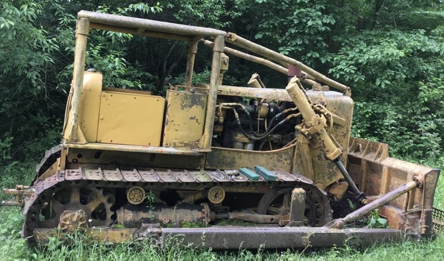

Someone definetly took a grinder to the rear housing to grind away the serial numbers. Its a early HD11B prior to serial number 6069. That has had a late 11000 engine fitted to it.
11000 engines are all turbocharged. 10000 engines were non turbo.
HD11B was short track frame; which it is, HD11E was long trackframe.
After 6069 they had power assisted dry steering clutchs. Yours is prior to this with the long steering levers.
Looks to still have the dry master clutch fitted.  But to your question about gearbox oil, can be sae 50 engine oil or 90 gearbox oil for it

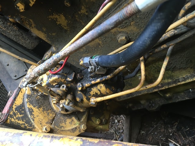

Thanks for the replies. Dozer will start will a couple shots of starting fluid, but won’t start on its own. Opened up all the lines on the injectors and not getting any fuel to come out. We took off the top cap of the pump and it’s full of fuel. Any suggestions? Thanks gemdozer I’ll send you an email and we can work out details.
gemdozer View Drop Down
Points: 1074
Post Options Post Options   Thanks (0) Thanks(0)   Quote gemdozer Quote  Post ReplyReply Direct Link To This Post Posted: 08 Jul 2020 at 5:57am
Did you check if the fuel tank is full fuel and if the valve is full open and if the line is't clogged in front and the motor was instaled on a other machine make sure the trottle rod is't opposite

Post Options Post Options   Thanks (0) Thanks(0)   Quote DozerD Quote  Post ReplyReply Direct Link To This Post Posted: 09 Jul 2020 at 12:06am
Tank is half full or more and valve is open. We have good flow of fuel up to the pump, just nothing out of it. We are getting power to the wire on the top cap. Just a thought. The first time I had the cap off I was looking at the parts inside, and the mechanism that is down and to the side of the throttle spring. It looks like it’s supposed to move so I tried to move it and it didn’t move, didn’t think about it either, figured it moved with the solenoid. I put it back together, we messed with it a while longer and got nothing out of it. So I said screw it and took the pump off, thinking it needs rebuilt. I took the top cap off again and was studying that mechanism again and figured out that solenoid lines up with that which would be part of the engine kill? Correct? So I then budged that thing with the tip of a screw driver it was stuck a tiny bit. I didn’t have to put much pressure on it. Now it moves freely by finger. So I put 2 and 2 together that is part of the fuel shut off that is kicked off by that solenoid. So now that i think I wasted all that time taking off the pump, all I had to do was break that free. I went to put the pump back on the shaft I noticed one of the little umbrella gaskets looks a little rough. I guess that’s where I’m at now, ordering shaft seals.
Points: 8978
Post Options Post Options   Thanks (0) Thanks(0)   Quote SteveM C/IL Quote  Post ReplyReply Direct Link To This Post Posted: 10 Jul 2020 at 1:28pm
be gentle/careful installing pump over umbrella seals.don't roll the lip or fuel will fill the crankcase
