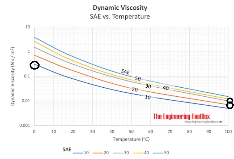

More on what LARS was saying.. Here is a graph that shows the oil viscosity vs TEMP... to the left is COLD ENGINE... to the right is HOT ENGINE... Note that the 10w oil when COLD is thicker than the 20 or 30 wt oil when HOT....
Switching from 5w20 to 5W30 will gain you a little bit of viscosity when HOT and may be enough to fix the low psi problem.. Switching to 10w30 will gain you viscosity at IDLE and all the way up the RPM range until you get to operating temp..
The 5W30 would be an EASY test as you just get a little more PSI at HOT ENGINE... but not much difference from COLD as the engine warms up thru the range.. If you want a LITTLE MORE EVERYWHERE... then the 10w30 would be a good bet.
Going to 15w40 or 20w50  is NOT a good idea... too much change at the COLD END.(for a NEWER VCT engine).. and some advantage at the HOT end. ( unless you are in south Texas and the "COLD" is 70 degrees F ) .... note the curve is in CELCIUS not Farenheit..
