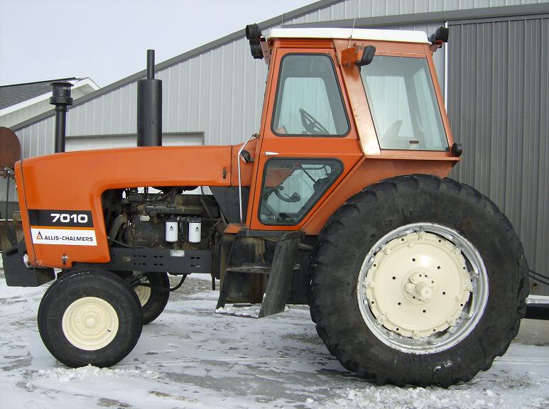

I attended a good farm auction near Alexis, IL (near quad cities) last February 2011.  This tractor pictured below sold for $7200.  It was an AC 7010 with 4750 hrs and I believe it had the power director transmission.  It was in good running condition.
