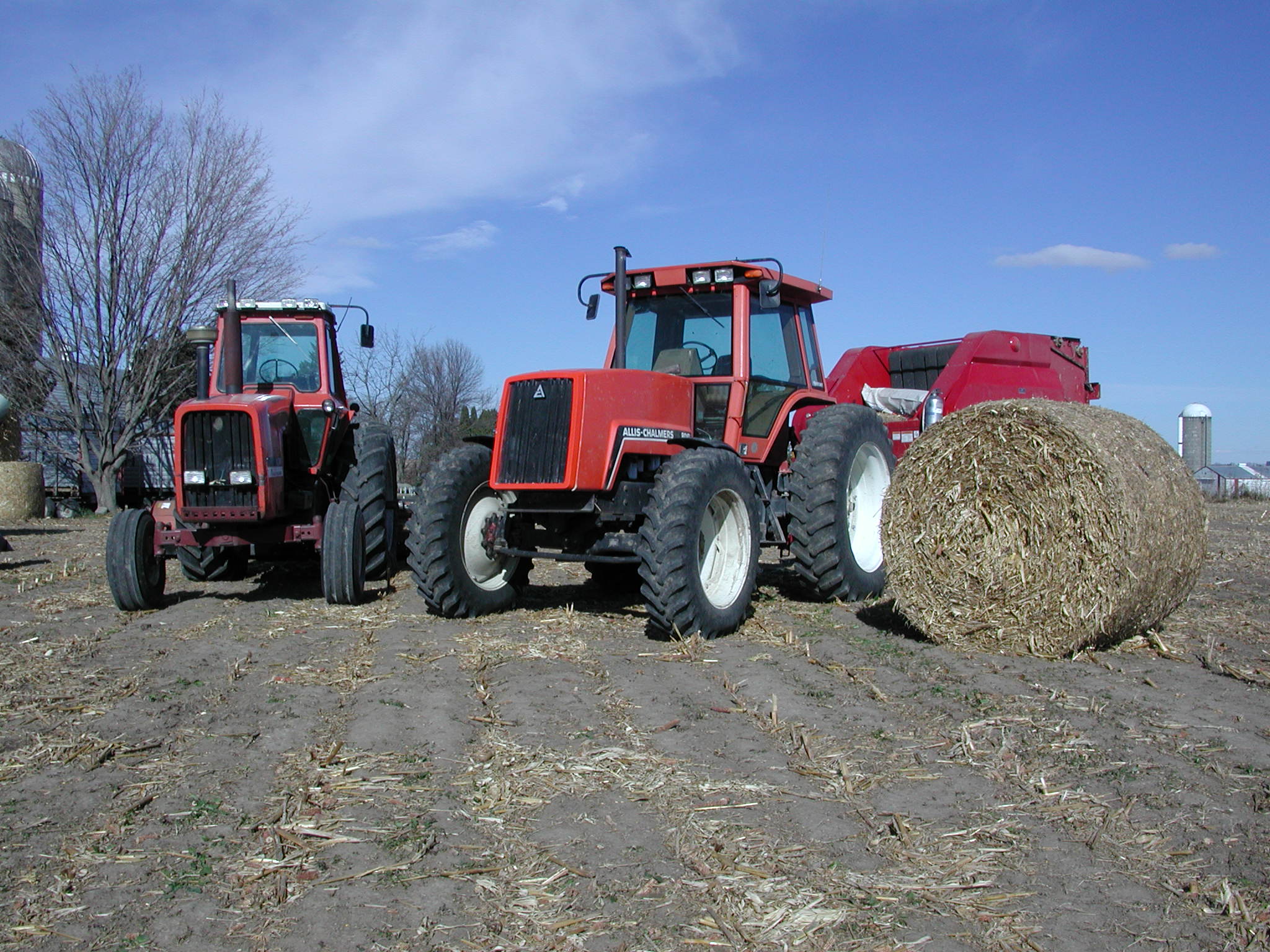

I did it to my 8010 in April 2009.  Moved axle ahead 14" so it now has a 110" wheel base.  That along with the wide tread setting of 84" front and 90" rear and switching to larger RADIAL tires has made it a super tractor for round baling and spraying (when spraying with 3pt sprayer I straddle 3-30" rows).  It takes more room to turn with the axle ahead and with the larger tires I can't really go less than a 78" front tread without setting the steering stops or hitting the frame and hood panels.

I'd have to go look again.Seemed to me that there would be clearance issue on something with the axle to just turn it around.Maybe I wasn't visualizing it right.I'll look again.
  Redline how much longer was it?I can't "measure" it in the picture.

It lengthened the w/b about 11 inches, if I remember right. The steering cylinder mount was moved away from the axle tube a little (toward rear axle) for some reason and the long tie rod that connects the steering arms was arched to clear it and reinforced. The hydraulic hoses were extended and the bracing in front was reconfigured to fit closer to the axle tube. It was a pretty involved conversion, but I think the kit from John Day was simpler. I never saw one, but it sounded much less complex.

I did this a couple years ago to our 8050.
Then we put on a set or 20.8r42's and 16.9r28's.

Peterson, that looks like the tractor that caused quite a stir on a diff forum a while back, looks good. I would do that with my 8050 mfd but I love the short turning radius... Mike

Yeah that was me. lol We have a 8070 and 8030 that are still in the stock spot. When i drive this one i cant tell the difference in the turning at all. It is not that much more. And if you need to turn alittle shorter just tap the brakes alittle.
