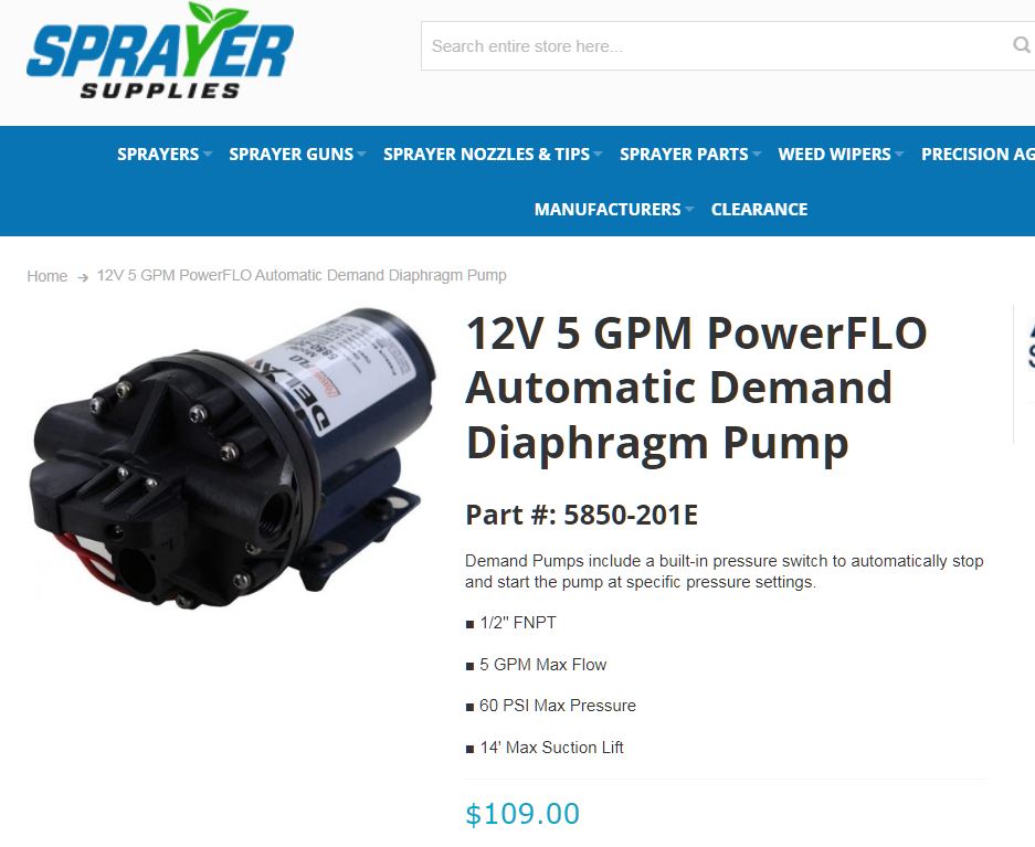

Post Options Post Options   Thanks (0) Thanks(0)   Quote steve(ill) Quote  Post ReplyReply Direct Link To This Post Posted: 16 Jun 2023 at 4:42pm
maybe something like this ??

I don't think one of the 12-volt electric pump units would work well to run a motor in the long run, I don't think they are intended for that type of duty cycle.

If your 60 gallon tank will last 12 minutes, then your pumping 5 GPM..... the electric pump above is 60 psi instead of your 90 psi... but for $110. it is a very simple "TEST" that might solve your problem ??

[QUOTE=steve(ill)]If your 60 gallon tank will last 12 minutes, then your pumping 5 GPM..... the electric pump above is 60 psi instead of your 90 psi... but for $110. it is a very simple "TEST" that might solve your problem ?? [/QUOTE
That would be effective and I will see how it does with the installed nozzles. I have others also for different chemicals or flow rates, but have not used them and they remain in the package. Demco has revised their online site and my sprayer type is discontinued, but they call it a rear mount 60 gallon type. The electric pump type offered is 5gpm @50psi, but I opted for the six roller cast iron pump and larger nozzles for more versatility. This pump easily reaches 100psi and will maintain it while washing the driveway with the hand wand as instance. I'm almost thinking it is a "Hy-Pro" pump as it is blue in color. Seems to me Delavan pumps are black.
Not much difference between this sprayer and a "Fimco" brand found at the local farm stores as both use "Tee-Jet" plumbing and nozzles, but the welded frame, and tank are of much better construction I feel. The agitator in the tank is very aggressive and keeps chemicals mixed well. It also empties completely when spraying. I may upgrade it to electric solenoid valves but for now I can easily reach the "on-off" flip lever while driving. I've looked at those solenoid valves and they are rather proud of them too.

Just a thought , if the Ford is working satisfactorily for running the spray boom ,add a 12V pump to run the hand wand. Tons cheaper than another tractor.   But I understand, on the fun of hunting for another tractor.
So far I have had better luck with Surflow than any of the other 12V pumps I have used. I really like using a 12V pump for running a hand wand.

This is a good idea Ray and plenty of room to incorporate the electric pump. I like everything about the sprayer very near 100%.
I'll see how much flow I am running through the spray wand at the 60psi I like and quite possibly order a pump to match performance.
I too have had the best luck with Shurflo pumps and have three of them. One is on my carpet extractor machine, and another on an evaporative cooler for use in the shop during summer. Third is a ready spare and they are all rated at 2.1gpm @ 100psi. These however are all 120VAC operation. I'll look further into the one Steve posted as that one may be the ticket also. I keep the sprayer inside the heated shop with RV anti-freeze in it so no corrosion or freezing to be concerned with.

Attached is a cut sheet from the pump series Steve posted. Typical of these small pumps the output flow diminishes rapidly as the discharge pressure, (or head) is increased:
And this is a cut sheet from a Remco pump which are sold in this area and are good pumps:
Both pumps are similar in performance so going to fill the sprayer and do some testing to establish a baseline.

With a calibrated 60psi spraying pressure during application, the hand wand moves 2.1gpm of product adjusted wide open for maximum flow. Evaluating the distance and spray pattern, this is acceptable from the tractor seat. With the larger nozzles installed the product dispensed is 4.4gpm through the spray bar. I did not test at 100psi and switching to the smaller nozzles in the spray bar yields 2.6gpm of product application @ 60psi. I do know from past experience quite a bit more product is applied through the spray bar with the larger nozzles and 100psi pressure as the tractor needs to move faster to avoid soaking. The spray bar has only been used for large open areas, and roadways; hence the larger nozzles. The smaller nozzles will be used for smaller gardens and such and not really to kill anything plant related. I have several friends with "food plots", (large gardens to me) I will be taking care of with this sprayer.
From this testing into a calibrated 10 gallon graduated burette, I'm thinking the 5gpm electric pump would work fine yielding approximately 3gpm @60psi and as Ray mentions, "a lot cheaper than another tractor".
Tractor has always been named "Hercules" and he now has a future with me again.

Stopped by the farm store this morning and picked up a 12VDC Remco 5gpm pump as shown above, a plastic "Tee" with a 3/4"X3/4"X3/4" pickoff point to attach to the spray wand pump inlet from the suction line of the roller pump, a 3/4"X1/2" reducer bushing and close nipple to connect to the hand wand pump inlet, and a 1/2"X3/8" hose barb to connect to the hand spray wand hose from the discharge side of the electric pump. This will eliminate the PTO need for hand application.
Still uncertain is whether I will need to incorporate a check valve into the suction side of the electric pump to keep the roller pump from cavitating or anything of the like. Need to test to ensure steady flow through the apparatus.
I have several "Crouse-Hinds", and "Cole-Hersee" brand environmentally sealed switches along with sealed relays with 12VDC coils so should be able to run and operate this setup quite easily and protected once I have a harness lined out.
More whether positive, or negative later.
