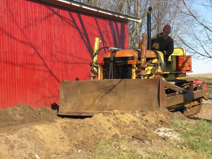

I have a similar blade that doesn't angle on my 7.  Sorry the first picture is so large.  It was taken quite a few years ago when I found it on a prehistoric digital camera.  I thought you might like to see how I reworked it for power tilt.  The lines are crisscrossed between rear cylinders and the valves.  It works great.

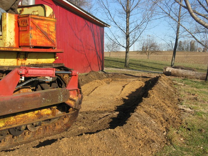

I thought I had a better picture of the rear cylinder mounts.  Here's the best I can find right now.  I made them out of 1" plate and burned them on in place of the turnbuckle mounts.
