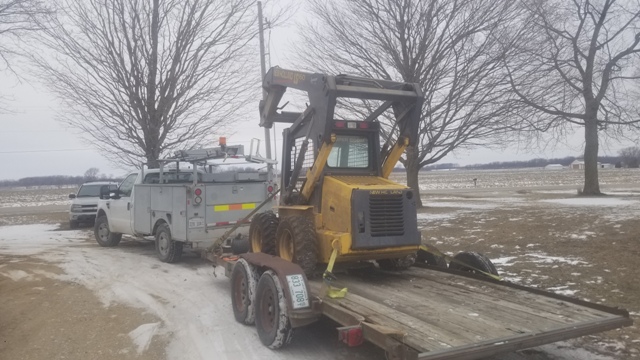

Forgot the load photo. Skid steer runs but has rodent/wiring issues so cannot unlock the foot pedals to drop boom. Hauled it about 16 miles like this but no issues:

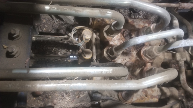

Broke into this machine yesterday and it's a retirement community for rodents, beetles, and other small animals. The belly pan is almost full of rodent nest which explains why there are electrical problems with the machine. The electronic instrument cluster, (EIC) is an absolute mess having a large rodent nest built against it for several years the machine has sat disused in a barn. The panel does not illuminate at all and this is the soft and hardware interface between human, and machine. Basically it has it's skinners into everything and needs to work for the machine to operate. Here are some quick shots after pulling the panel down:
Rodent nest around hydrostatic drive units. This is not the worst of it:

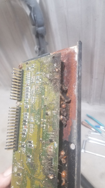

Post Options Post Options   Thanks (0) Thanks(0)   Quote Codger Quote  Post ReplyReply Direct Link To This Post Posted: 04 Feb 2026 at 11:43am

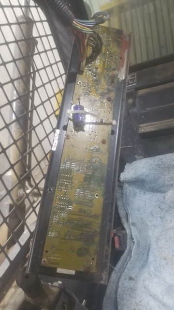

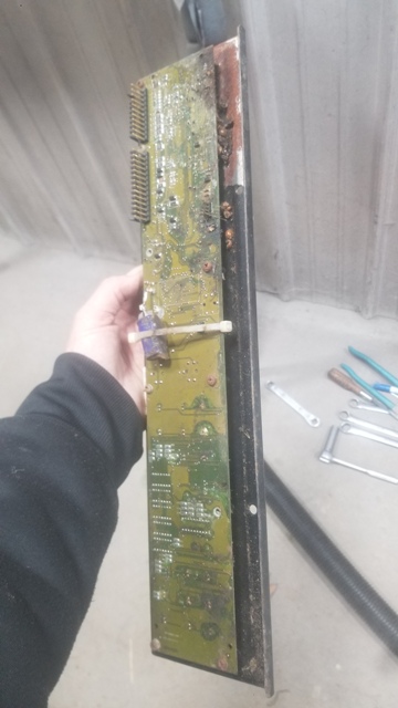

After cleaning up the board and finding a compromised prior repair to capacitor landings/terminations, I have a couple of lights present that should not be. That said however, I did find a control fuse in the engine compartment blown that is in series with this board so now have all five 12VDC power supply inputs present. Have a single ground present on a termination, but only six of 10 retention fasteners were present mounting the board to it's support structure in the machine. These fastener points were rusty and corroded so they were chased with a 6-32tpi tap and pads on board cleaned with isopropyl and a new, stiff poly brush. Much of the crap has been scrubbed and washed away leaving a clean surface. Have not found any compromised solder runs, nor microchip legs so hopefully a couple of ground wires running to the back of the machine, or their respective terminations are culprit. There seems to be gain had with this project.
I put a call into the dealer I help out with the board serial, model, and revision numbers which were perfectly legible after cleaning. I've asked for a print of the board circuitry so hopefully if they'll respond I can repair this long obsolete thing. A replacement type is over $1K in price so have some room to fiddle and this is kind of different and relaxing to me.

Post Options Post Options   Thanks (0) Thanks(0)   Quote jaybmiller Quote  Post ReplyReply Direct Link To This Post Posted: 04 Feb 2026 at 12:43pm
GREAT to hear PROGRESS !! Used to dread fixing  PC that mice had 'relocated to'.... Used to 'brushcut' 1" paint brushes for  PCB cleaning detail. Once 'clean' would use heat gun(aka hair dryer) to be dry it off, then do it again and once more.
Hopefully you've got real good pictures of the PCB, both sides as well as 'part numbers' on the it. For giggles, toss those number into Google, you might be surprised what comes up.
If the part numbers on the actual chips are easy to read,it'll help if you decide to 'reverse engineer' that board . Having actual wiring diagram of HOW it connects is vital to getting it up and running.

I did try google and found a few still available but in the stratosphere as far as pricing. Also found two places on the internet that state they can repair this but both are $1400+ for the servicem, so not really a contender.
Talked to the owner and they are alright with me incorporating relays, enable buttons, annuciator lamps, and digital/analog gauges in a new aluminum faceplate I can fashion. Don't think I'd have a hundred bucks in the job but do want to see if I can get this original board working first. Going to be ringing out a couple of harnesses that run throughout the ROPS roof that has had prior rodent damage this afternoon. Hopefully a compromised ground wire is all.

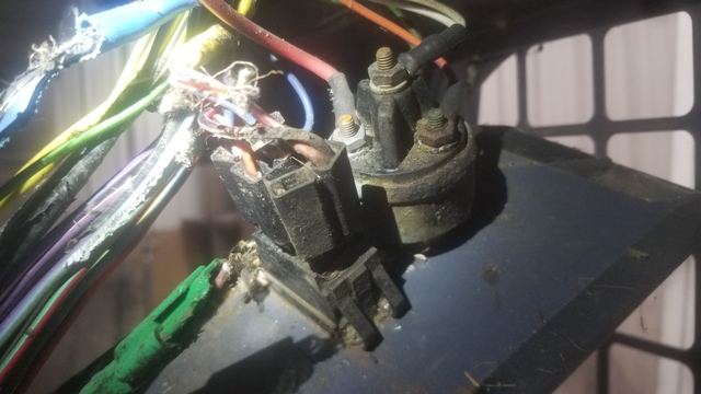

Have all five 12VDC inputs to the board and all grounds are present as should be. Calling the board bad at this point. In the research stages of building a new control panel and have a good portion of needs on hand already.

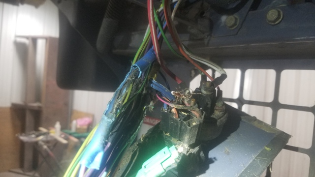

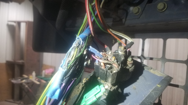

Dropped rest of control panel down and wiring damage is prevalent. Many of the wires with prior repairs are once again compromised. This would explain the lack of lighting in the machine. I cannot get a straight answer whether fuses have been replaced as there has been more than one set of fingers in the pie.
Ignition switch panel dropped down:
I'll get to repairing this later today but have a couple other small jobs to tend first. Starting to fall behind on this one but many times a can of worms once opened is like that.

New Holland responded back with "intellectual property" and cannot/will not provide a print of the CCA so kinda SOL with repairing the original board cost effectively. No worries with me as I'll be removing a single point of failure that puts a machine down and replacing with a logical, and easy to follow algorithmic start/run scenario.

Post Options Post Options   Thanks (0) Thanks(0)   Quote DMiller Quote  Post ReplyReply Direct Link To This Post Posted: Yesterday at 7:36am
Noticed Rust discoloring on Board Corner, it is possible the corrosion could make secondary circuit connections, make sure the Solder lines and circuit face are not compromised.
