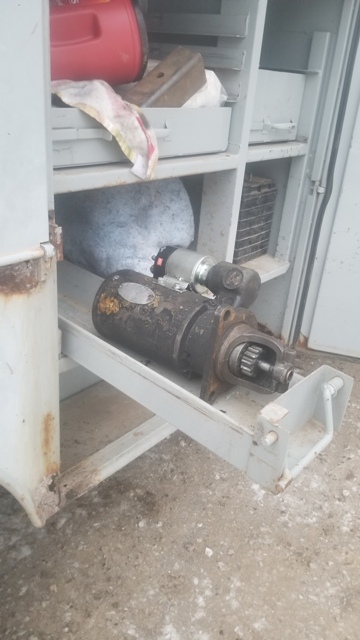

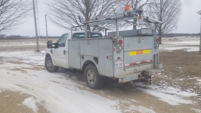

Put a few mile on and no problems at all. Topped up the cooling system again and then ran after a skid steer with my trailer hauling it back to the shop. All good so far.
Truck even has a starter dispenser I wasn't aware of:

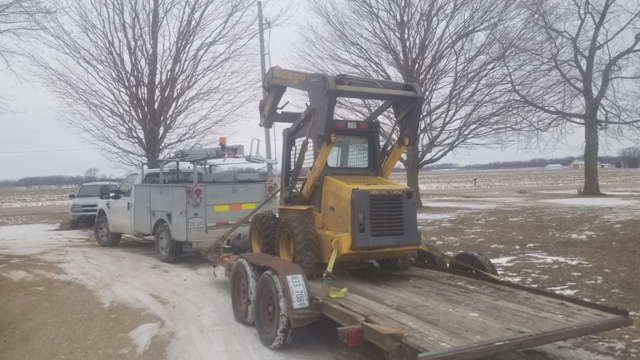

Forgot the load photo. Skid steer runs but has rodent/wiring issues so cannot unlock the foot pedals to drop boom. Hauled it about 16 miles like this but no issues:
