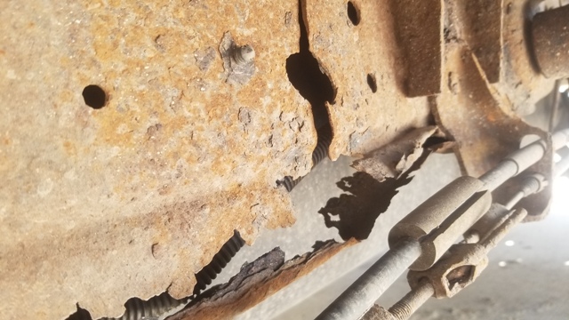

It's usually rust that puts vehicles down around here as I get very high mileage out of them though good routine maintenance. My purchased new 96 Dodge one ton has 247K on the clock and no frame left worth working with under it. Lower left control arm has rusted through and truck is sagging terribly on that side as it bends from lack of support strength also. This is the left side frame rail and the right is just as bad so no longer safe to operate:
I still have the truck but it will be broken apart at the end of March and go across the scales. Still has a very good interior, and driveline so maybe I'll pick something up down south and repower as I won't even consider new.
Have a 96 Chevy 1/2 ton that was brought over for a wiring issue due to rodents. After
removing the bed from the frame, it was found to be in almost the same condition so owner elected to not repair and donated the truck as has a very good running 4.3ltr V6 engine I'll repurpose into my manlift. Also have a 2000 F-250 4X4 diesel given me that runs very well, but same scenario with rust. Not worth working with. Gent only wants the snow plow and frame back. With this one I am actively seeking a truck to repower as I'd really like to help the guy out. Engine runs like a top with good history of maintenance.
All three of these "piles" are from long term customers of mine. I've done a lot of the maintenance routines along the way so know the chassis well; but rust never sleeps.

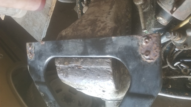

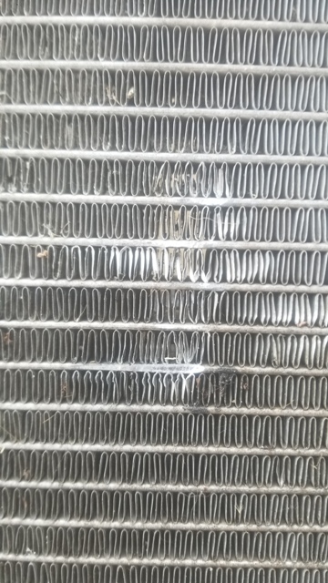

Rust; corroded the transmission oil cooler from it's mounts allowing it to drop and scrub a hole into the engine cooling radiator. Had the joy of changing it yesterday:

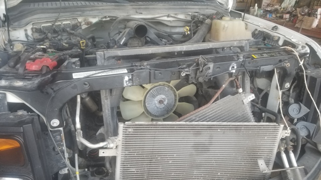

Compromise in radiator:
Lot of plastic to take loose, remove, and attempt to not break anything:

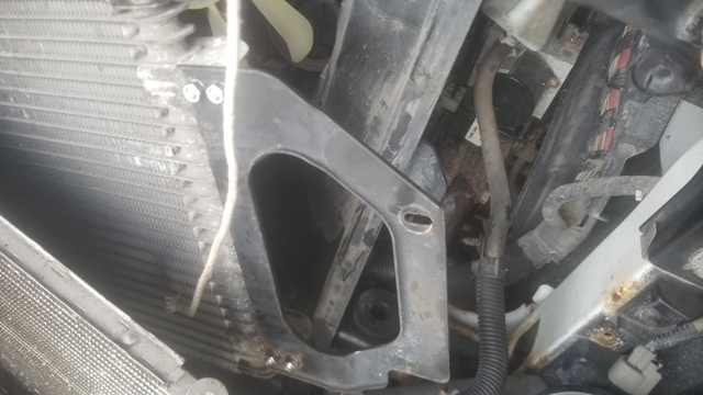

Cooler broke free from this bracket:
Cleaned it up along with the cooler ears themselves, (both sides) and replaced with stainless hardware. It should last the duration of the truck's lifespan. I could have repaired the radiator but truck is a 2008 and always in the rust belt, so replaced.
Bracket bolted to the cooler. Truck assembled shortly thereafter.
