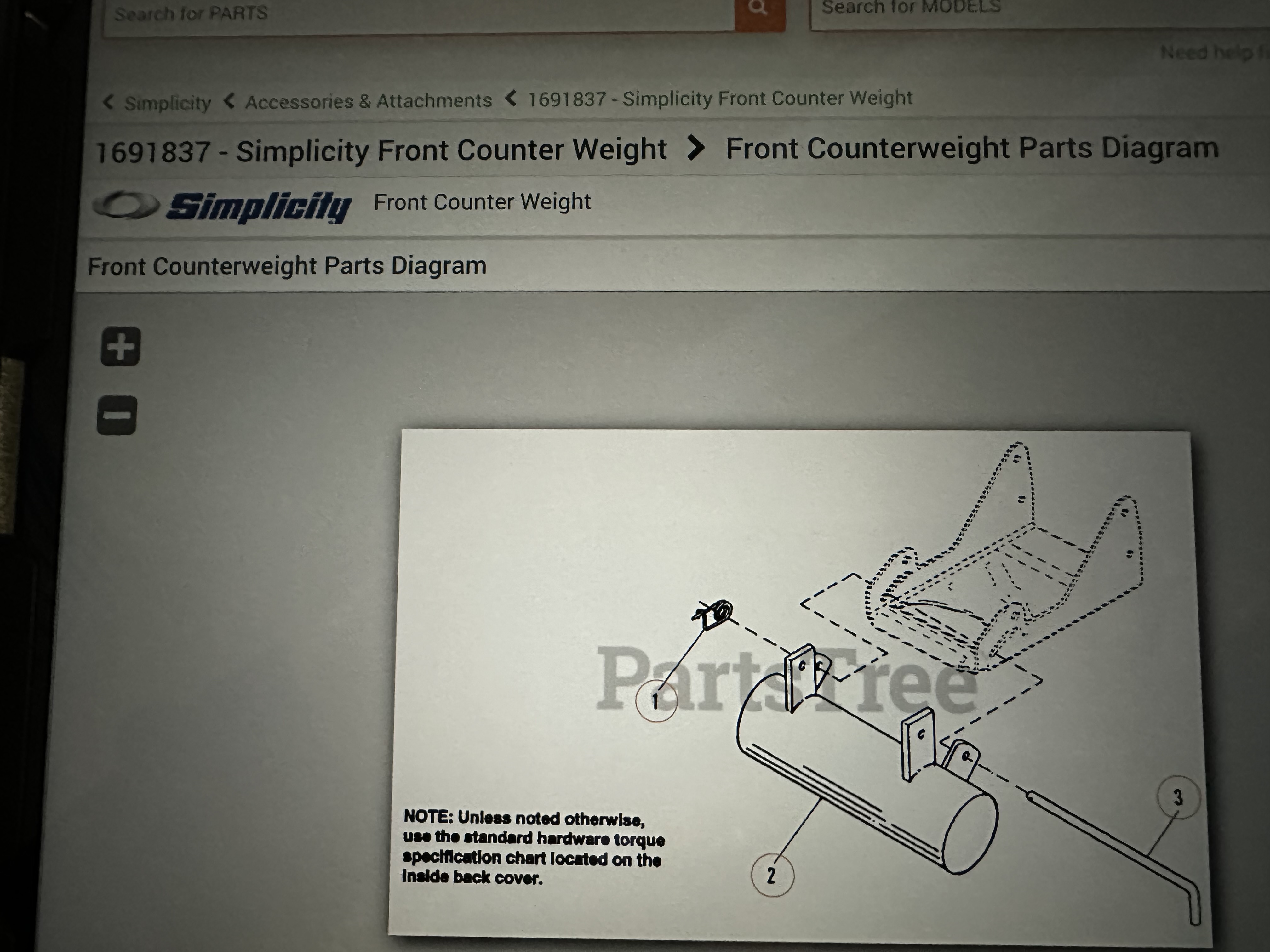

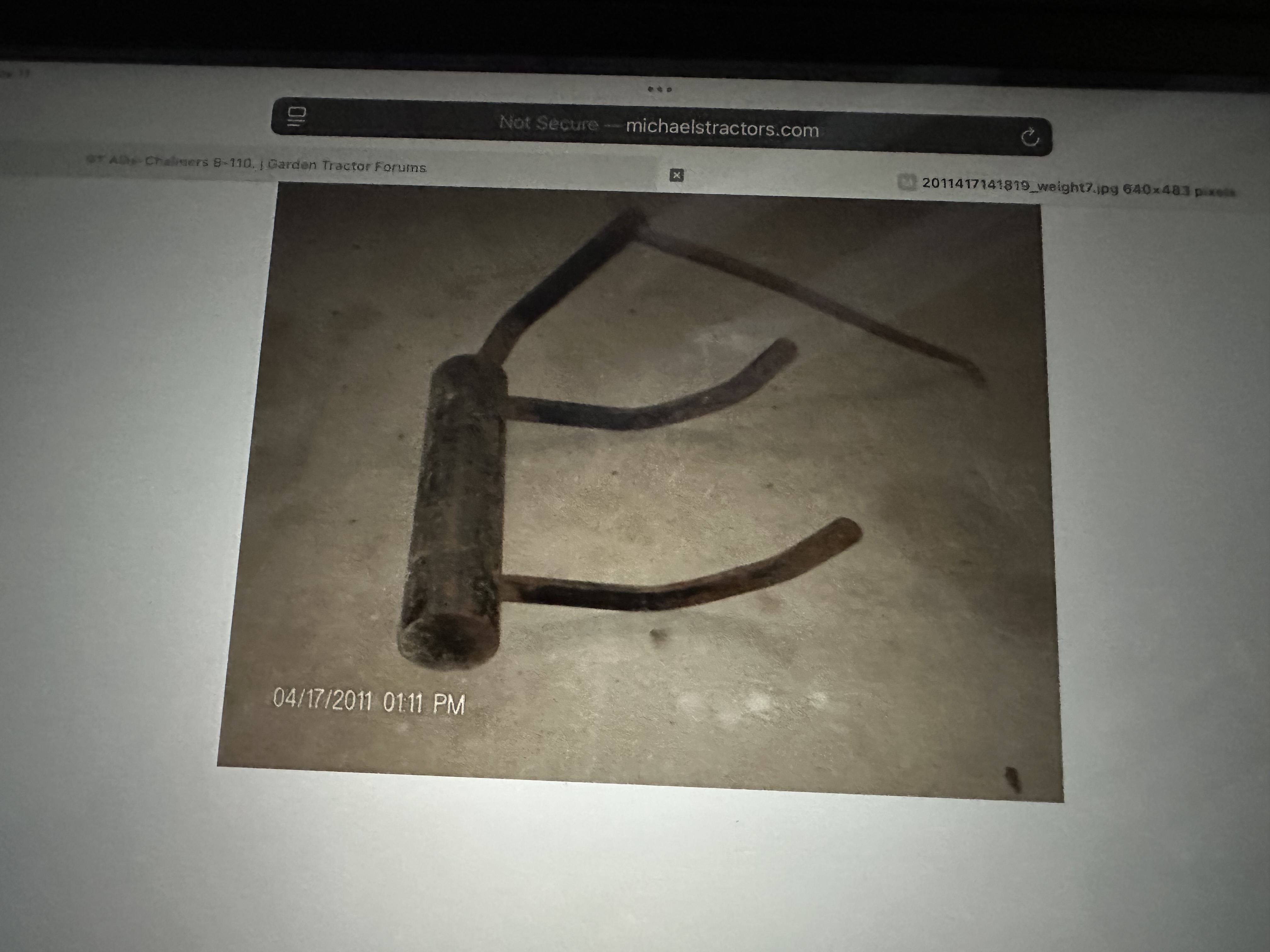

I believe the B110 front counter weight would weigh about 25 lbs.
Model # 2011417141819 It looks to be a solid round 4” by 12”  with a couple flat steel mounting arms on it.
I found this photo on line, but have not seen it in person.
I do have one for my Agco-Allis 1614H that is similar in size but different mounting brackets. Model # 1691837.

I got a chance to look at my front counterweights. Measures 3-3/8" diameter, by 15" long. That would put it about 40 pounds with the attaching brackets.

using Ken’s measurements, I agree that the front counter weight calculates to be very close to 40 lbs including the mounting bracket’s! Dewayne
