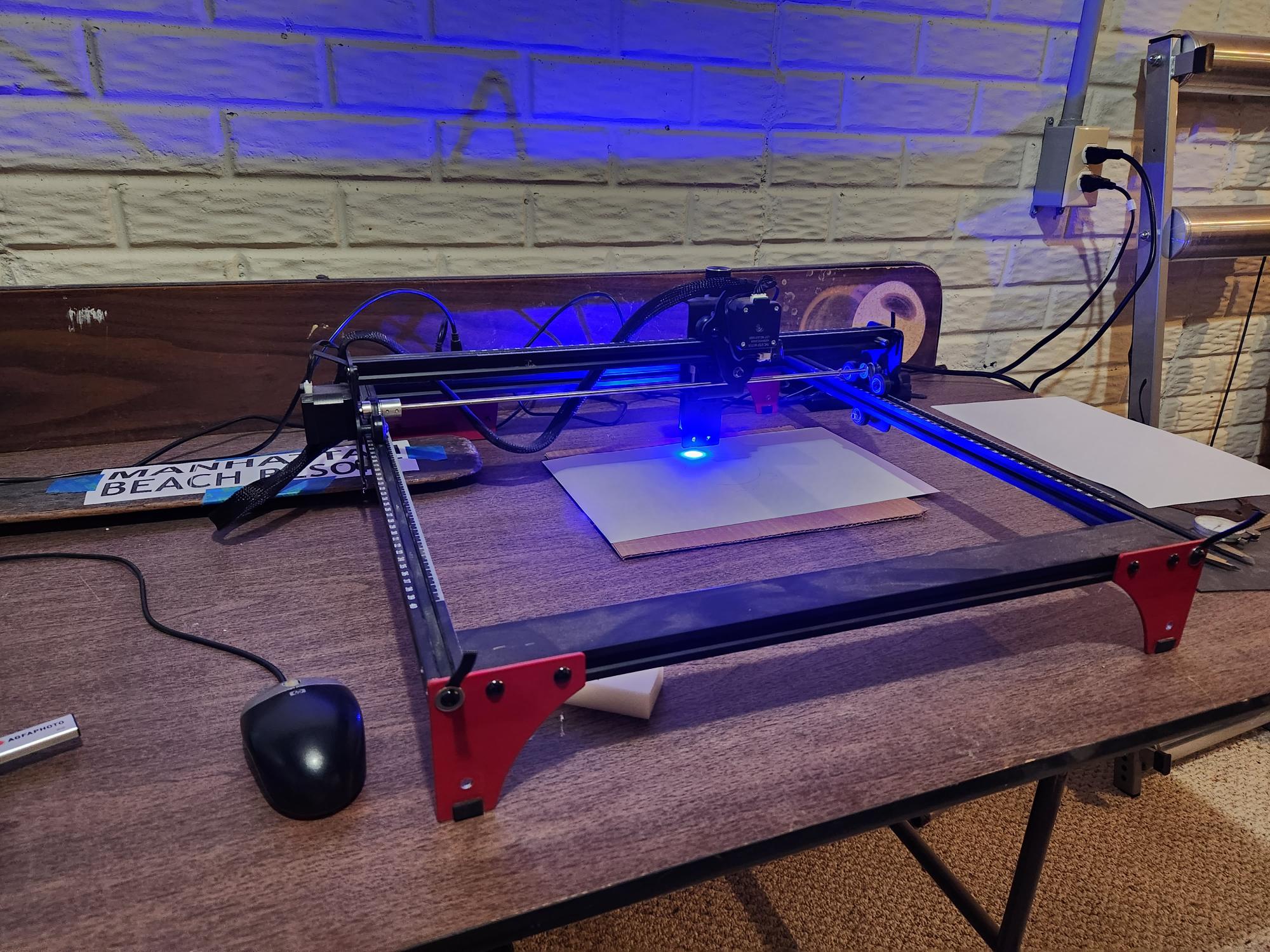

So, I was passing through someplace on my way home from another place, and saw a $100 CNC laser table on Craigslist.  Bought it, brought it home, hooked it up, and threw some software on a laptop...
Plugged my scanner into the laptop, and taped the remains of a gasket to a piece of white paper...
Scanned it...
Imported that picture into the laser software...
Traced it...

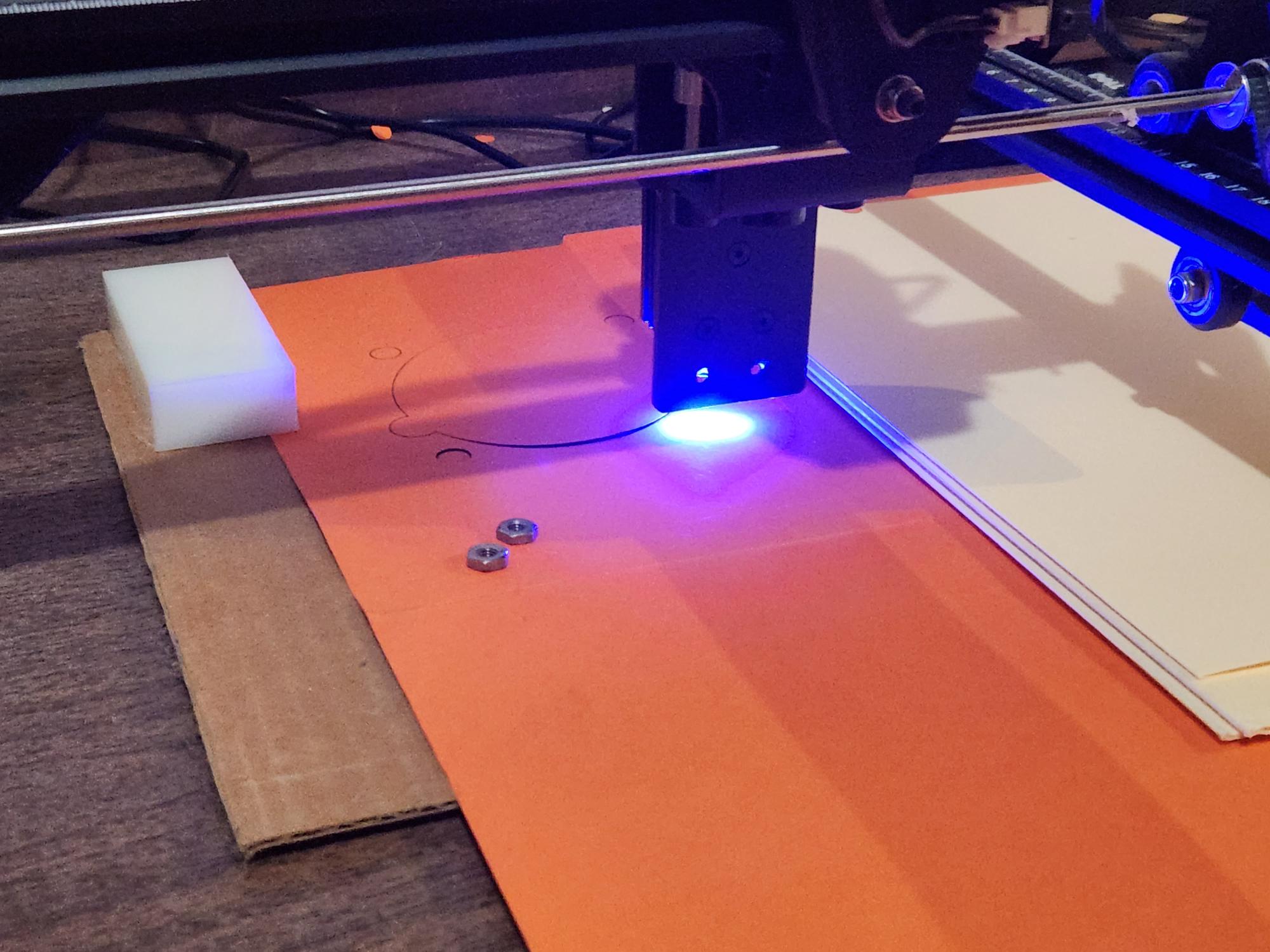

Placed a piece of card stock (an old file folder) under the table, and sent the trace to the laser...
It cut it into a perfect replacement gasket, prettier than I could ever do with scissors, hammer, and stamps.
Next up, is the pesky magneto cap gaskets that I'm always breaking!!!Wink

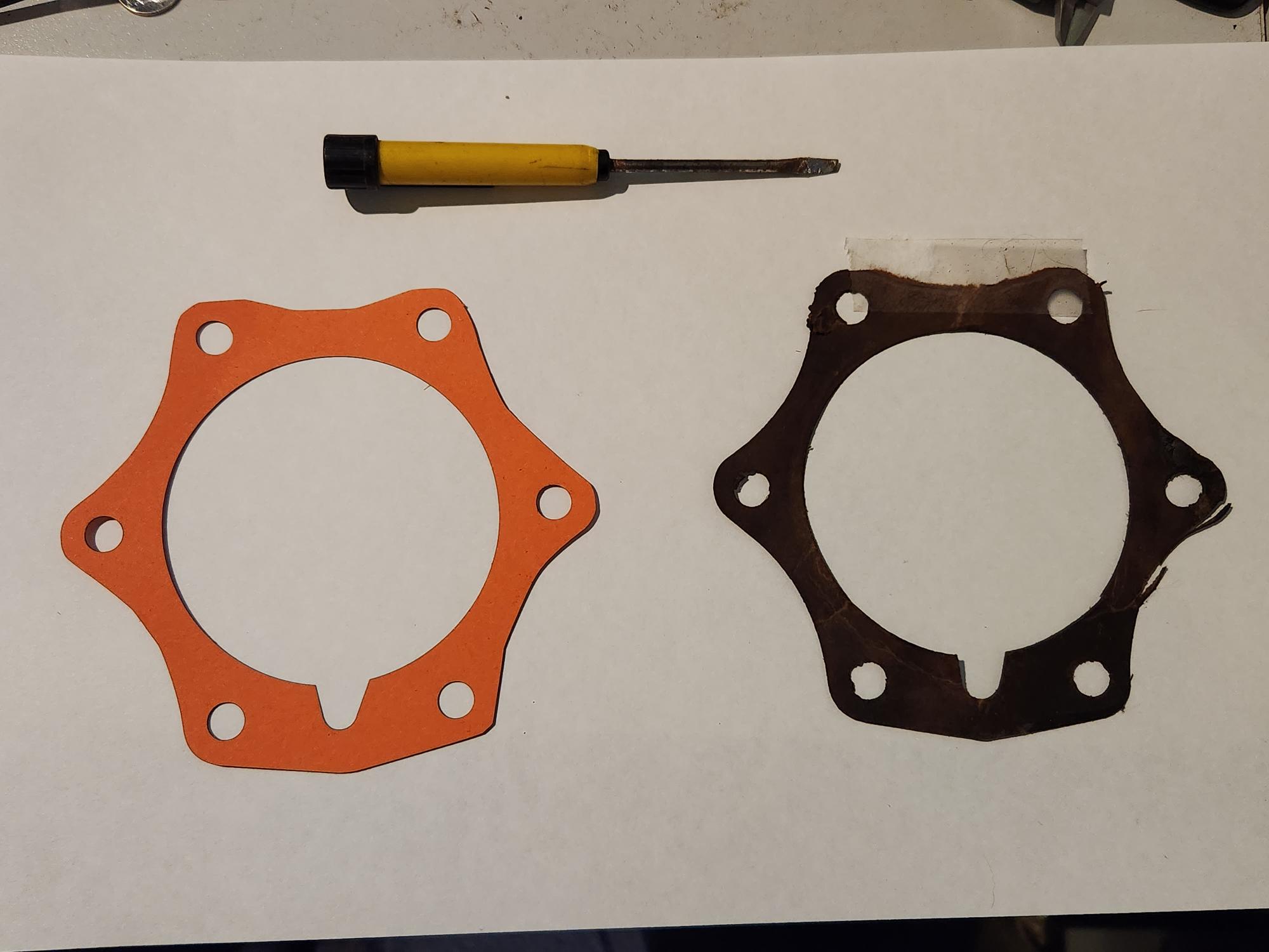

Original on the left, new one (made from old file folder) on the right.  little flatblade screwdriver at the bottom for general size reference.
It'll cut up to 15" square.
Side biz?  Doubt it... but hey, I justify it like all the other tools in my shop-  when it's Sunday, and I NEED a part, I MAKE it...
What I'll do, is... for every gasket I come across, I'll flatbed scan and scale it, and if I need one, I'll cut it, and keep the file on my server for the future.  If I need another, or if someone needs one, I'll cut another... or three.  It's not a big deal.
LightBurn is the program I'm using for control.  The machine's laser head is about a 7w input, and it yields about 2w of beam power.  I'll replace it with an 80w in /15w beam eventually, so that I can work much heavier material.  In the meantime, I need to make a ventilation hood  to get smoke out...

Yep.  I'm gonna put the carb flange, carb bowl, magneto cap, magneto flange... all on the list... and more.
Tonight's test, is some really thick common gasket material.  I have the speed dialed way down (100mm/min) and power at full snot, making 14 passes to see if it'll cut this PTO cover in thick material.  There's two real 'gotchas' with doing thicker... first is plain-and-simple beam power, the other is focal point.  The LED laser beam isn't a perfect collumnar beam, it actually has a focus point... which means, it  may cut paper like mad, but only if it's at the exact focus... if the paper isn't sitting totally flat, then some parts will cut, other parts will not.  Same goes for engraving...
But for THICK material, what this means, is that I may get a really nice cut at the top surface, but the next passes become increasingly weaker on account that the focal point was at the SURFACE, but the kerf is now deeper.  The answer here, is to adjust the focus down  a smidgen to move that convergiant (hot spot) down into the bottom of the kerf to eat some more material.
The fact that the beam has a slight taper, means that when I adjust the head down a smidgen to get to the bottom of the kerf, the SIDES of the cut area little too narrow to allow the beam's full girth to make it through the convergence and hit the center... instead, the beam's girth is shadowed by the sides of the kerf, leaving just a portion of the beam to focus on the bottom.
And a higher power laser makes this moot... LOL
