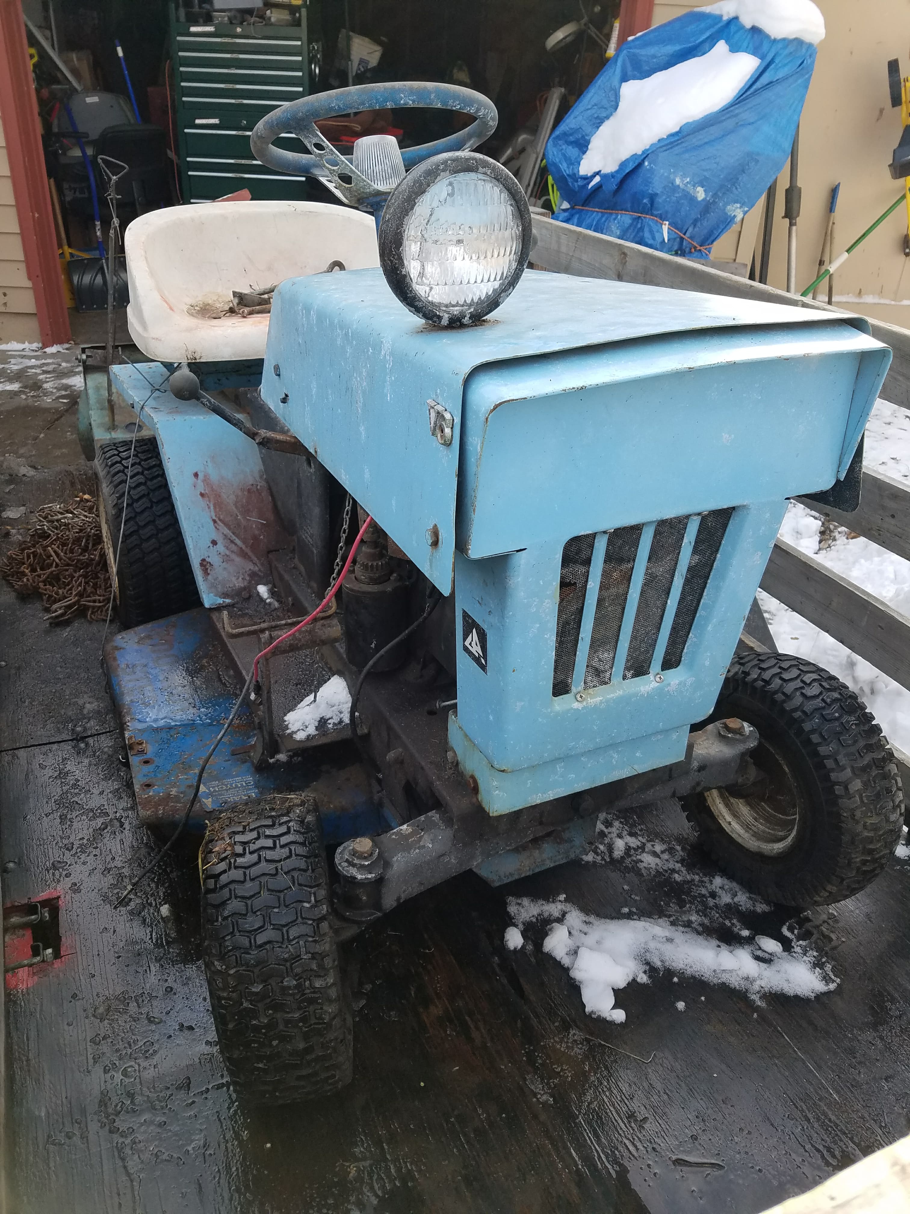

Hi, I bought a rider mower to day. I'm looking to get some help. Any one know what year this might be? Or any info on them. The one I got it's painted blue with a white plastic seat. So I think some one just got a lil happy with the blue paint and I don't know what's the deal with the seat.

Its not an Allis. Looks like an Arctic Cat Lawn Lion. The same company that makes the 4 wheelers used to offer a series of lawn and garden tractors. Those are somewhat collectible.

Thanks for the info. I never knew that or even heard of that model. I just bought it cuz I liked the look of it. Now in just trying to get it running. The guy before me did some work to it. But I can't keep it running unless I keep spraying starter fluid in it.

Probably needs the fuel system gone through. Most of the time on a "new to me" tractor I will have to remove the tank and clean it, install new fuel lines and a filter. Sometimes the carb has to be cleaned too.
