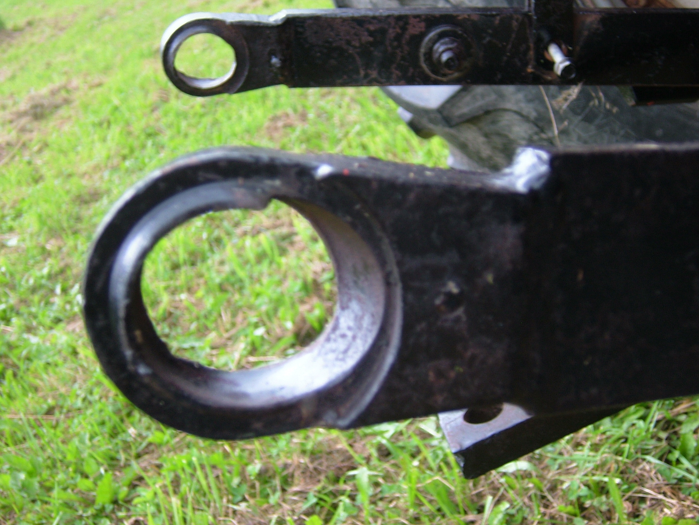

As for the lift arm balls, they're missing. Along with the retainers. Suggestions? Thank you!

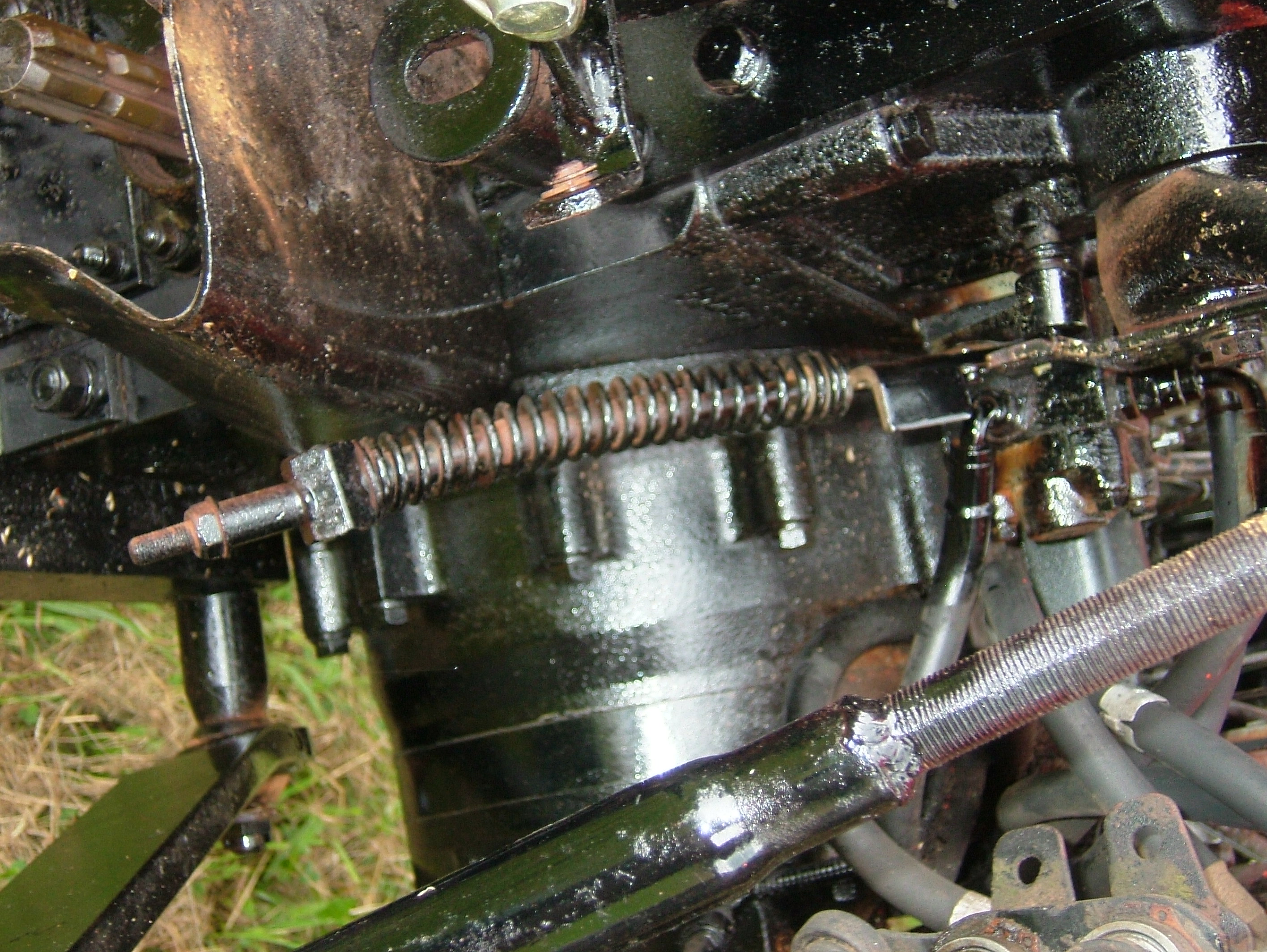

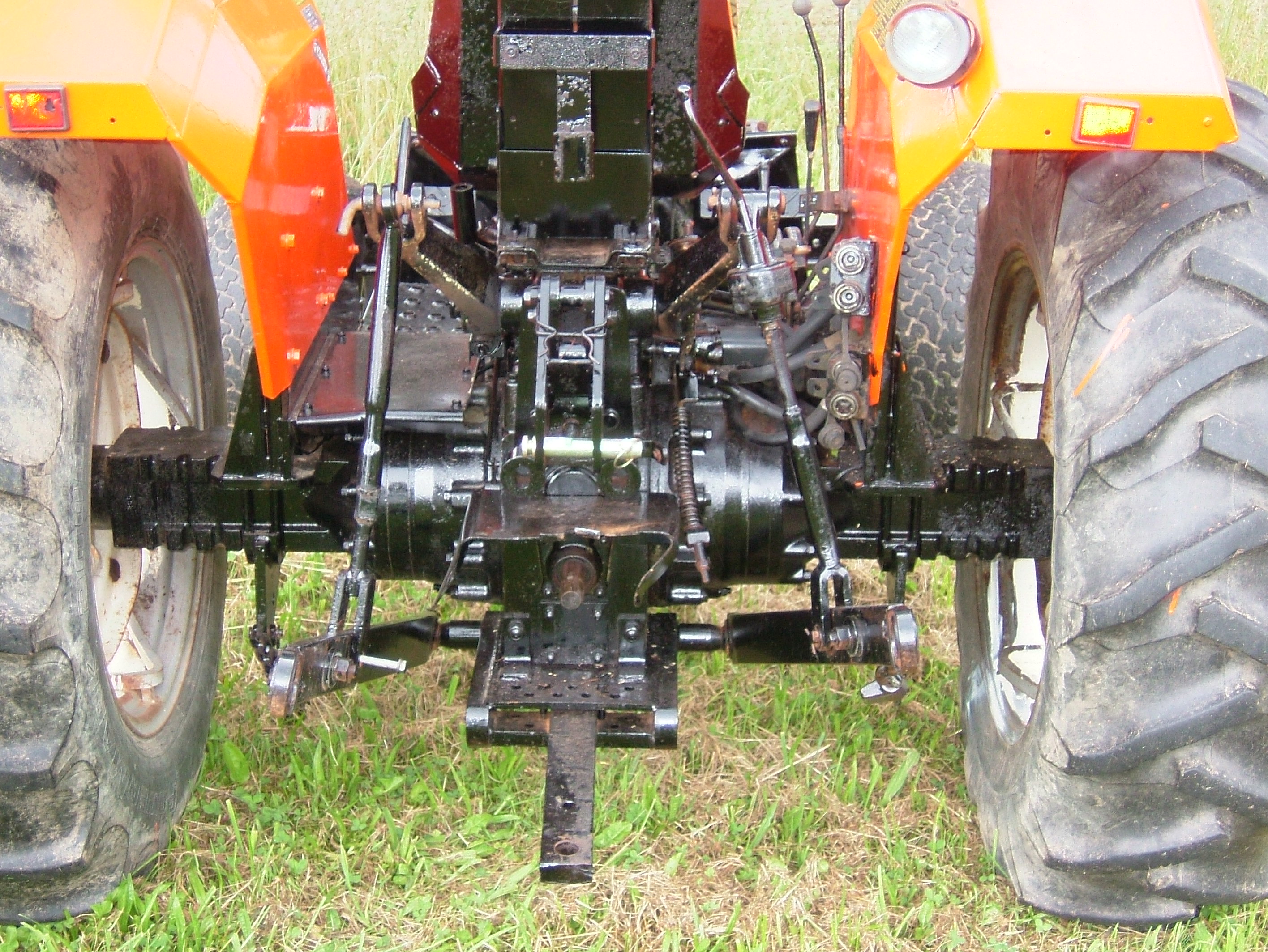

3. The biggie, maybe: The Draft Control Rod Assembly/Overtravel Spring... I can take pics, but - in a nutshell, the end that connects to the tab attached to the 3-point hitch toplink attachment (assembly?) is broken off, and the other end that goes into the lift arm tower is just loose, the rod that goes into the housing can slide a little in and out. I'm not sure how to describe it other than that. maybe photos will clear it up. I'm not sure how big a deal it is to lose draft control...???
4. Missing hitch balls... it was supposed to come with two sets, one for Cat I and one for Cat II to interchange, but of course they're long gone along with the original hood. I can't find anything online anywhere for replacements. I'm thinking I'll have to get either weld-on's or weld-on repair ends. Any thoughts on a better way?

Tim, take a look at similar HP kubotas, they have a similar draft linkage, as you describe.  You might be able to bodge something up out of one of them.  As to the PTo Linkage, search vernier control cables, I used one I got from Granger's for a throttle cable to replace a bogus linkage that my grey market Kubota had and failed.  Cost me all of about $11.

For Ross:
You can see the broken draft control rod below the right lift shaft and on the right of side of the lift shaft housing:
What I meant about the lift arm balls/sockets:

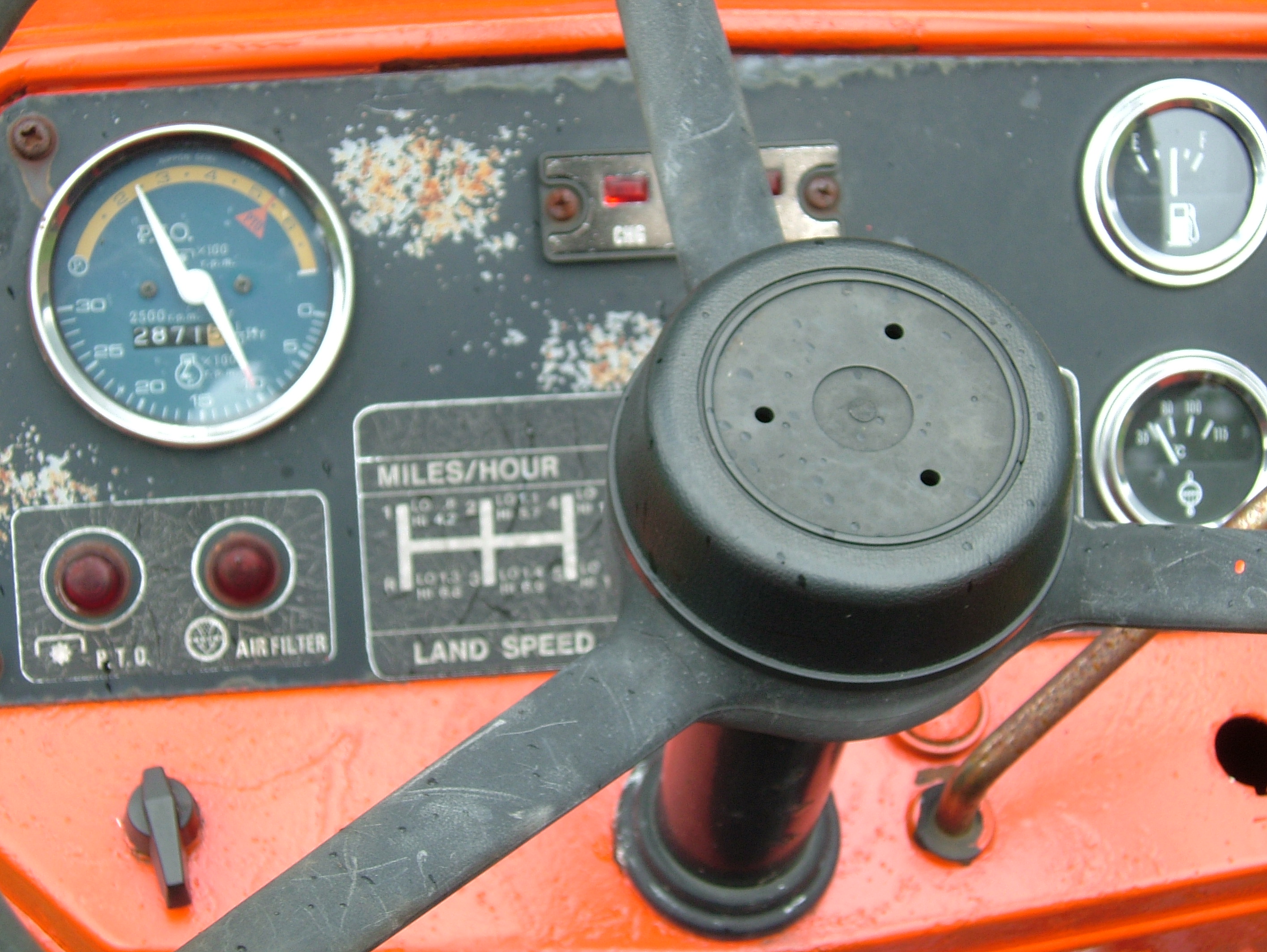

The hour meter does work:

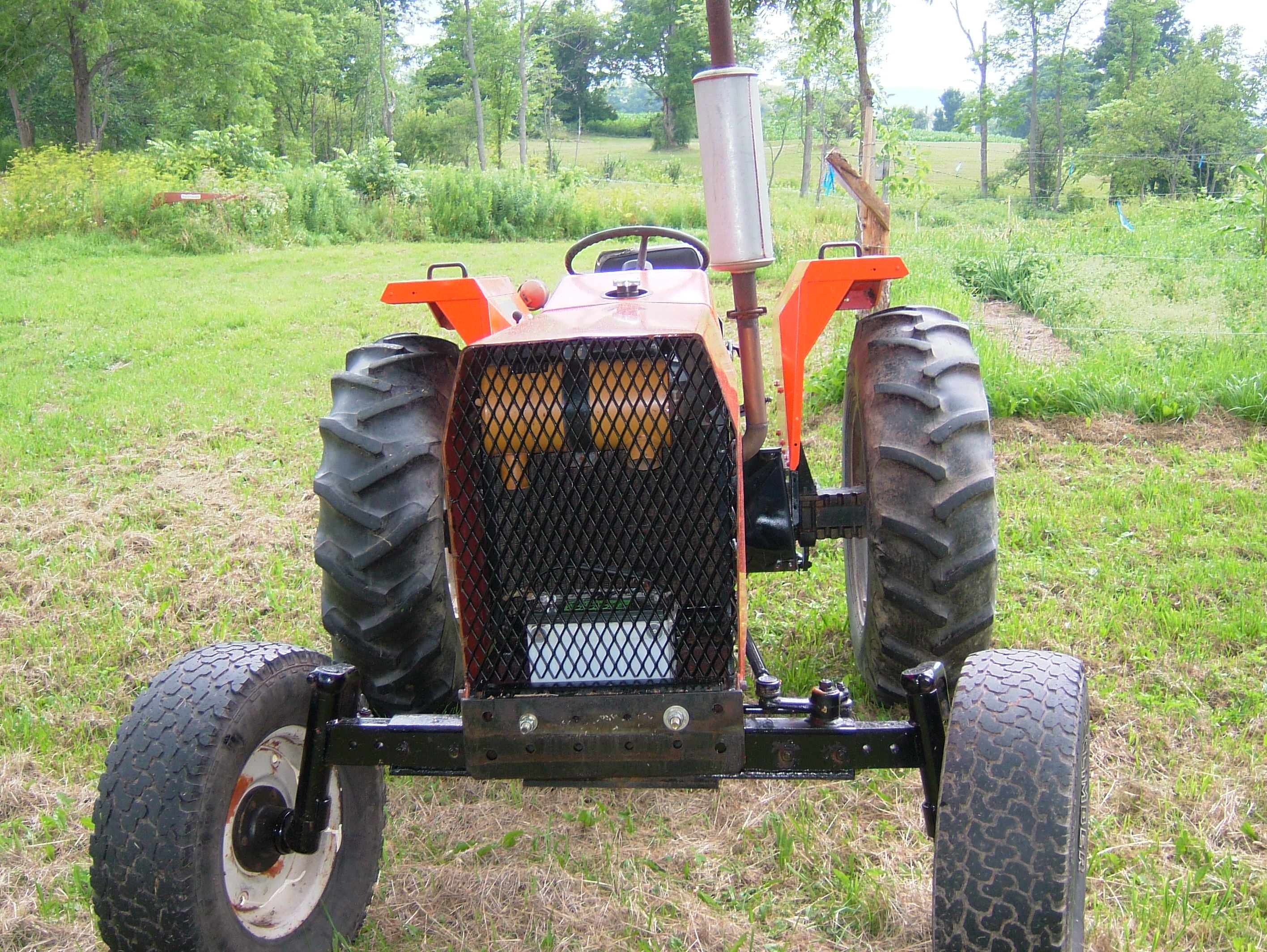

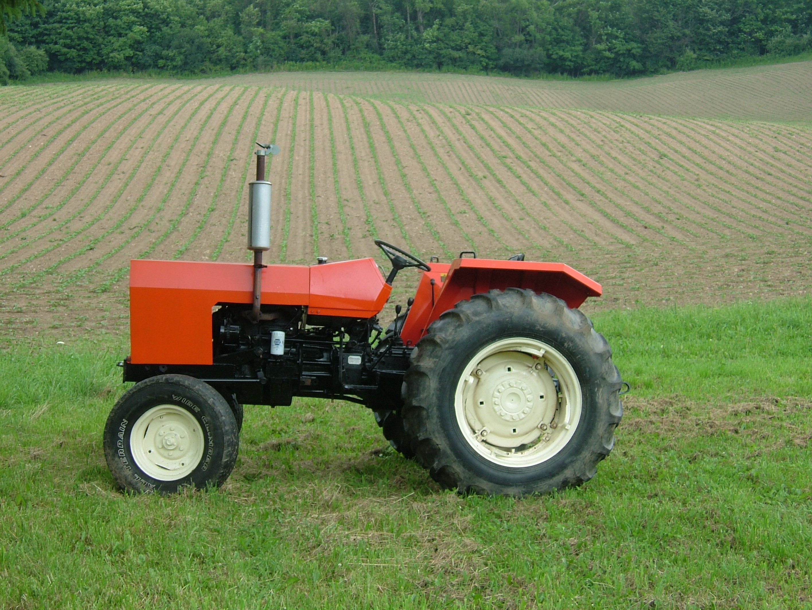

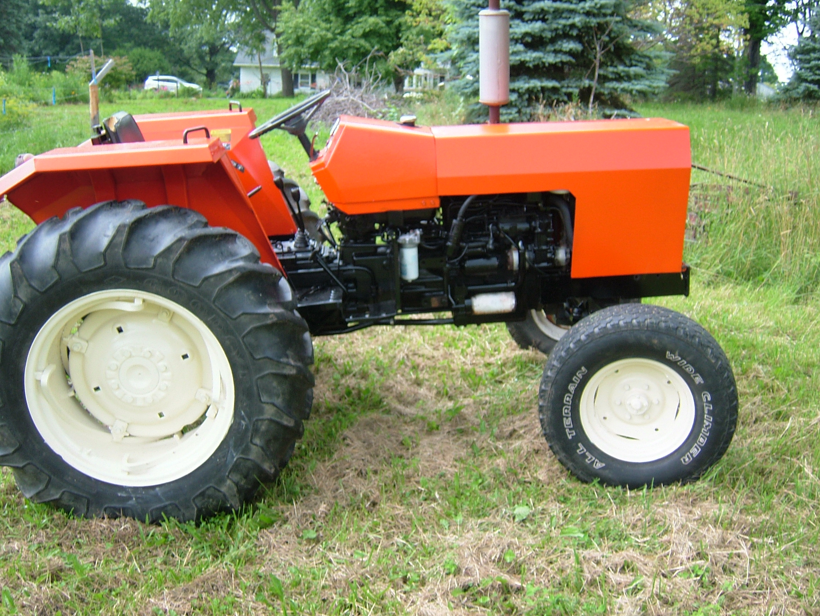

GEEEZ LOUISE!!! Why are the pics so huge?!?!?! SORRY!!!
And yes, the tires are truck tires and have to be replaced, lol; the hood is, as I said, NOT original (homemade by the seller but not too bad, it swings open now that I took the plow frame off), and the muffler is not "right." Probably more modifications/additions/deletions that I'll find along the way, too. But it's a good machine for what I need.
And those are a crop of green beans for the late season here. It's hard to tell perspective but that front field is only a little more than 7-acres.

And yes, he painted it up... I really don't like when that's done, my opinion is that it's usually done to hide something. Kind of like putting lipstick on a pig. But meh, that'll do, pig...

Today I found a dealer about 30 miles from me that carries Allis Chalmers parts. Unfortunately, the hitch balls for this model are obsolete (no, really?!?!), no longer available, and no match to any other model. So, I'll be getting some weld-on lift arm ends and get that done asap.

My uncle has a 4000 ford and if i remember right the hitch balls he takes out when not in use and puts them in tool box. you might be able to look into something like that

Right you are, mtanut, that's what I was trying to do but those are no longer available with this model. The replacement ends are cheap enough, and I have a machine shop that has already said they'd cut the old ends off and weld the new ones in for -- FREE! I like that.
