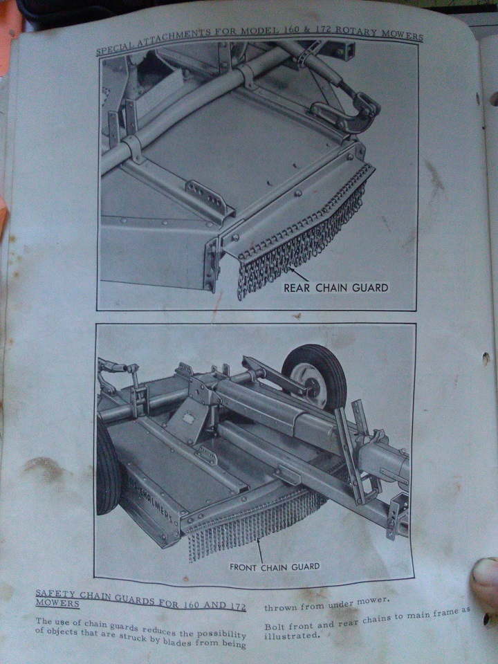

Dave...If your good at the search thing, there was a discussion a long while back about that subject....I think I posted some manual info if that would give you a start....Dale
 ***  I looked back and see the pic date was Dec 20, 2018..  I think the consenus was, everyone on his own....This is one of the pic posted...I think !!!!

Dave, I posted a source along with photo of these shields under your mower post.

I would fab it with a welder,torch,angle iron and flat metal. Weld links to bottom side. Can't imagine anyone ever pulling the rod and removing then replacing chains. My Woods doesn't throw enough out  to make it worth while...yours might?
Oldoug View Drop Down
Points: 1160
Post Options Post Options   Thanks (0) Thanks(0)   Quote Oldoug Quote  Post ReplyReply Direct Link To This Post Posted: 02 Sep 2020 at 2:20pm
I made my own years ago also...measured pictures in my operators book and scaled them to the mower...bought a blank piece of metal and measured it out for my blacksmith...he notched the chain holes and bent the angle...I made the rod and cut the chain links and drilled my own mounting holes after lining it up on the mower.

On my 172 mower I installed a old AC baler belt, no more sticks,grass or any thing hitting me now.

Guys, thanks for the replies.I ended up having these made by Schmidt Machine Company in Upper Sandusky Ohio and they did a wonderful job on them.
