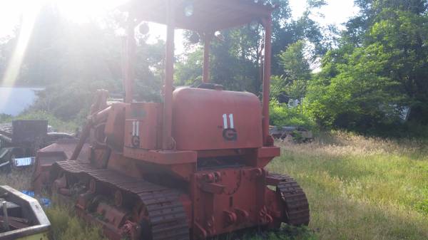

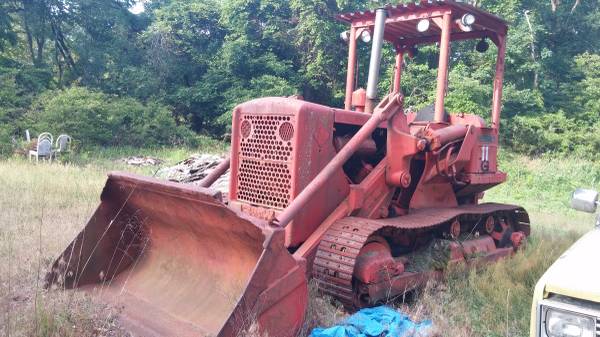

I don't think my attempt at posting pictures is going to work. I only have the 2 pictures posted on the internet ad. That's all I know about the track condition. But, if you could see the right hand track in the pic, parts of the track plates are missing.

The amount of work I want to do is very limited. Push over some large trees, about 10 to 14 inches at the base (they need to be pushed because cutting them will only fall in the wrong direction),1/4 mile road clearing (hard clay soil). Probably could get it all done in about 3 full days. The HD11 pictured isn't quite what I want because it has a bucket but, I might could resell or trade it for one with a blade.

Oh! Wait! that's an optical illusion. The track plate is there, it's some kind of strut or brace sticking out of the back of the machine. The treads might be o.k.

Ok that posts when it's not supposed to. Looks like it might be a good specimen. It did have a ripper at one time. You could probably do way more work than you could need with that tractor (but still can't see the tracks and undercarrige)

Only other picture I have so far. Looks to me like the tracks were painted along with the rest of the machine, a long time ago.

looks pretty original, be well worth saving

what engine does it have in it, the exhaust pipe is on the wrong side, looks like a GM

According to the seller: 8.5L  6 cyl. diesel

Yes, I think donoman is on to something. It looks like it could be a Detroit 471 judging from what appears to be the muffler. That would have been what was in the HD9G. In the early Buda engine days if they burped, some people went back to the Detroits(they fit back in pretty easily) and that's still not a problem for you, there easy to work on and parts are still easy to come by.

The craigslist ad says it is in good condition. $3,500 is a reasonable price to pay even if the undercarriage is bad. Look at the machine and see for yourself how it starts, runs and turns. Run the bucket down to raise the track off the ground. Check the truck wheels for wear. If the chain links are worn on the sides near the pins then the trucks are worn too deep or the rail height is low. You can tell a lot from the position of the front idler on the slide bar. If the idler is in the middle of the travel the track is 50% worn. The sag in the track can be removed by adjusting the idler forward. I hope you were not thinking the track is shot because of the sag in the track.
A track loader has 2 advantages over a dozer for removing trees. You can dig and remove dirt. You can push higher on the tree.

It should have a HD516 It dates from after the time when Allis Chalmers purchased Buda. I think the HD10 had a Detroit.
