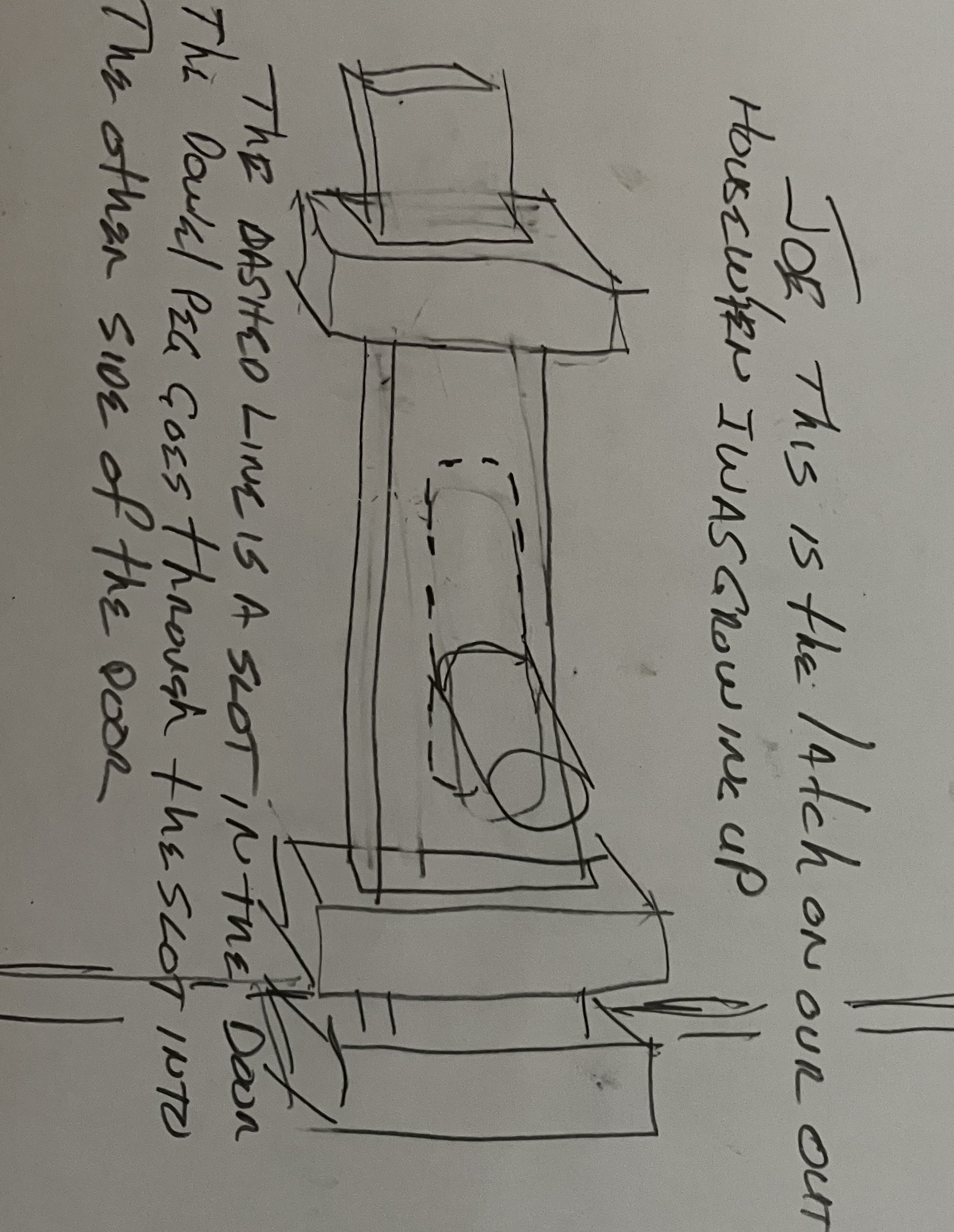

Joe,
something like this?
Pretty simple
sorry about the sizing.

Post Options Post Options   Thanks (0) Thanks(0)   Quote LouSWPA Quote  Post ReplyReply Direct Link To This Post Posted: 27 Aug 2025 at 3:57pm
Basically, a sliding bar with a dowel through it. there is a slot cut in the door and the dowel (handle) is able to slide the bar from inside or outside.  That is what was on our outhouse when I was growing up
