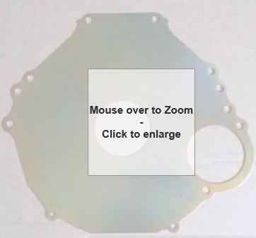

 Hey JC,,the guy I'm doin the work for told me that this engine is susspossed to bolt up to the Hyster bellhousing,,,,? I was just wanting to get a "something" to mount a starter so I can do whats needed to get this engine running.,,,but you got a dang good idea in that I should go take a real close look and get good measurements on the fork lift assembly first.
 Hey Chask,,good to see you back,,Pardner ,,,hopin your ailmants are gettin under control,,,,ClapClap Yeah,Chask,, I had seen that bell housing on ebay but don't think it would fit as the two upper bolt holes appear to be way too close together than this engine,,,
 You know,,Steve,,I called the dude today and suggested maybe it be cheeper to just take the Hyster engine out and throw a cheep overhaul kit at the Hyster engine and KNOW everything would fit. THing is,,he was told this Ford was in good running shape (when parked) and he already paid for this engine,,,bout 5 months ago,,,,???

Joe you can start that motor with just that flat plate. I’ve started many that way. Go to the parts store and see what all 2 bolt starters will bolt up the same. You may then find one easier.
I’m using the 300-6 starter on my 351 w.
  Yeah,,Thad,,that's what I'd really like to do to keep the costs down. I really doubt whatever bell housing I get to match this block is gonna bolt up to the Hyster transmission. I'm gonna go to the parts store this Am see if they have a plate that will bolt to the engine just for mounting the starter,,,,maybe I can float a loan from ole Shameless to buy it,,,,,Wink
